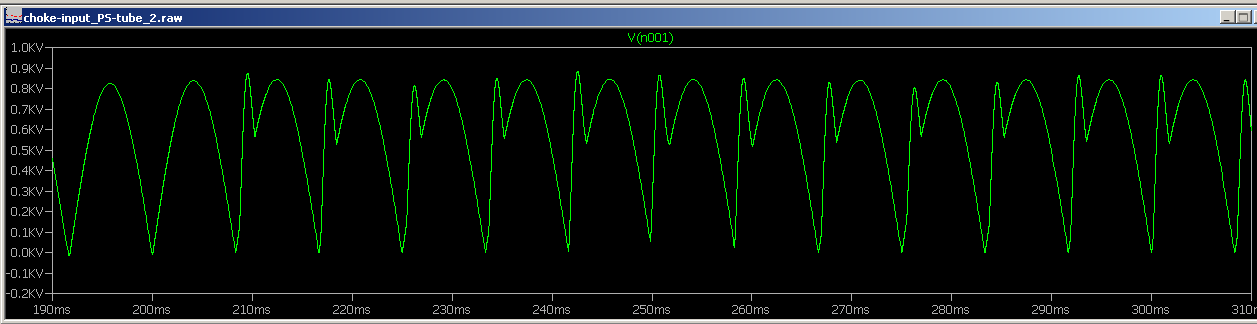

The variable we don't know is the parallel capacitance across the choke. This capacitance actually damps ringing. If the choke has a very low parallel C, it can ring at high frequency when the load current is below critical. A snubber of, say, 10nf in series with a 20k 5 watt resistor, would keep any transient peaks at bay. A revised schematic is in the first image. The second image shows the transient. In this particular waveform I reduced the parallel C of L1 to nil, and dropped the external load to nil as well. The parasitic spikes were 1.3+KV and several KHz without the snubber. As you can see, with the snubber the transient is a much lower frequency and effectively limited to the peak AC voltage. The cost is a few cents worth of parts and about 1.5 watts of heat in the resistor. As you say, cheap protection 😉

This greatly depends on where the circuit opens. If the connection between the choke and filter cap opens, then a very high voltage ringing waveform will be generated (were talking 10KV). Likewise, if the connection between the choke and rectifiers is broken OR center tap and ground is broken, you will get the very high voltage ringing. The former would require a broken connection between the choke and caps. The latter would mean a broken connection, simultaneous opening of both rectifiers, or a fuse in the center tap (which is a VERY BAD IDEA, for several reasons). A snubber on the input side of the choke will damp the HV oscillations, limiting them to about 1KV or so.

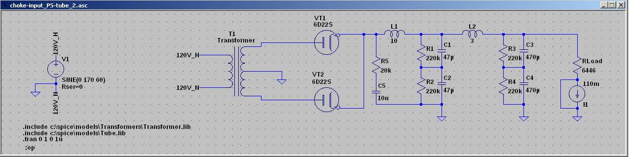

Thanks for taking the time to draw that schematic! What wattage are the sharing resistors across the caps? Can I safely use 500V caps in this supply? Would a thermistor slow the voltage spikes at startup if placed on the primary of the big power transformer?
Thanks again!
Blair
I will spare you the math and give you the answer: 2 watts minimum. That provides a very comfortable safety margin. The resistors also need to withstand the highest possible voltage (425V in this case).
If you run two in series, then yes. Otherwise, no. The total voltage rating needs to be 850V minimum, but if I am running 2 in series I would go with 1kv total for a safety margin.

Voltage spikes are only a real problem during certain fault conditions. Run the snubber I showed in the schematic and you will be fine.
