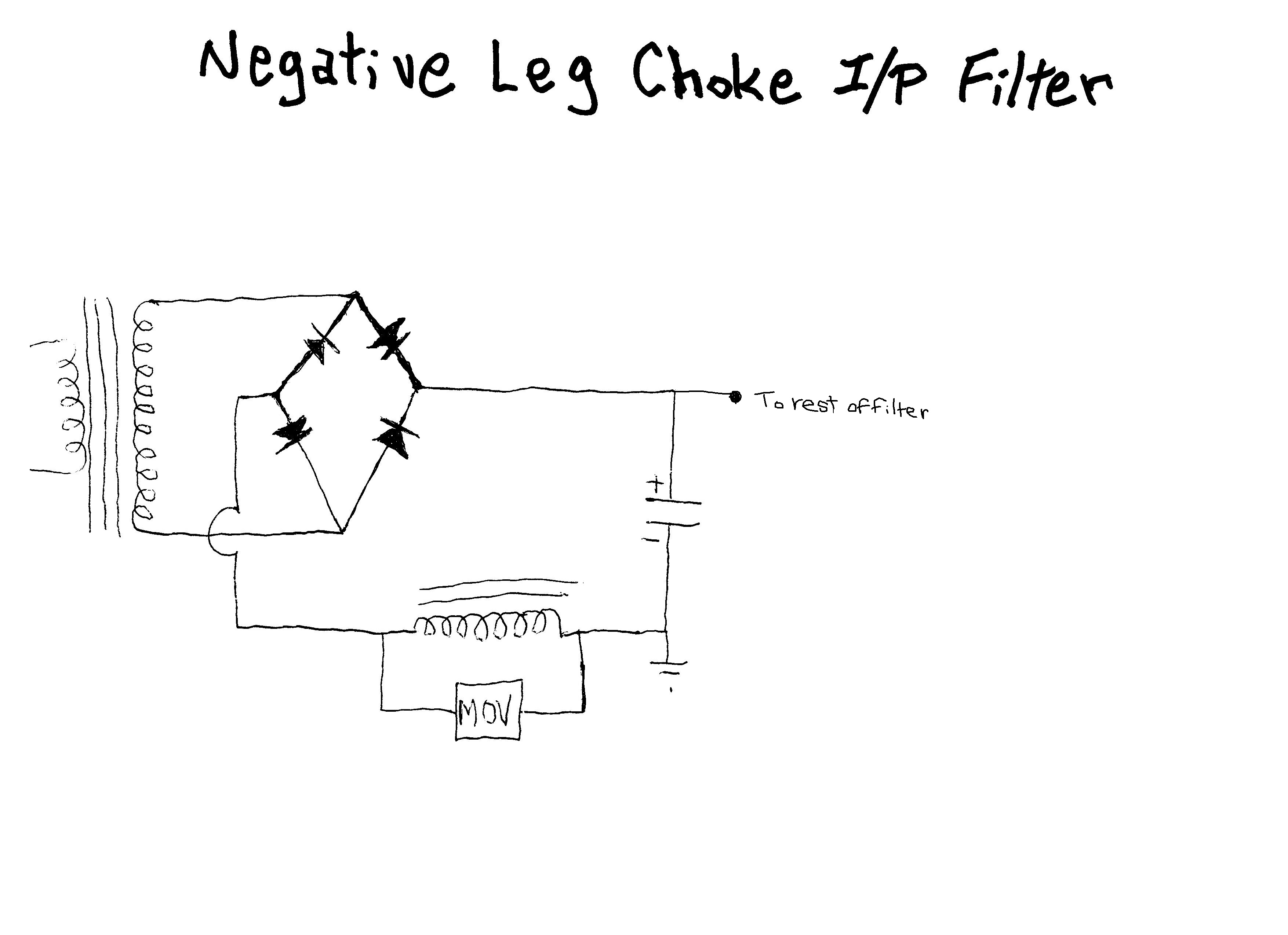

I had occasion to upload the attached "hen scratch" graphic over on AA. It seems that it is useful here too. Measures have to be taken when choke I/P filters are combined with SS diodes, to avoid destruction by inductive kick back spikes.

Not sure what happened to my post, but here is a preliminary drawing.
DCR of power transformer secondary is 61ohms/side
L1 is 55ohms
L2 is 23ohms
This PS is based on my interpretation of this thread. It may be all wrong🙂

The flyback diode across L1 will stop the supply from behaving as a choke input PSU.
Given that both sides of the choke have capacitors to ground there is no need for flyback suppression. If you are worried put a diode from L1 left side to ground.
