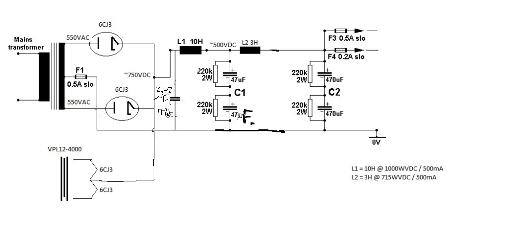

Both damper cathodes and both damper heaters should be at the same potential. Then, no issue of heater to cathode potential limit can surface.
Protection against inductive kick back spikes is needed, when SS diodes are mixed with choke I/P filtration. I don't see "sand" in this B+ PSU.
The voltage equalizing resistors shown will slowly bleed the filter caps. down.
If the B+ supply is charged up, so is the bias supply. Negative voltage on the O/P tubes' control grids provides electrostatic protection against cathode stripping. 😉
Speaking of the bias supply, mention was made of having both a "free" 5 VAC winding and a free 6.3 VAC winding. Phase those windings up and wire them in series. Fewer stages of voltage multiplication will be needed, to obtain a satisfactory bias supply.
If a "fudge factor" cap. proves necessary, make sure you use a part rated for several thousand WVDC. The 0.47 μF. limit for the "fudge factor" part is to ensure that a cap. I/P filtered regime is not entered.

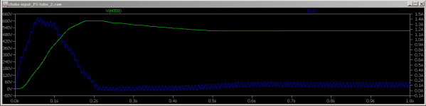

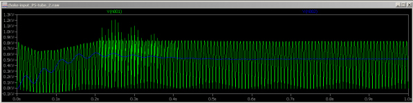

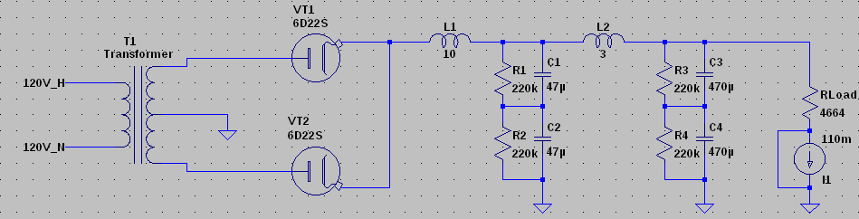

I re-ran the sim with your current schematic but without the bleeders or the small input cap (both of which are unnecessary). I had to guesstimate transformer primary DCR, which makes a big difference (I used 5 ohms), and just for grins I added parasitic capacitances to the chokes. Rectifiers are 6D22S, since I don't have a model for the 6CJ3. They are very similar tubes, so the voltage will be accurate within a couple volts.
With this configuration you are looking at 503V at idle (110mA) with almost zero ripple. At 350mA load the output voltage drops to 427V. Regulation is 18%. The loss of regulation over my earlier sims is due to the DCR of the trans primary and the DCR of the second choke. If you measure the DCR of the trans primary I can get even better accuracy.
One area of concern is choke saturation on startup due to the large final cap size. With the choke parameters I have entered, the rectifiers must endure a peak current of 1.2A about 60ms after startup, with current over 1A lasting for several cycles before tapering off to idle current after about 250ms. If the chokes saturate the current will be much higher, potentially limited only by the DCR of the trans and chokes. This is something to look at once the supply is built. Damper diodes do not have a hot switching transient current rating on their data sheets like tubes designed for power rectifier service. They do have a "peak" current rating (2100mA in the case of the 6CJ3), which is called out as a "steady state peak current". This combined with the rugged cathode means the damper diode should handle a couple amps for 200ms. The only caveat is to make sure the cathode is hot before switching on the plate current. A lot of folks suggest using the slow warm up of dampers as a slow-start feature. This is really bad practice. Yes, they are tough, but they're not indestructable. If you want a slow start, use a step-start arrangement.
Oh, and on the subject of the bleeders. If you don't need 'em, don't use 'em. They are a waste of power (although they can improve regulation). If you are concerned about over-voltage, use an OVP circuit.

I agree. With the exception of "if" in regard to concern. I can think of two circumstances where the voltage will soar to over 1kv without over voltage protection under common use and I don't even have any rigorous electrical training. Just a lot of hands on one-on-one bench experience as I was growing up.
Eli mentions the use of bleeders in choke input filtration as an important one.
Over-voltage protection of some kind with choke input power supplies is important. Bleeders are easy so that is why I suggest them.
I think keeping voltage where it is expected and in the amount it is expected is the only concern. Once that is taken care of, everything else can proceed and we can enjoy arguments of what is hifi etc etc.
I'm sure there is some over-voltage protection in the works and I'm just jumping the gun here. I can't imagine anyone here would recommend there would be none. -Fred
Having the voltage "soar to over 1kv" would require a series of extremely unlikely events. Under normal conditions, loss of load on the filter would have the voltage reach 850V across the filter caps. If each cap is rated for 450V, there is no issue. The supply is essentially "passively safe". There is also the rest of the amp circuitry to consider. A 20mA draw from a series divider, for example, will hold the voltage down to 620V. There would be no need to burn another 20 watts in a completely unnecessary bleeder. That is why I said "if"

I can get 22, 56, 68, 120, & 220uF 500V caps to series for 1KV working voltage. I know using a fairly small(er) cap as the first cap after the choke is best. So, maybe 2X 56uF for 23uF @ 1KV there, but what is the best size for after L2?

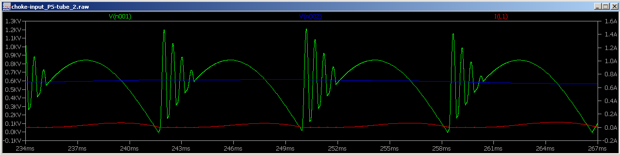

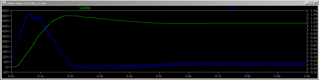

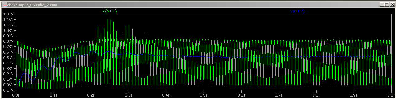

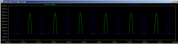

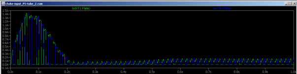

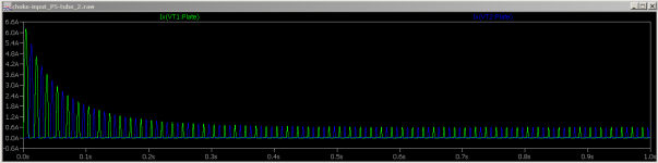

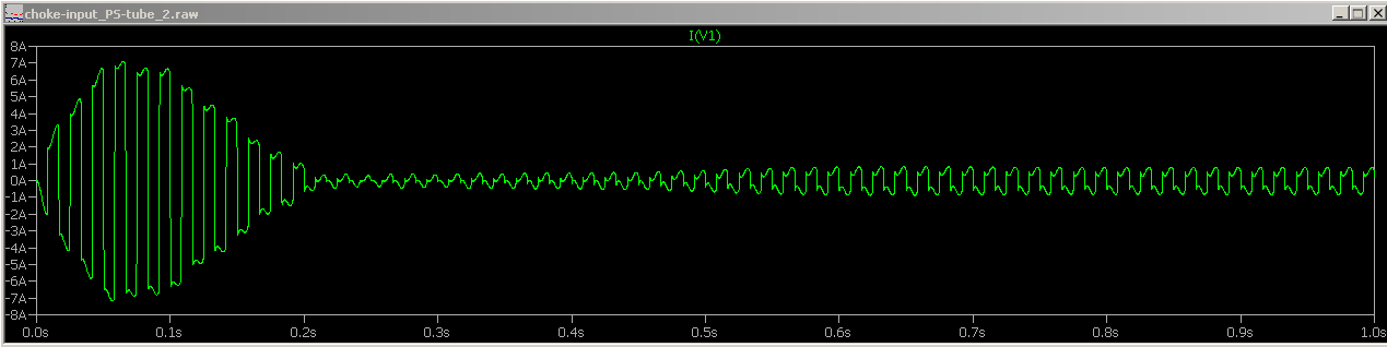

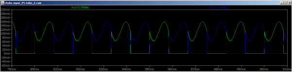

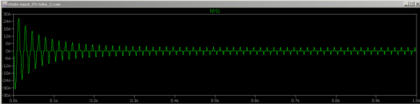

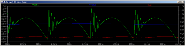

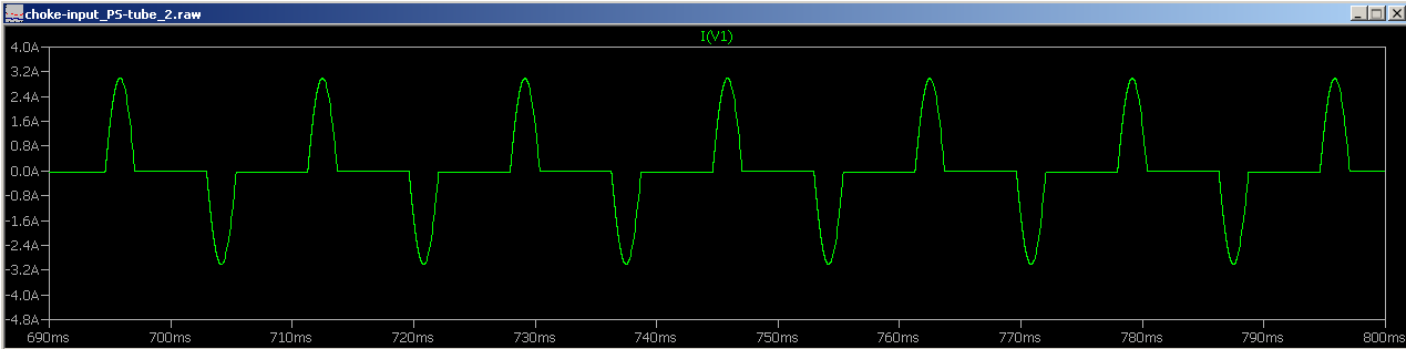

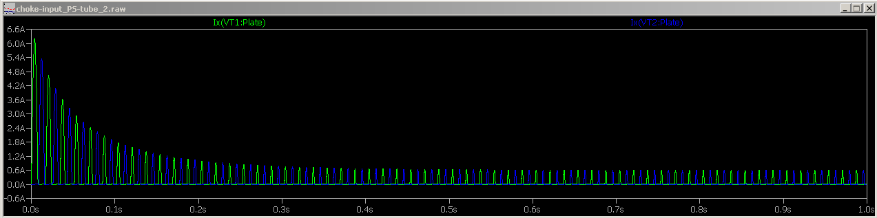

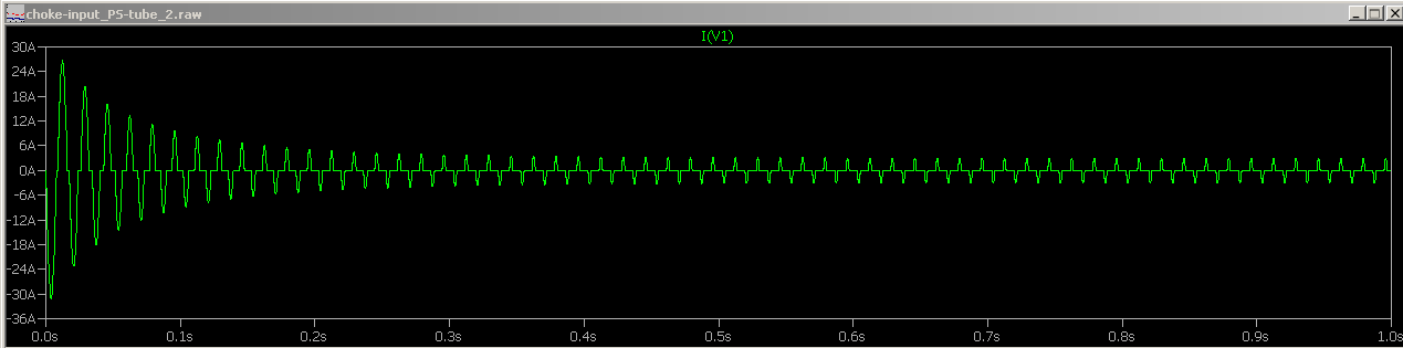

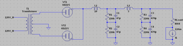

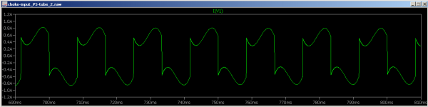

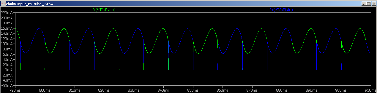

Just for more grins, I figured I would post some pretty pics.
The last image is the schematic I am simulating. When initially finding the steady state output voltage I short the load resistor and set the current source for the draw I want to simulate (110mA in this case). Once the voltage is found, I use Ohms law to calculate the load resistance, plug that value into RLoad, and short the current source. Then I re-run the simulation. Using a resistive load rather than a current source allows more accurate simulation of startup conditions.
The transformer and chokes all have the series DCR plugged in. The chokes also have parallel capacitance added. The 6D22S's are fairly accurate with respect to load behavior and capacitances, but not saturation. Since the currents are well within the max ratings this does not affect the results.
The first image is output voltage at the load and current through L1. You can see both the voltage overshoot on startup as well as the transient start-up current.
The second image shows voltage at the input of L1 (green) and output of L1 (blue). Just after 200ms the current through the choke falls below the critical level, which causes transient voltage spikes on the input side of the choke. By 350ms the current rises above critical, and the transients disappear. Vacuum rectifiers have no problems with these spikes, but SS diodes may not be so forgiving unless their PIV rating is well in excess of that needed for steady-state operation. RC snubbers can be used to dampen the transients if necessary. The third image shows a closeup of the transient spikes.
Images 4 and 5 show current through the rectifiers and the transformer primary respectively. Images 6 and 7 are close-ups of images 4 and 5, showing the current waveforms under steady 110mA output conditions. Peak current through the rectifiers is only 160mA, and peak line current is around 800mA. Also note the minimal difference between peak and average current, showing good utilization of the transformer, rectifier, and line.

I shorted L1 and L2 and re-ran the sim to show the differences in current waveforms and magnitude with a cap input supply. The first image is current through the rectifiers. The second is a close-up of the first under steady state operation at 110mA draw. Images 3 and 4 are the primary current under the same conditions. They clearly show the poor peak-to-average current of a cap input filter, poor power factor, and overall poor utilization. If the transformer core saturates on startup the waveform gets even uglier. The high peak currents cause increased winding and core loss in the trans, making it run hotter (and in higher power apps requiring a larger transformer). Finally, the resulting ripple contains a good deal of harmonic content, whereas the ripple in a choke-input supply is a sine wave of twice mains frequency with almost no harmonic content. Really, the only advantages a cap input supply has is higher voltage (at the cost of worse regulation) for a given secondary RMS voltage, and cost.

The other question is that the second choke (L2 in the image) I have is only rated at 715 WVDC. My supply transformer is 1100VCT. Would a current limiter help the startup spikes? Is it OK to use the 715V choke in the second position?
