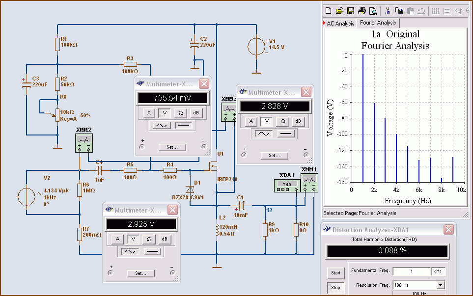

Some analyses
of Tyimo Choke Loaded Class A
Single IRFP240 MOSFET amplifier
Fourier Analysis, Harmonics spectrum
at 1 Watt RMS into 8 Ohm
Looks nice.
The power consumption for this first is:
755 mV / 0.54 Ohm
which gives like 1.5 Ampere
when using one PSU 14.5 VDC
(Power supply Transformer is one Big 9 VAC or one Smaller 12 VAC ???)
What is it Tyimo
Shows very nice falling hramonics.
THD is below 0.09 % :cool: not bad!
Gain is low .. below x1

Hi Lineup!
Looks nice.
Yes!:D
What is it Tyimo
200VA 12Vdc
THD is below 0.09 % not bad!
Oh yeah!:D
It needs a good and high gain tube preamp as you know... :)

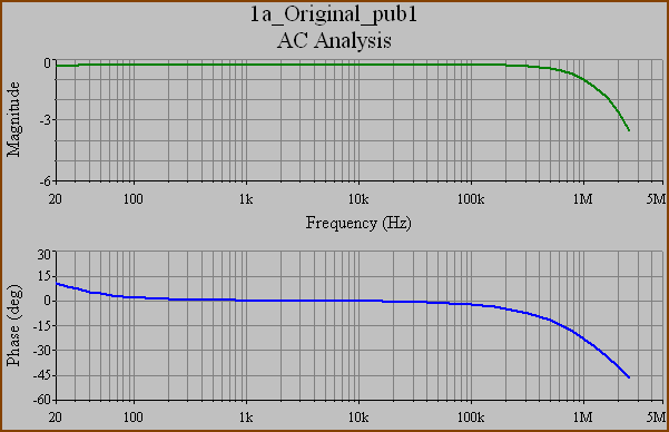

IRFP240 choke loaded AC Analysis
Here is AC analysis.
Impressive :cool:
As my first setup of your Real Circuit shows:
2.2 MHz has rolloff -3 dB
2.3 MHz something for -45degrees Phase .. almost the same.
.. I could have a guess it has been trimmed, for this?
One reason this amplifier can be so fast,
is because the Voltage gain is low. Below 1.
This is one benefit from avoid un-necessary high gains
.. that the bandwidth can stay high.
In short, very good ac behavior and phase.
Superior to many other power amplifiers, I would say.

Hi Lineup!
Two very promising for future are: Tyimo & Keantoken(16)
Oh no. I am under educated and shy..:shy:
No, It is only tuned for musicality.
One reason this amplifier can be so fast, is because the Voltage gain is low. Below 1.
Yes, and it has ZERO NFB.
Yes and thanks!

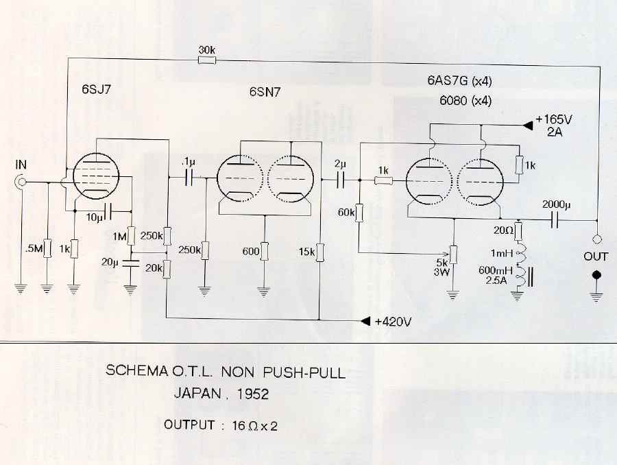

Did you have a particular part in mind for L2? The reason I
ask is I saw a little discussion on Tubecad about the fact
that most chokes unless made for audio use distort AC a lot.
Then the author recommends adding a air core in series with
the iron core choke. The author compared this to adding
a film bypass cap for an electrolytic cap. Here is one example
of someone doing this.
This is a real clever schematic...congratulations if you did it Lineup
of course, we cannot be original as we are in this world of fast coomunications... this idea, the choque coupling, remembers the amplifiers from the fifties (great times).
Into the fifties they used a transformer primary as the transistor or tube load, and the secondary was to the speaker.
this one is nice...only 1.5 amperes.... low voltage....low power consumption and around 25 percent efficiency.... good idea..this one is very interesting.... post the complete schematic please.
I know it is impossible to be the first to have ideas...now a days we can only produce Frankensteins products..as even if we create something, it belongs to mankind...someone had the same idea..or something alike, years or decades before.... hard to discover things now a days.
Congratulations...lovely one.
Carlos
L2 is a gaped iron core.
Yes, the air core measures better on paper, but in the reality you would lose the power efficiency because of the very high Rdc of the air core. You don't need to care about the distorsion of a good gaped iron core.
Tyimo

Uncovered schematic please lineup, the one you have posted is covered
partially with the instruments.... post a new schematic if you want to share this lovely circuit.
Do you think it can operate with 750 miliamperes?...say, adjusting the circuit to this current. in my imagination those field effects works better with that current.... with 1.5 amperes and higher they start to muffle the trebles as i could see in my home.

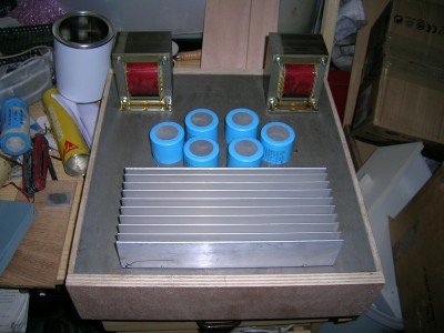

I also have build this amp and I can say that the treble isn't muffled at all with 1,5 amperes current.That's what I think.It's like Tyimo is saying I need to post my impression of this amp.For the time that I had listen to the amp i must say very clear hights and tight bass.Compaired with my Zen amp much brighter treble not muffled at all.New sound impression will follow.

Oriented such a way your big heatsink is useless, unfortunately. With such spacing between fins it was designed for a free convection cooling, so hot air going up should flow in parallel with fins. If you leave it as is, prepare to keep your amp standing on it's side, for cooling purposes.
