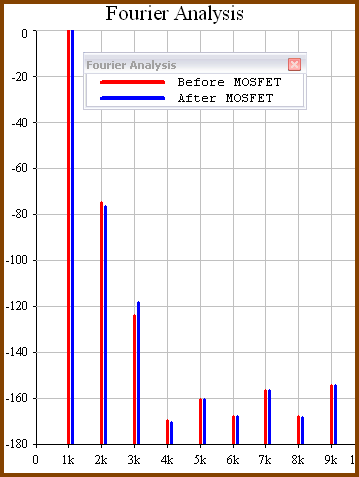

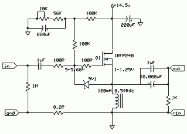

C'mon Carlos, don't you see what is missing?.... Nothing is missing!
Plain old AC-coupled follower into an AC constant current source (the choke) with mixed bias (DC voltage bias on the gate plus some source self biasing from the DC-R of the choke).
- Klaus
- Klaus
And by the way:
Most MOSFET models tend to stink, with a notable exception: the IRFP244 (very close to the 240) from andy_c.
Distortion sims have to be take with very much care, although followers are not that critical....
- Klaus
- Klaus

Re: Thank you by the schematic Patrick
I hope I ain't getting trouble by giving it to youdestroyer X said:
here is the schematic Patrick sent to me by request..because Lineup have not posted.
regards,
Carlos
If you don't want troubles I can design an amp with the same functionality, but better results. 😀
Nobody patented choke loaded source follower, I believe. 😉
Wavebourn said:If you don't want troubles I can design an amp with the same functionality, but better results. 😀
For me it's something like having respect for the person that made the schematic
Wavebourn!
You are wrong!
Pathos Audio patendted the "Inpol" topology!
Tyimo

I've just done a similar amp with 5687 valve input stage , 150mH choke and IRFP150 mosfet running on a 14V rail at 1.5A . In a choke loaded design the output capacitor becomes reverse-biased with reference to 0V on higher voltage swings . Is this an issue ?

Would anybody be so kind to educate an ignorant diyer about how the choke loading works? (references and links are very welcome 🙂 )
Btw I'm a bit perplexed about the 8.2R resistor from input ground to output ground. What's its purpose?

antomas said:Would anybody be so kind to educate an ignorant diyer about how the choke loading works? (references and links are very welcome 🙂 )

Look here and you've your answer http://www.diyaudio.com/forums/showthread.php?s=&threadid=66822&perpage=10&pagenumber=85 see post 843
