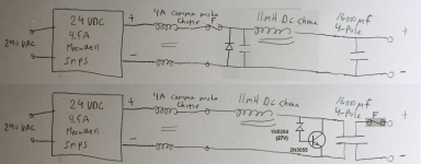

The PSUs are MeanWell RS-100-24 (have four of those). And yes it will be experimental. The idea using the 4-pole caps was to have a very low impedans PSU so peak currents are delivered by the caps. The idea using the DC serial choke was try to "hide" the caps from the SMPS.

In high voltage tube psu I think a rule of thumb is 1k Ohm bleeder pr Henry in the choke. You can measure v out with different bleeder values and chose a value which keep the v out ( when psu is loaded only by the bleeder) comfortably low
I have the ACA and I also have a square wave generator so I could load ACA with 8 ohm and then power it first with just pure Meanwell and measure etc. Then I could load with caps of difference sizes to see what happens. I don't have the 11 mH chokes yet. But I have large 50 mH 25 kg (73 mOhm) chokes used for MoFo I could try with. Think I have developed a special habit for large chokes 🙂
Aha, you put the fuse after the capacitor, then a diode is of no use.
A big zener or a small one with a big transistor to clamp the voltage to a safe level.

Now I added 4 x 30V zener to my order. It is a good feature that you can make an attachment order as long as first order is not shipped…...but also cost a lot of money. This attachment was no. 4.....so I have given myself a lot of Christmas gifts.
I don't know what a large zener is......the ones I ordered was 12.5 W types. They have M4 thread (hope they are regarded as large in this context). So now I have bleeder resistor, Varistor, Zener. These 3 together should do it.....
...to "eat" the energy of the choke if fuse blows to protect the caps from high voltage....

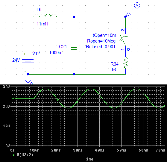

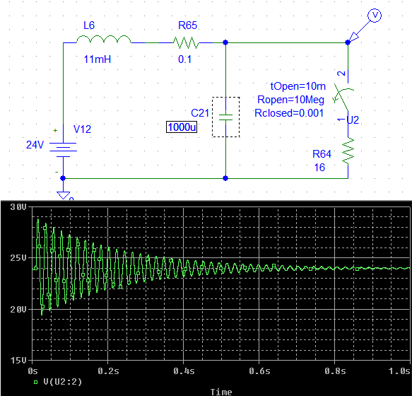

How big is the cap??
For any likely value I get a "surge" like 5 Volts. Your cap surely has 5V margin. For larger 10,000uFd cap the surge is 2V. 100uFd the surge is 16V, to 39.73V.
If these are e-caps they will stand considerable transient voltage. An 11mH choke is not about to blow-up a large e-cap. If choke DCR is 0.1 Ohm the swings start to decay visibly in 100mS, down to 1V excess in 400mS.

It will be two 4-pole Jensen in parallel. Each are 8200 uF / 64 VDC. They can usually take a bit of surge voltage. So you mean that the 11 mH choke with 1.5A DC current has not enough energy to destroy the caps…...can see you have some simulation...….
I could not see the DC resistance for the choke in data sheet. It is only a 1kg (0.25 kg copper) choke rated 5.7A DC.
So 1K bleeder resistor + power zener just to be sure...I should be ok.
Just for "fun"......if choke was 1H......how would simulation look like?
