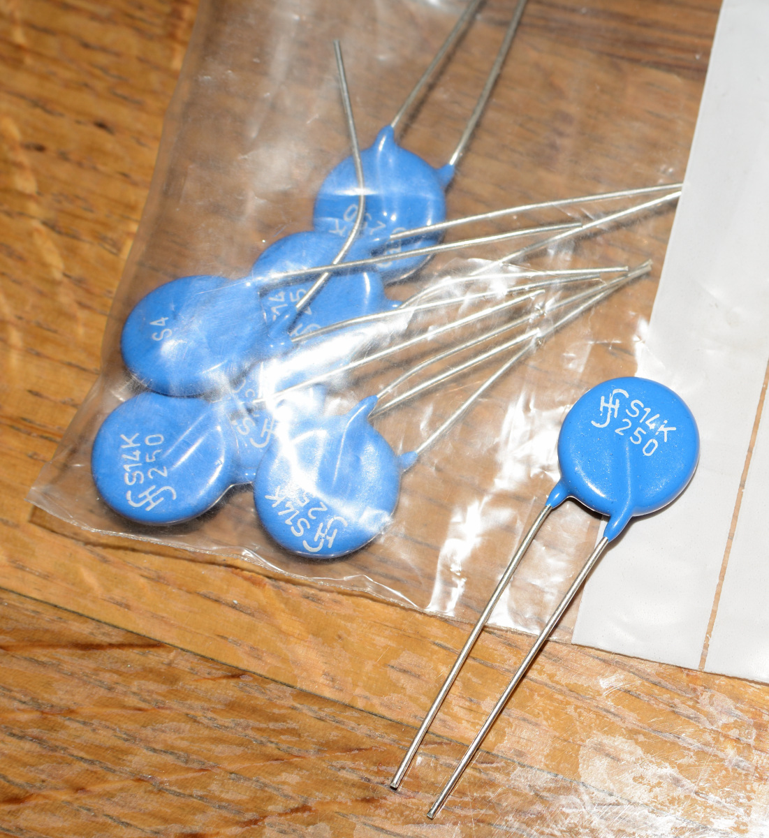

I found the attached in my "back log" but those are for line level voltage.
I found a 30V, 38V type at my local dealer and has ordered some. Max. operating voltage is 30V and it will start kicking in about 38V and are rated 2000A. They call them "Varistor". So I good solution to the problem......I think.
Ok.....now the bleeder will be a "normal" and it is easy to solder the varistor on that bleeder for a bit of extra protection.

A varistor will act as a short circuit and bear in mind the power or Joule rating is for a few micro seconds only otherwise it will go bang.

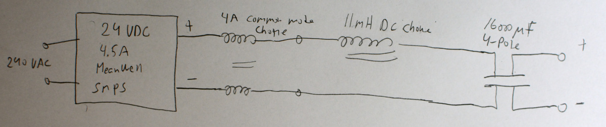

Now I have attached an quick schematic to show what my idea is. I forgot the rail fuse which is after the cap. I will have two of those pr. mono block to make +-24V for both.
So first a SMPS 24VDC and then a small common mode choke to take the worst switching noise. Then a serial DC choke 11mH (5A rated) for additional filtering. My idea with DC choke is also that during power up it should limit the charge up of cap so SMPS does not go into protection. It will probably be some "try and error" as I don't know how intelligent the "error recovery" is made in this type of SMPS. The DC current will be about 1.5A during operation.

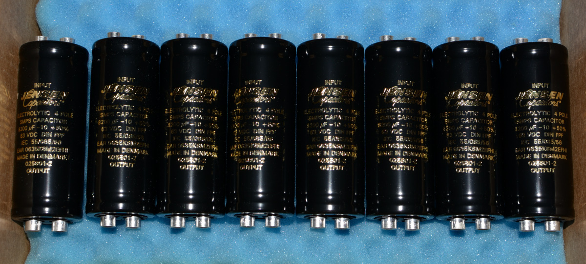

The main idea was to try a SMPS based PSU and make it "super duper" for audio. The 4 pole Jensen Capacitor caps are quite expensive so will not blow them up.
Do you think a diode reversed is enough to protect the caps?
I have ordered the varistors so can do both. So bleeder resistor like 1k + varistor + reverse diode?

You have to to member that SMPS doesn't always like (and need) lots of capacitance.
If you are experimenting then you must rely on measurements to determine what works best... and it could be that small values such as 100uF or lower work best.
Lots of capacitance also impairs the regulation of many SMPS. They don't need it.
