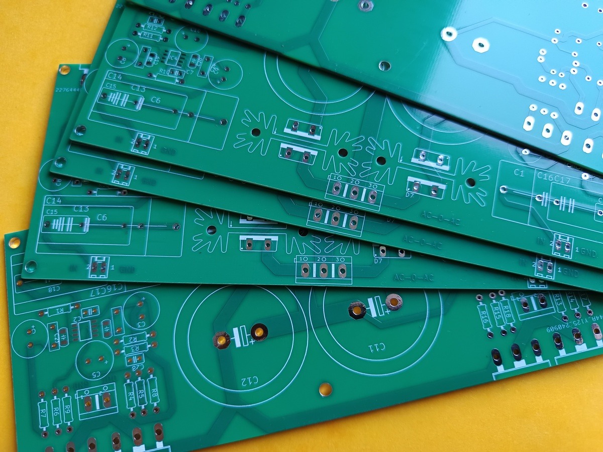

Yesterday I ordered 5 PCBs from JLCPCB
Today they are already on their way. They are fast!
I think they will reach me at the end of next week
As soon as they arrive - I will make a real prototype and check it
If everything is ok (especially stability -) )
I will have 4 boards left to take
Then I will also share the final version of Gerbers

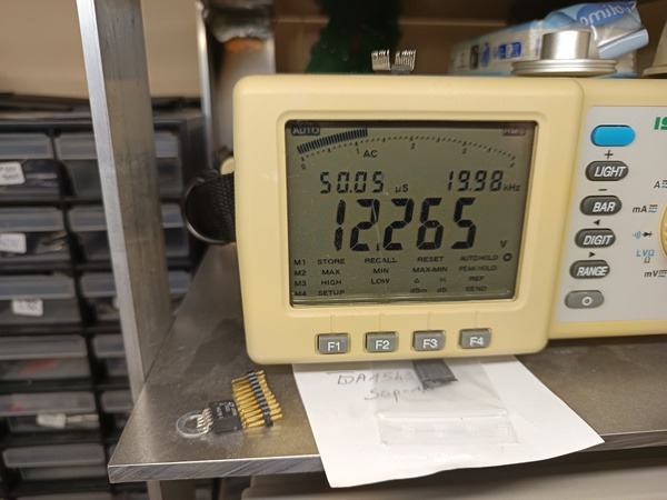

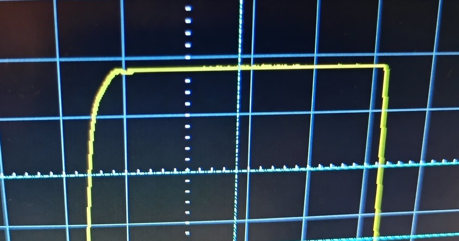

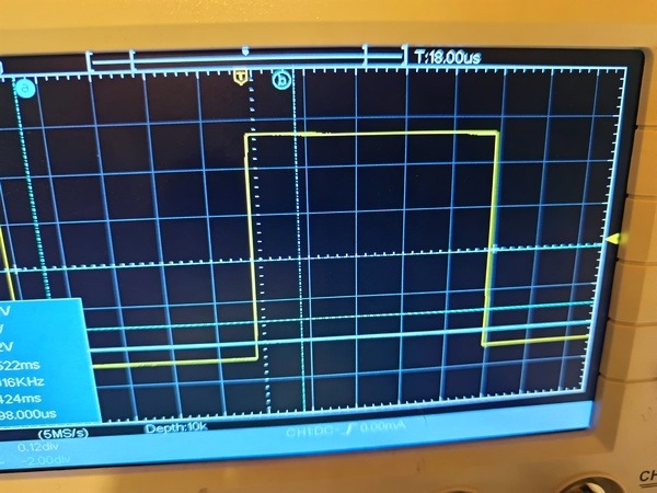

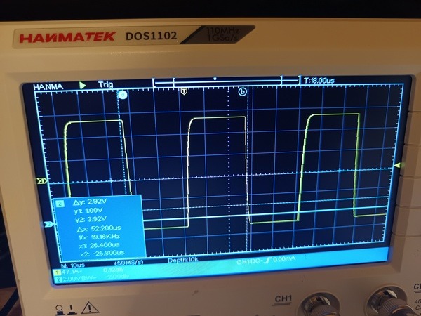

For now, a quick test on an 8 Ohm resistance load
It looks like nothing is oscillating
20 kHz edges are slightly softened
10 kHz looks very good
That's it for today
Tomorrow a test of 8 Ohm +100nF
If it's OK, I'll listen to some music

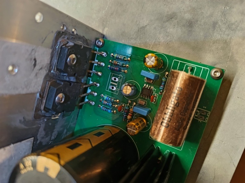

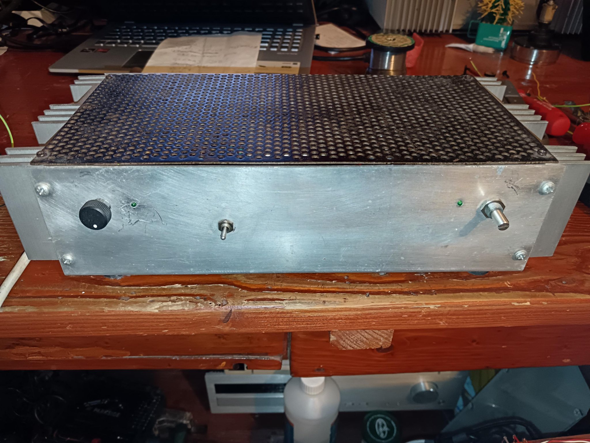

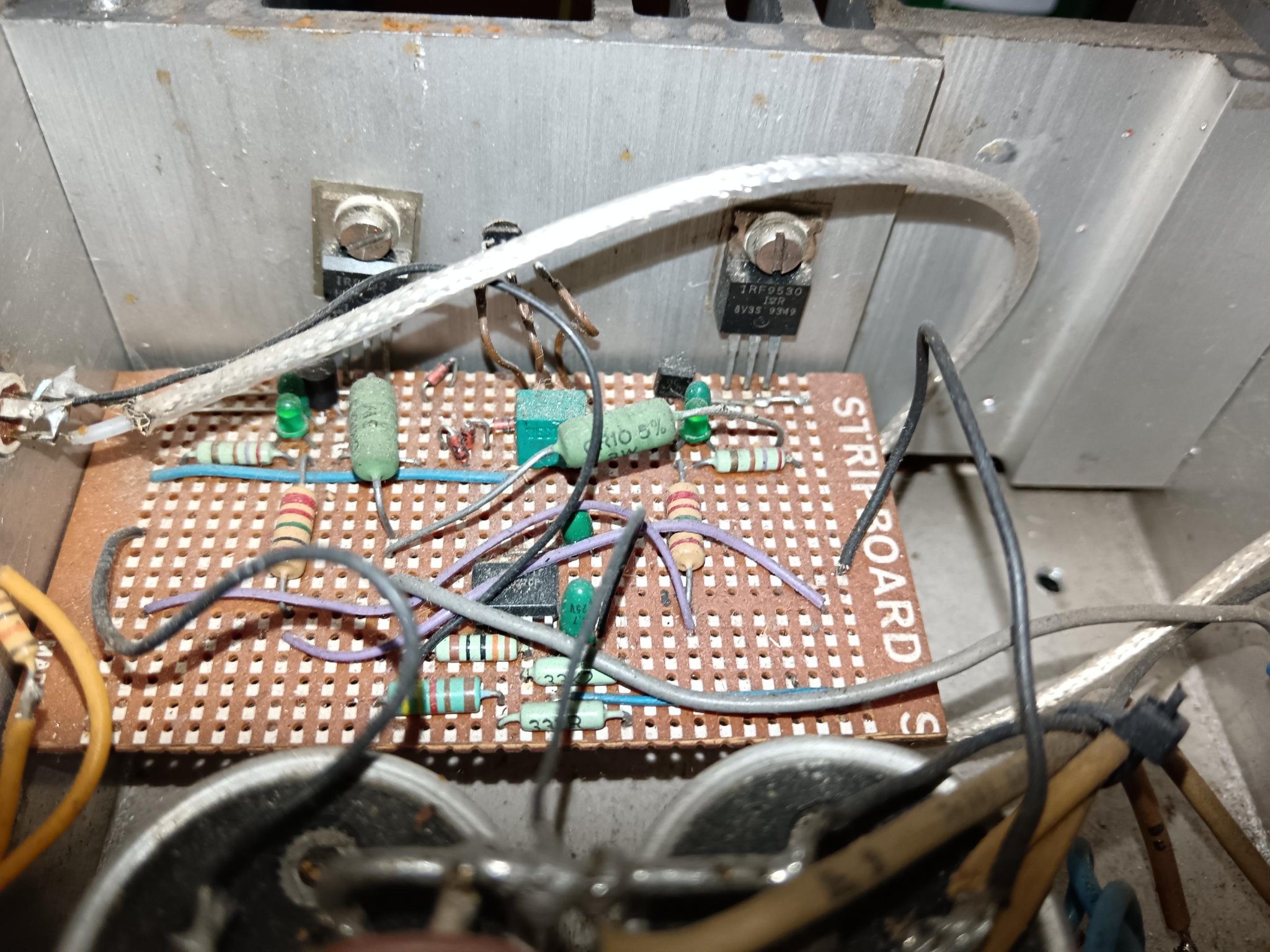

It was 1994 or 94 when at office I built amp very similar to last schematics in post #208. It took extremely little time, not undermining the fact that those day or two I did not deserve my salary 🙂
It played at work happily for few years. Later at home I never used it with main set up, but it was always dug out from the shelf whenever small amp was needed, for kitchen, garden, missing one for active setup test..... whatever. In any case, it was and is used.
The build is not fantastic, diagram was never made, nor was PCB, never measured, just hooked from parts at hand, but it plays w/o complaint
Main difference from Choctaw are:
  • it uses vertical mosfets IRF532 and IRF9530.
  • Instead R3 and R4 there is bias with temp compensation
  • instead of R9 and R10 there are current sources (at least I think when looking from above 🙂
  • TLE2027 was used as opamp, not because I think it was best at time, but because I had couple at hand.

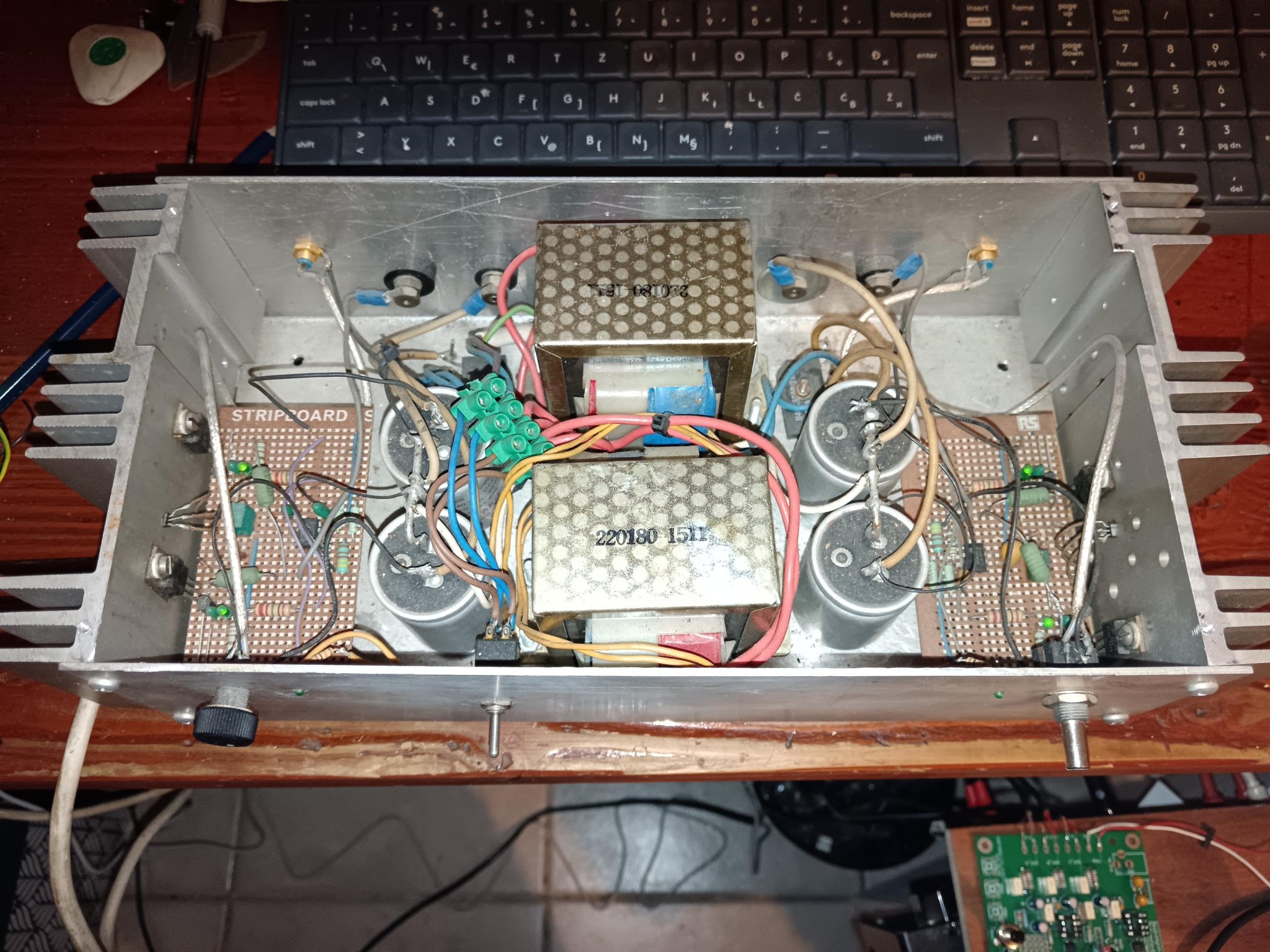

To build the amplifier I used:
2x12V 225VA toroidal transformer (overkill!)
2x10000uf ELNA as main caps
MUR840 diodes on the radiator (they are not warm)
Decoupling capacitors around the OP-AMP- 47uF Nichicon FG, 100nf Philips and 100n COG Murata (smd)
The capacitor in the feedback loop is Nichicon KA
Standard resistors 1% MOX
Input cap is Obbligato copper -good and not expensive
Power transistors - 2SK1058 / 2SJ162
I did a few quick listening tests
I have 92dB / 8Ohm speakers with a 15 inch woofer
There is no shortage of power!
Oscar Pettiford double bass sounds rich and authoritative
Female vocals (Dinah Washington, Nina Simone) sound great
I'll be listening to this for a while
Really good little amp!
