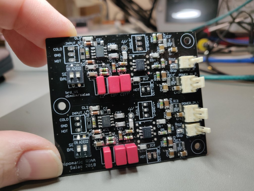

Finally finished soldering. (Of course not as good as dimdim) With the exception of the LT regulators - I promised never do that again! - not too difficult. I used just a magnifying glass and a normal size iron.
It works fine electrically, now to make it a practical preamp to test it.
I used 33R for RG in order to get 45 dB gain. I will use some 12dB transformers I already have, for my cart.
Can skip doing the local LDO reg circuit altogether and directly feed at the rails connector from say an UltraBiB shunt reg. But in order to honor its name it had to have chips all over it 😀

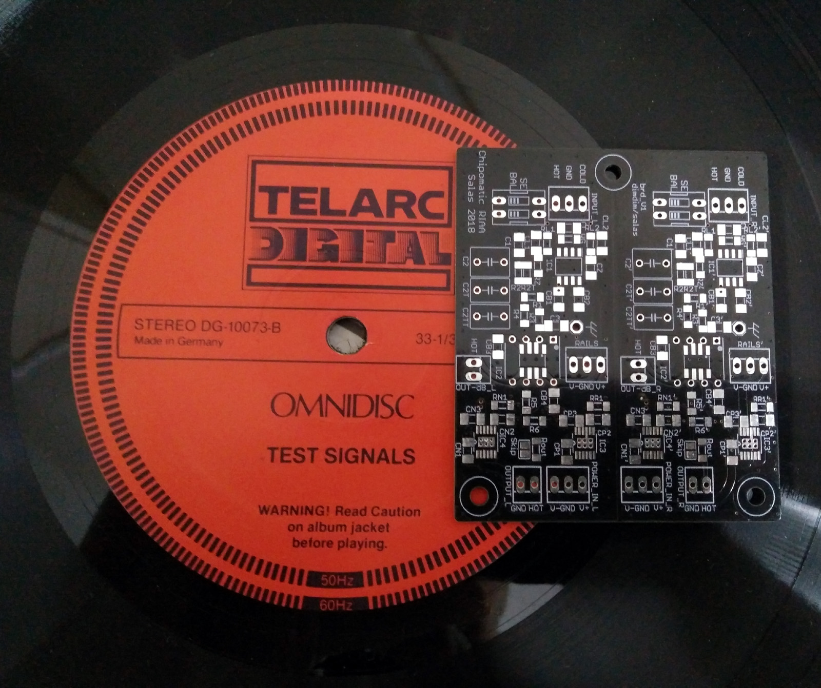

I would like to acquire your 2 independent channels in a 70mmx60mm card with all the extras and all the modern comforts.
I do not need 4kTV, sofa, espresso machine and a free trip to Mykonos just your prototype.
If you accept of course 😉

One populated PCB:
Power-up was uneventful, no magic smoke in sight.
Power draw was ~18mA / rail / channel.
Proper testing will be done tomorrow..

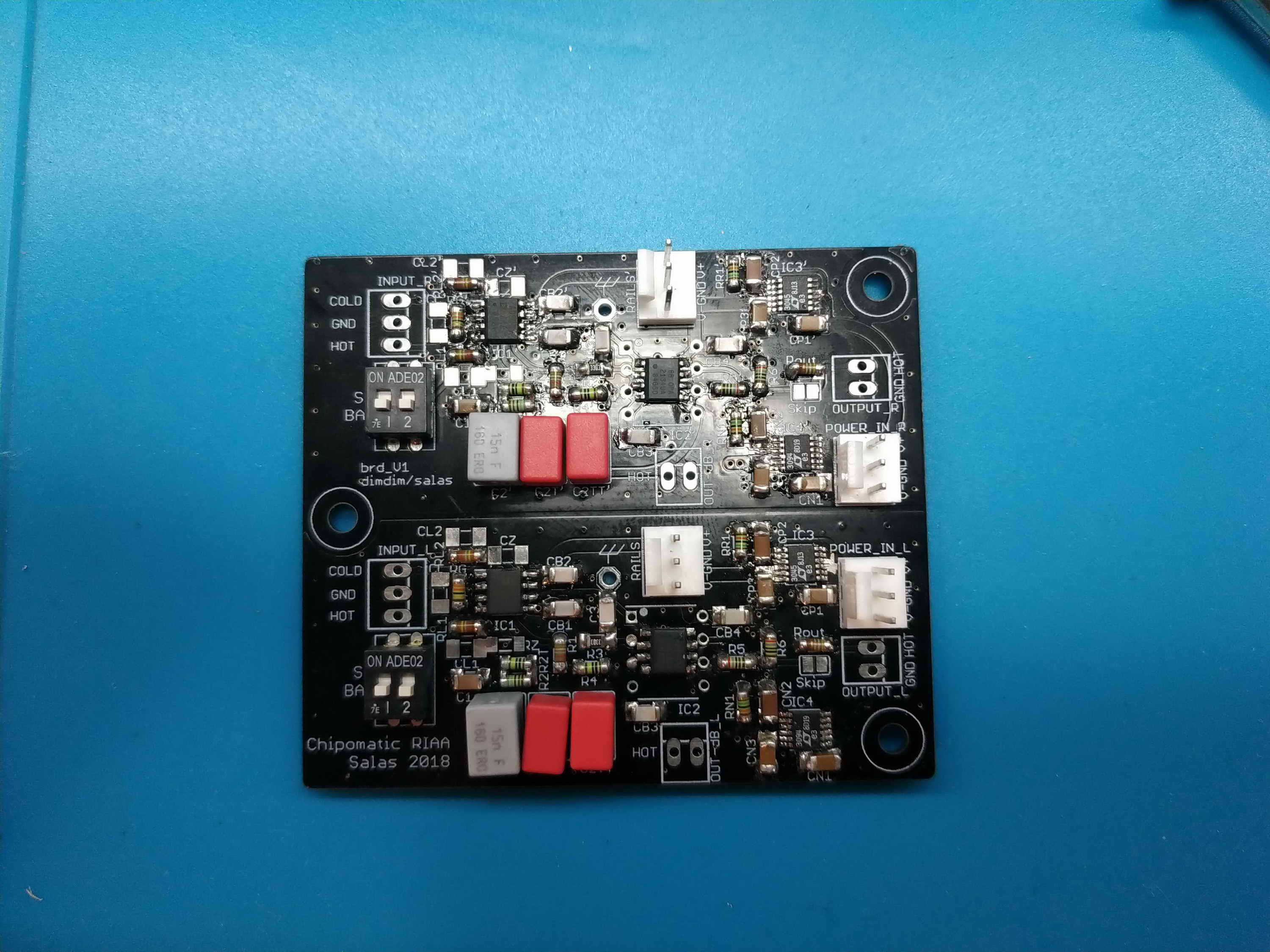

There's a layout bug to fix before you do some testing with signal. R6 must be moved between R5's left side and RN1's ground side, else you will get unity gain from IC2 instead of 10X. George called to ask why no gain from stage two and we debugged it over the phone.
I see it now. My bad, going from your (correct) schematic to my (Eagle's) schematic.
Funny enough, I was looking at my Eagle's schematic the other day when I was ordering the components and that part of it looked a bit odd, but I didn't pay much attention. It appears that I should have.
Its those Eagle boxes don't look like electronic op-amp symbols so it did not stick out. Anyways, its a cute little bodge. Any prototype needs one for good luck.
