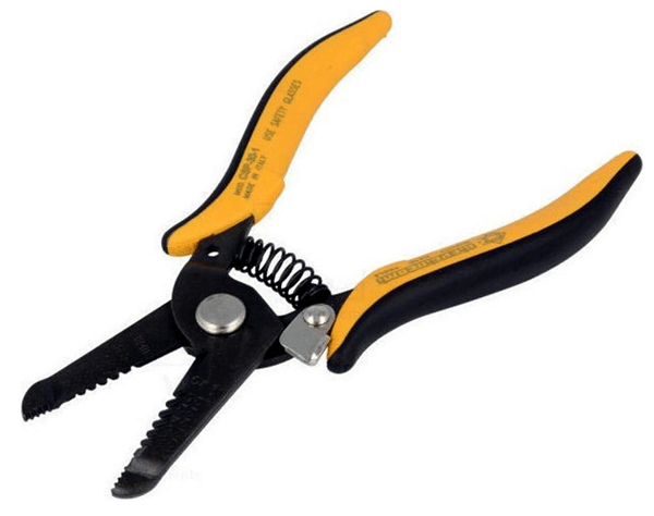

By the way, to tackle small cables easier try a Piergiacomi CSP-30-1 wire stripper tool. Its Italian and you will easily find it stocked in EU vendors.
