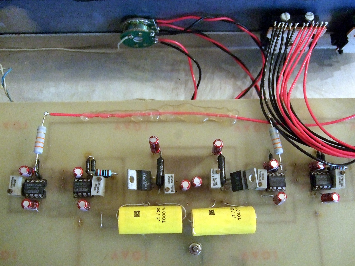

But I decided to check them out. So I ordered four. Ouch! Two 627 two 637. I wanted to make a line preamp. They came in a month or so. I was also handed a ​5 1⁄4 inch floppy. It was some documentation on MS-DOS. Never saw what exactly. Because I had an Amiga. 😀

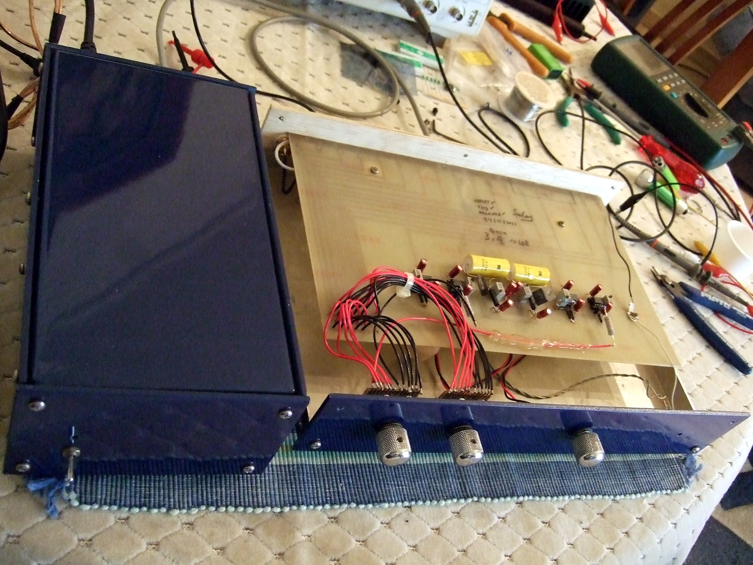

So I started the design. The electronic plan was 627 buffer stage --> Sfernice Cermet pot --> 637 gain stage both with offset trim. Six inputs and an extra selector for REC out to my SONY DAT deck.

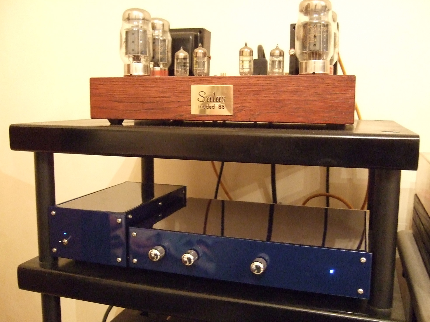

My tools were a felt pen, blank paper, a Metex DMM and a Weller 25W wall powered iron. I draw and etched a board then cut Alu panels. It looked rough initially but I also had a finish concept. Automotive dark metallic paint and knobs from a Telecaster guitar. 😉
I could not measure the performance but it sounded clean as a whistle. Kept it for long enough until new experiments came up, it ended up at a friend's system.
End of 2011 he brought it back for an overhaul. The pot had gone scratchy, the paint job had flaked off at places, one channel was coming and going on its own will.
The chassis got back panel reinforcement for new stronger RCAs and a new blue paint coat, the French pot was replaced with a Chinese stepper and the intermittence got traced down to a joint. New lease of life for the pre. :wiz:

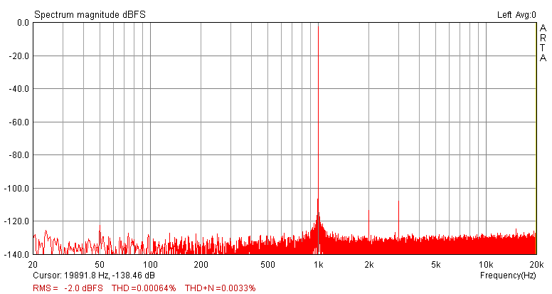

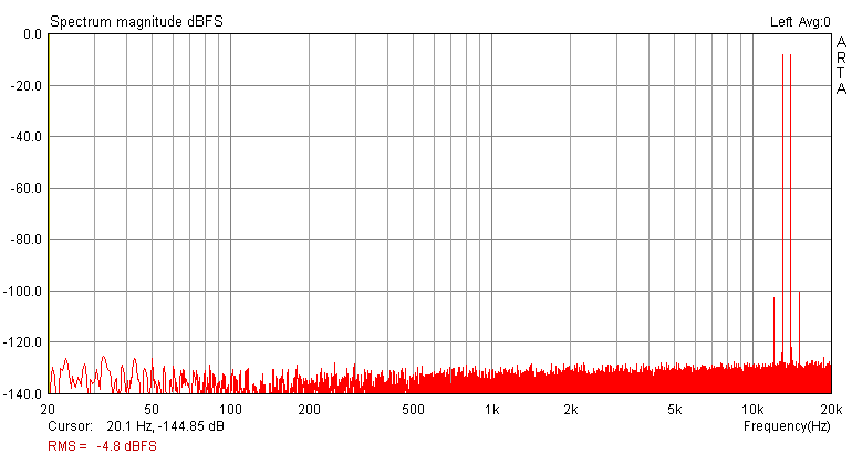

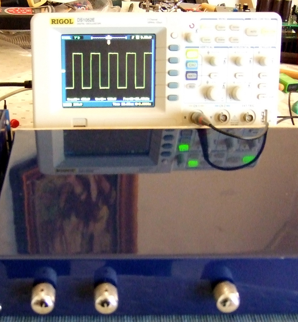

But this time I had a scope and FFT card for curiosity measurements before handing it back. 😎 Yep, it was a clean machine indeed. 🙂
