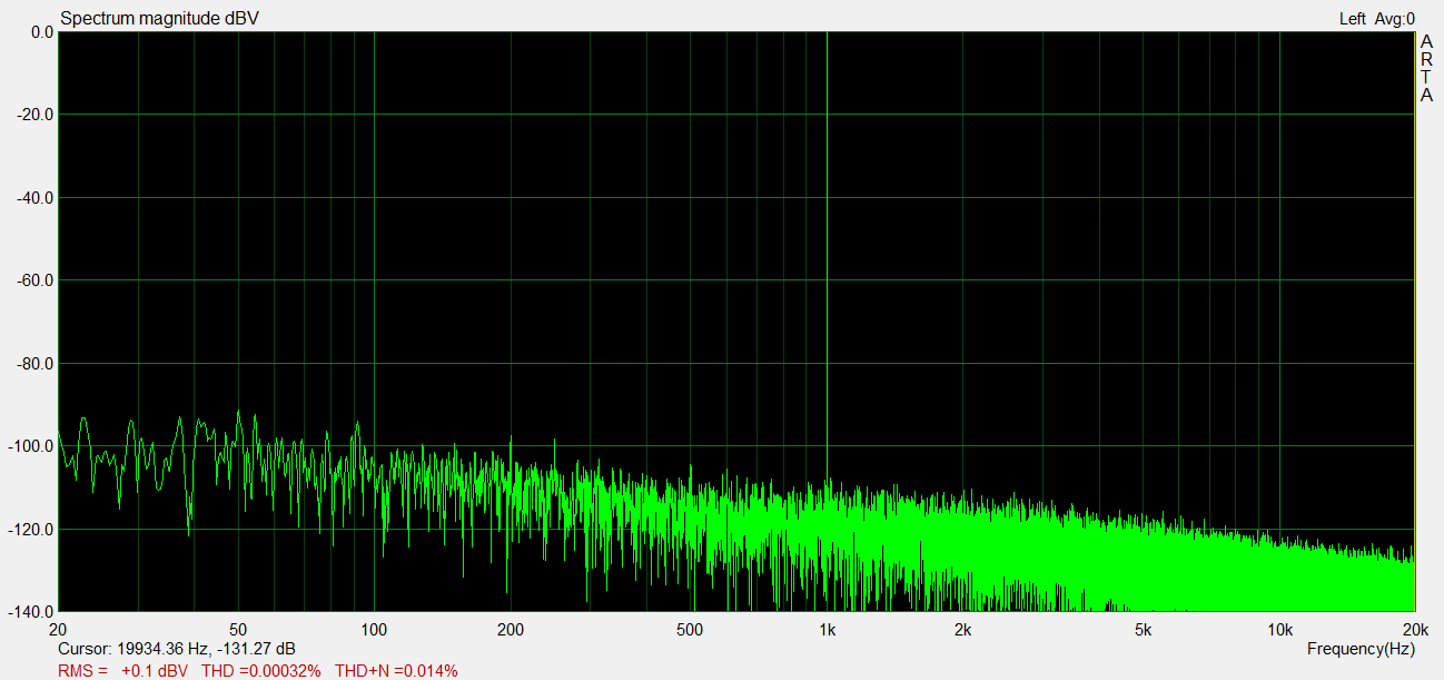

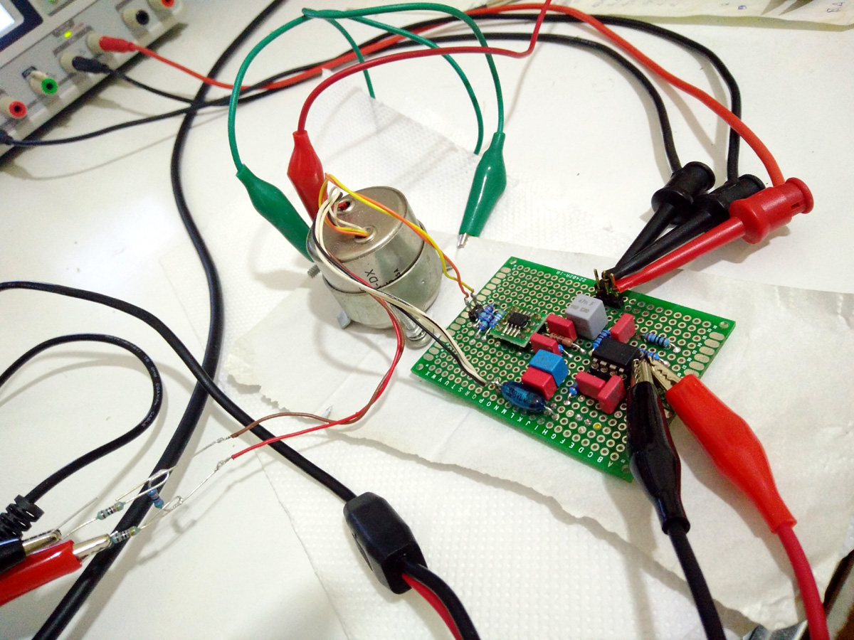

By the way, 1VRMS FFT at 62dB gain when fed from a Jensen step up transformer, input config is BAL.

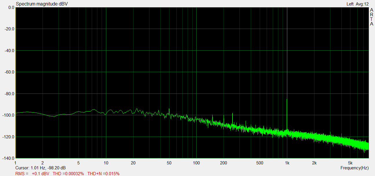

Here's 1/F from post 21's config. 12 averages to see deeper. Nice 1/F result no uphill. The mild subsonic curve designed in the DC servo should have helped in this too. Hey, where is my raw input 0.00067% THD at same output level from post 9? Why the SUT interfacing changes that down to 0.00032%? The balanced impedance divider has 43 Ohm Zo. The SUT 4kiloOhm Zo. Scott, can this be cancellation between the SUT THD and the AD8429 or internal better result to it or a better result between the INA and the OPA now that the INA works at 100x source impedance level?

Hmm now that I think of it, it should be due to the EMU having to output 1/10 less signal since the transfo steps it up vs how much it was needed for 1V Chipomatic output when with raw input and same RG.
The EMU TRACKER is my audio interface box that I run ARTA measurement screens with. 1/F is the noise region below a frequency that noise starts picking up from a pass band average level. All things in nature do that, not only electronics, they go noisier the lower the frequency after a corner point. Other earlier and faster, other later and milder. If you listen to the waves breaking at a seashore although you can hear various pitch swirls the bass noises tend to bunch up and dominate.
1/F noise can end up too much in a phono given the internal gain goes way up in LF & VLF due to the RIAA curve. So we ought to keep it in check. Else we will hear a boiling rumble especially on big sensitive loudspeakers and closed back headphones.

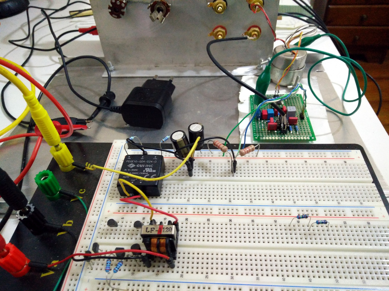

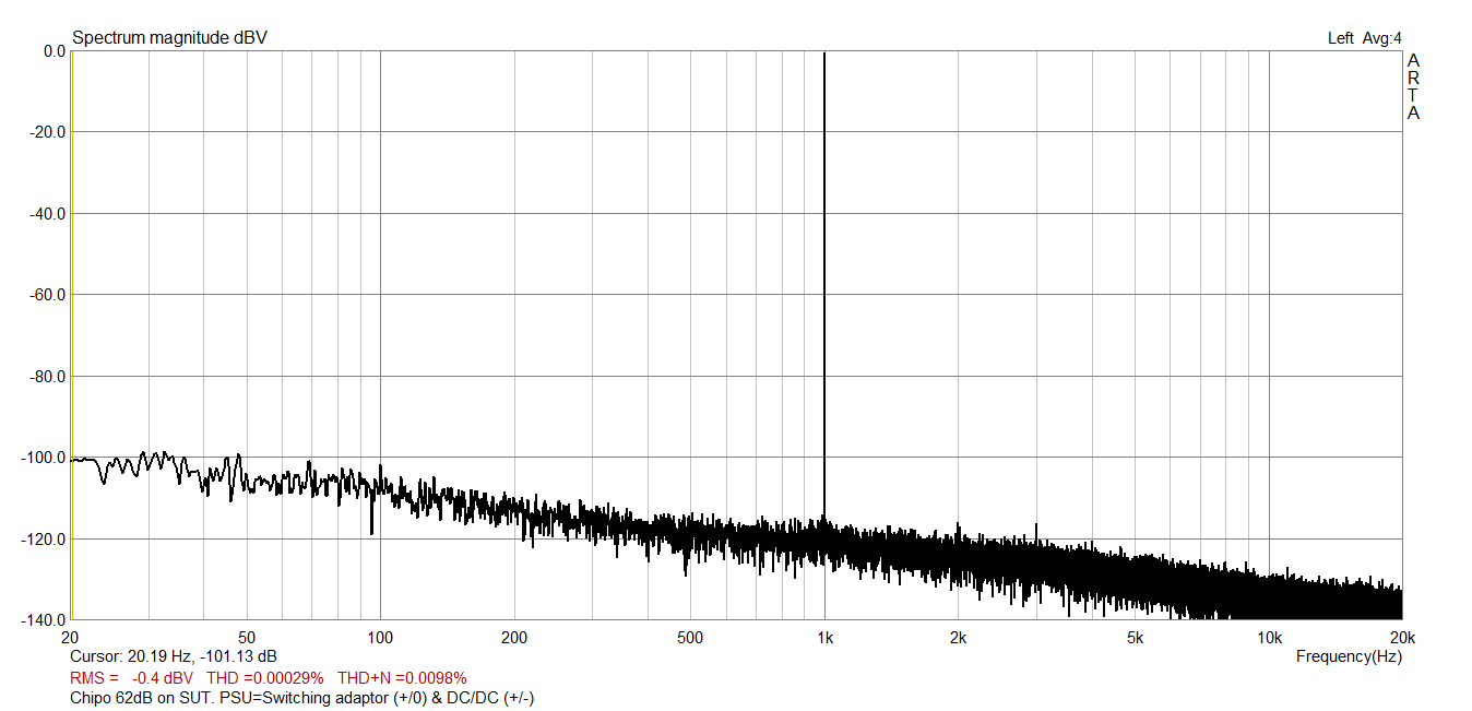

Test with SMPS (a Philips hair trimmer's switching wall adapter, a CM choke from a broken satellite receiver's PSU for bit of EMI anti-pollution, a CUI DC/DC dual output converter of 80mVpp ripple spec to turn the adapter's 15V loaded output to 24V symmetric, basic RC filter and a resistor divider to +/-14V for 20mVpp 235kHz switching ripple on each rail and as much a dirty return point, no linear post regs, 1VRMS signal output, 62dB total gain with a Jensen 10X step up transformer)

I am doing those experiments out of the same curiosity as yours. Right now I am giving input for a dual mono layout to be finished by local friend Dimdim (DACs & firmware aficionado) on easy to handle 1206 sized passives SMD board so to can evaluate it with no doubt. The RIAA capacitors value combination will remain through hole to be MKP. Can also accept MELF resistors. Will have SE/BAL input switch and onboard LT3045/3094 regulators to be small sized, tightly looped, and self contained. Will let you guys know.

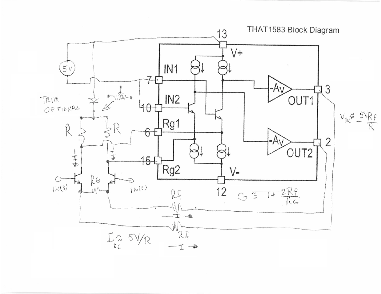

At your service. This is a sketch all caveats apply. The basic idea is to replace the input devices with ultra-low noise ones and use the existing ones as cascodes. I'm not sure how far down you can push the noise with this but 0.5nV should be within reach without extreme values.
The 5V below V+ cascode voltage sets the collector/drain current of the input devices, the loop forces the outputs to a negative common mode voltage like in the original Demrow version of this circuit. Typically one would use something like a simple 4 resistor/op-amp differential to single ended converter for the eventual output. The gain equation is the standard one.
An extreme case might be running the input devices at 5mA (R = 1k), and Rf = 250 Ohms, and Rg = 5 Ohms for G = 100. I have no idea if this is stable or has other misbehaviors.
