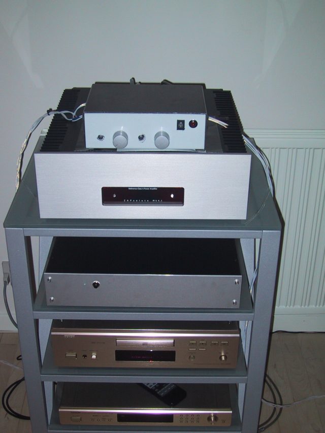

Update on the ugly duckling!
I also thought that a small 2-way speaker would be a good fit for the GC.
I have been listening to my small ugly GC a couple of days now on my Proac 2.5 clones. I have to admit that it is very enjoyable. It actually sounds very nice. Not as good as my Zapsolute, but nonetheless good. I can recomend that combination, but perhaps its like shooting ducklings with a too big gun? By the way, I have upgraded the duckling with 2 inputs and a selector! Wauw.
Welcome back on this thread, Carlos. Your opinions are very much apprieciated. We can't afford to have you lurking in the shadows
Here is a pic of the duckling with input selector.
Steen.
