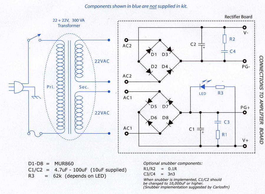

raypalmer said:Okay... I'm sorry I'm fully overwhelmed now. My 0-24, 0-24 Transformer.... How do I wire this with my power supply so that I will get 24V x 1.4 rather than 48v x 1.4??
All I need is to have the right amount of voltage to my amp and I believe I'm off to the races.
Hi Ray, voltage between V+ and V- should be 66Vdc. Voltage between PG and either V+ or V- should be 33Vdc.
Barry.

Hahahah yes! I had that brainwave about ten minutes after I read Peter's post! Colour me dunce.
Anyway I got it working. Between switch on and the amp sending out signal there's about a 3 second delay, then an extreme-high frequency noise that ascends until undetectable. Big "thud" when switching off but that's to be expected I thing.
Big question is: Why is it so quiet? I cranked my Wakonda to maximum volume to get verrry quiet playback out of the Gainclone. I connected it to rubbish panasonic speakers, my old missions and to some tang bands I have lying around.
Measured .5v and 85mA +/-5mA across the posts while running the amp.
