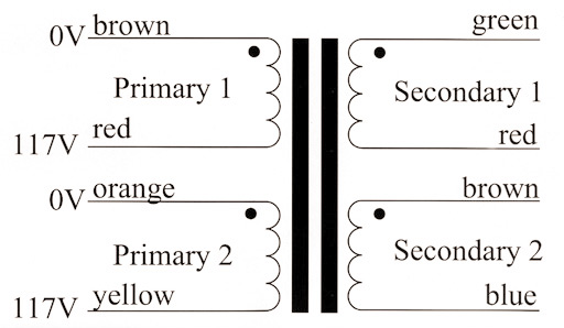

raypalmer said:I've got it plugged into the bulb tester at all times until I know forsure I've got a healthy device. As for the xformer, I tested it as suggested before installing it in the box and it worked like a peach.
An externally hosted image should be here but it was not working when we last tested it.An externally hosted image should be here but it was not working when we last tested it.
I may need to use a non-cellphone camera...
Hi Ray, I looked for the colour code of your xformer on line.
I found the diagram below and if it is correct, your primary is wired wrong. You have orange and yellow connected together and red / brown connected together??
if the primaries are wired out of phase then the transformer alone (open circuit secondaries) will have the test bulb brightly lit.
If the primaries are in phase then the test bulb will not even glow dimly.
Yeah, I had that same doubt so I switched the primaries a few days ago, but it lit up my bulb, at present the bulb tester is totally dark.
Hi Ray, if the diagram I posted is the same as the one on the side of your xformer, then you should connect the Brown/Orange to neutral and the Red/Yellow to Hot..

Okay so I have the primaries resolved, and am getting 24v per sec.
24 x 1.4=33.6
I'm getting about 66v across the amp boards.
So... 66/2=33
It appears to be bridging the two DC supplies... why?!!?!?

Hi Ray,
you've got a dual polarity supply from dual secondary transformer.
Middle connection is treated as zero volts.
The other two connections from the PSU are +33Vdc and -33Vdc.
All normal for this 24Vac transformer.

Hi Ray,raypalmer said:Okay audio1st I owe you a coke.
Now I think my secondaries are incorrect. Are they??
It looks as if you have 2 white wires at V- and 2 red wires at V+..
I cant see where PG- and PG+ are connected, have you just tied them together?
They need to connect to the AMP board ground..
Please let us know how you have connected these wires.
Barry..
