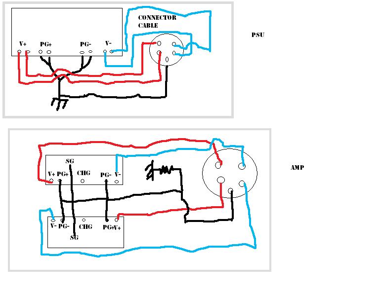

Sorry I'm so dumb, you guys are gents for helping me so much.
I've got two wires on V+ and V-, PG+ and PG- are wired to the ps chassis ground, which is in turn wired through the connector cable to the amp boards star ground and by way of that to the chassis ground for the amp enclosure. Here comes a diagram:

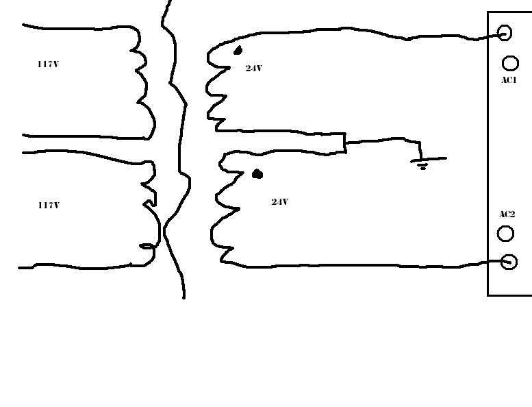

So Andrew...
In order to treat the middle connection as zero I do this (see crude diagram), right?
Is only having one of two holes in AC1/AC2 going to work?? Doesn't that defeat the rectifier?
I'll post it when I get back from work. Your beautiful diagram puts me to shame
So by only using one of the V+ and V- pads, and splitting it across the two amps, I'll halve the voltage? I was beginning to think I'd need to buy a transformer with lower voltage.
sharing the PSU currents across two amplifiers has nothing to do with halving the PSU voltage.
The PSU has two halves each half has an output voltage ~ 1.5Tines the Vac of each transformer secondary Series connect the two output voltages at the rectifier PCB and you get +-Vdc ~= 1.5 times Vac + Vac.
You can use either a single rectifier to achieve this +-Vdc or you can use dual rectifiers to get similar +-Vdc.
The single rectifier version series connect trhe secondaries before the rectifier and can use a dual secondary transforme ror a centre tapped transformer.
The recent diagrams posted here show a dual rectifier version that must use a dual secondary transformer. The series connection of the supplies is after the rectifier in this case.

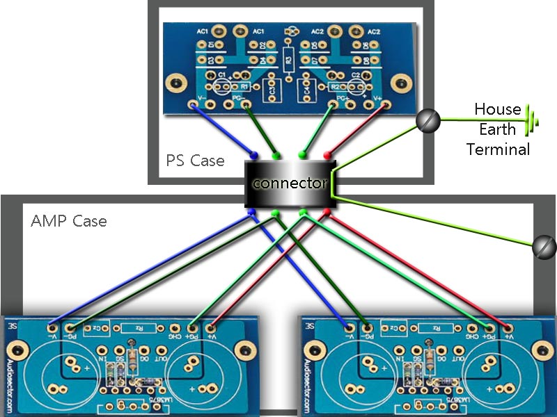

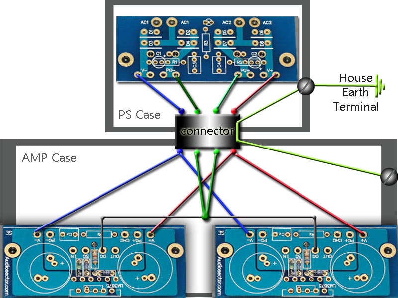

audio1st said:Hi Ray, the second picture is wrong.. The layout you have at the moment should work but may hum.
Below is my suggestion..
We may have to look at the Amp boards next?
Barry,
That's a beautiful diagram and I was using such setup successfully in AMP-1 for many years. That amp was dual mono with separate power feed to each channel.
When I tried to use similar approach in Patek or an Integrated Amp some people reported hum problems, so I modified ground wiring and that was better.
So if would be so kind, can you adjust the diagram in a way that OG points (on amp boards) are connected together and PG- and PG+ wires from power socket connect centrally to that connection, like in a picture here: http://audiosector.com/images/patek2/patek2_01.jpg
