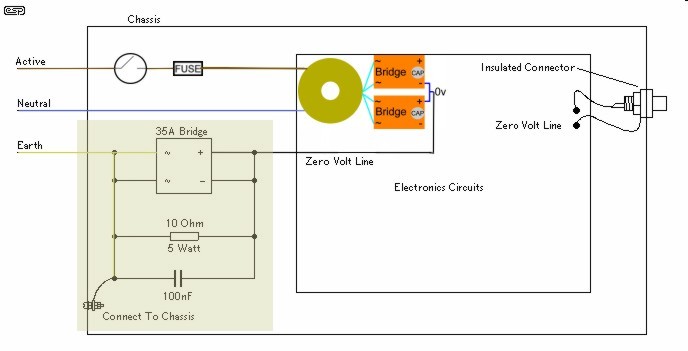

I would like to add the ground loop breaker to my SMPS powered GC.
I know that I can't join the 0v rails of the two SMPS modules so have to treat this as two monoblocks even though they share the same wooden case. So I need a separate loop breaker for each channel and propose to do the following:
Blue line between SMPS and amp is 0v, red is positive voltage and black is negative voltage.
The side of the loop breaker that goes to earth would be bolted to the metal chassis of the SMPS module (that is in turn connected to mains earth).
Does this arrangement appear OK/safe?
