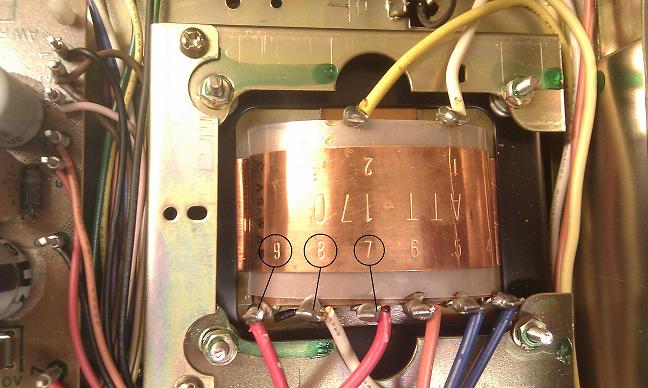

First amp, suitable transformer?
Hi all!
I was at the local junkyard and salvaged an old pioneer amplifier to check if it contained any useful stuff for my first lm3886 build.
Found a neat little transformer (weighs about 1,7kg which should be around three pounds).
I fired up the amplifer, turned it upside down and started measuring.
Between the secondaries marked 7-8-9 I got 22,8v when I measured 7-8 and 8-9.
I followed these leads to their fuses and they were 3,15A. Can or will this be "ok" for a stereo pair of lm3886? I do not know the VA rating of this transformer, it is probably not all that high.
I am planning on using at least 10000uf per channel in the powersupply, "snubbersupply".
Anyone with experience of this, is it better to use less or more?
I have read about others using 80VA toroids for a stereo amp, but of course they have been limited when it comes to output power.
Thanks in advance for any thoughts.

Mmmmm ...
Bicolor: best you find a manual or spec sheet for that transformer before you assume too much about which pin does what ....
The findings indicate a 120 VA transformer and the voltage appears to be a nominal 2x20 V. That is comfortable for 8 Ohm speakers. It is pushing it a bit for 4 Ohm speakers, but with generous heatsinking it is worth a try.

The findings indicate a 120 VA transformer and the voltage appears to be a nominal 2x20 V. That is comfortable for 8 Ohm speakers. ...
Your comfort zone may be different than mine ...

Thanks, I looked around for some specs but I could not find anything.
Maybe I'll give it a try.
It's easy to change to a bigger one later down the line.

that looks like a gauss band around the transformer winding. An indication that they have spent a bit of money on trying to improve the performance standard of the transformer.
Are those the mains connections exposed on the bottom side?
In their present exposed condition they could be accidentally shorted to each other or to core. Take care.
AndrewT: Yes, both the primary and secondary connections are exposed, they were mounted facing the bottom of the amp. I am thinking of mounting it upside down so that the connections are easilly accessible. I will most likely put it upside down so that the connecions are easy to access.
