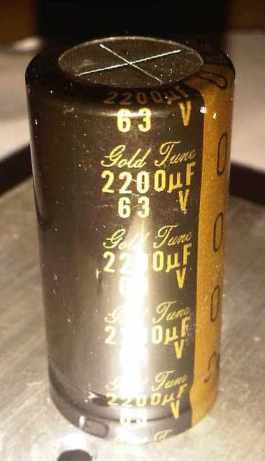

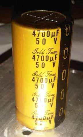

I have found in local store for Black Gate F 680uF 65V with fair price - around $4.5/pcs, i'm considering to use it as C supply for LM3886 to replace Nichicon KG 1000uF 50V. Is it sufficient to use 680uf instead of 1000uf?
I'm still choosing the best one for the snubber psu :
- Nichicon KG 10.000 uf x 8 - $9/pcs - total $72
- Nichicon KG 4700 uf x 20 - $1.7/pcs - total $34
but the 4700uf version is gold casing, the seller told me that it's the previous version of KG instead of black casing..the 'normal' one that I find in the web is that the casing should be black, like my 2200uf. any clue about gold casing of this nichicon KG? is it possible a counterfeit version?
attached image show the caps that i get
680uF is a bit on the low side. You should be looking at about 10000uF per rail. This can of course be made up by adding smaller capitors together in parallel.
