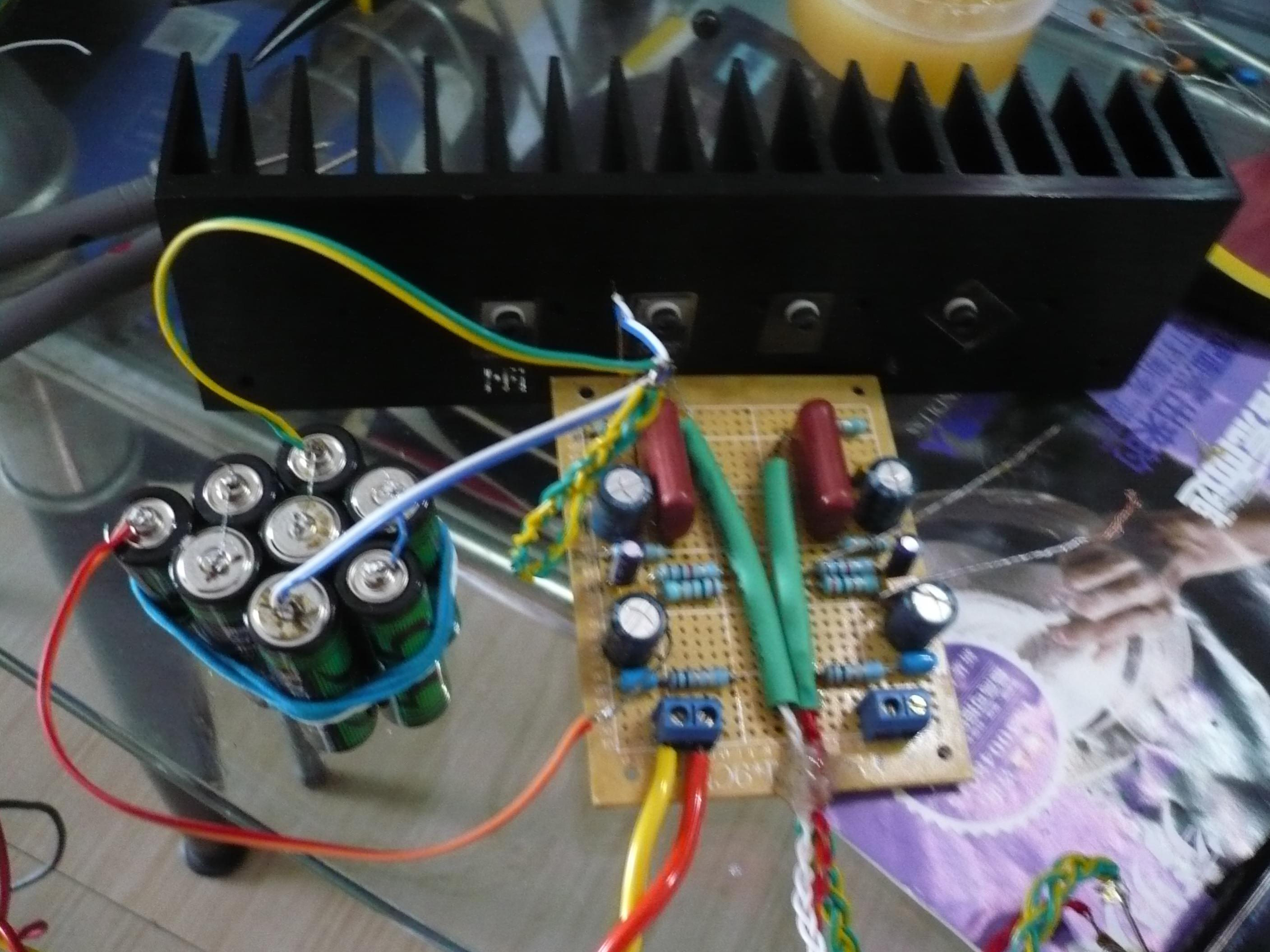

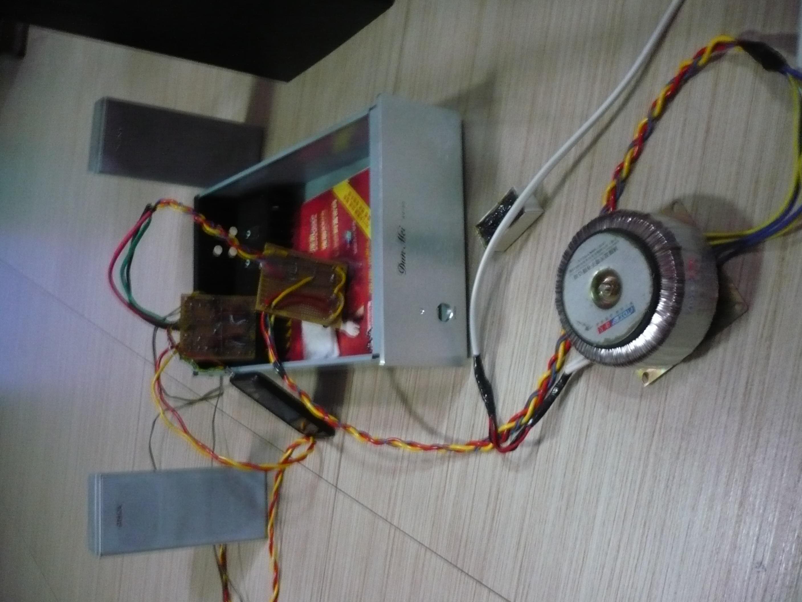

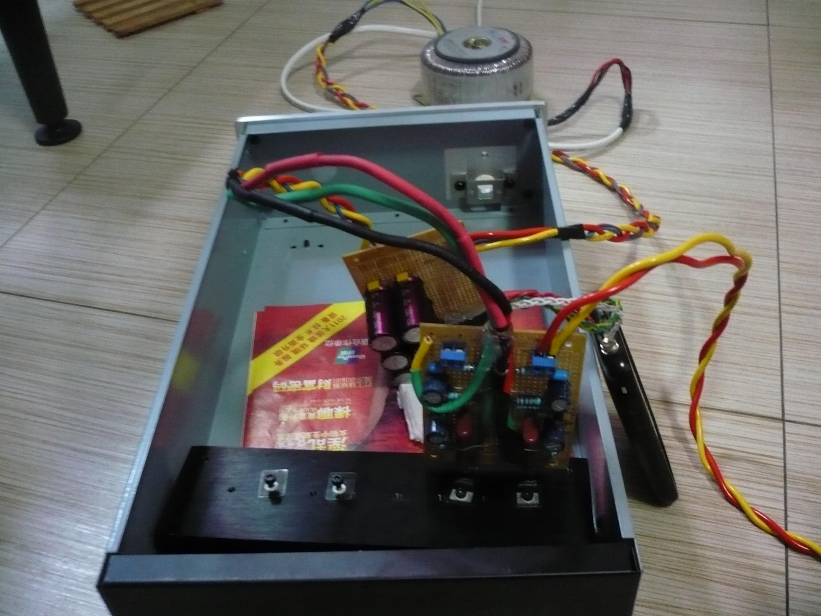

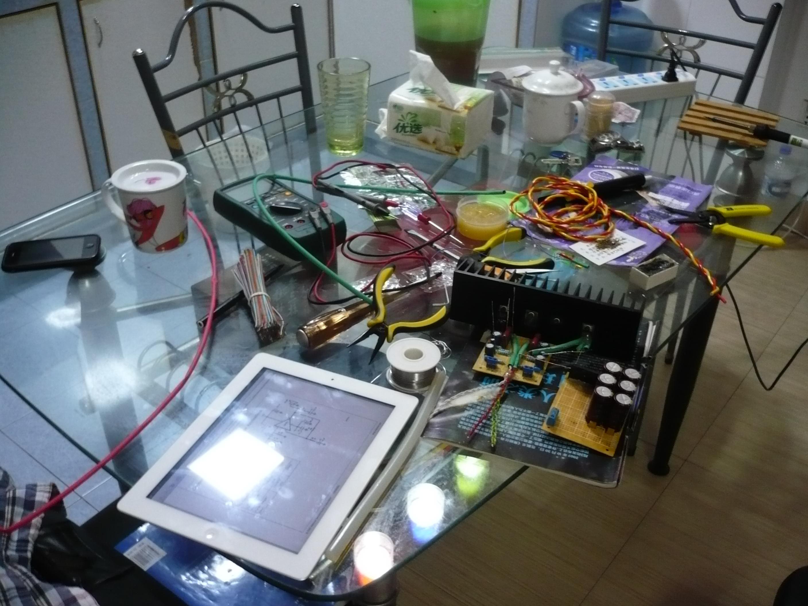

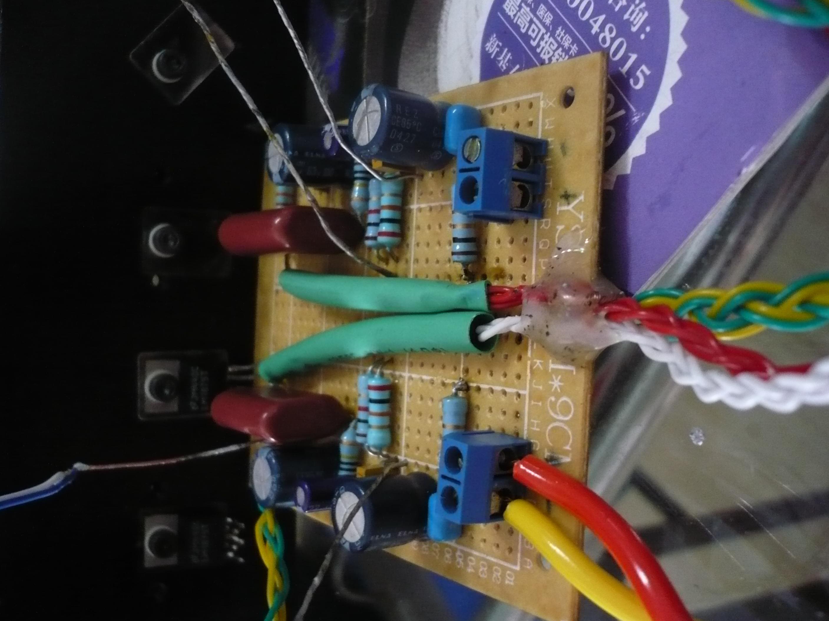

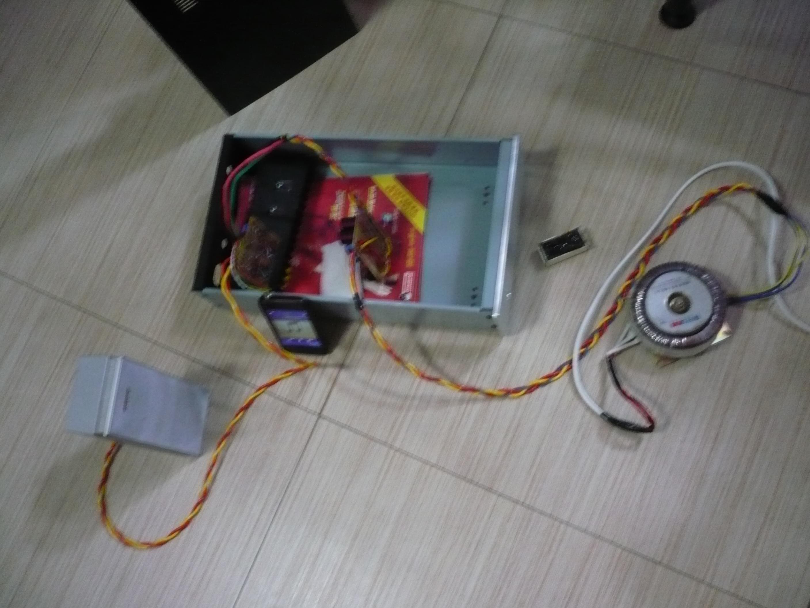

LM1875 btl
this is my first amp project, it was ugly, full of frustration and pain, of course gain at last, anyway share with you guys.😛

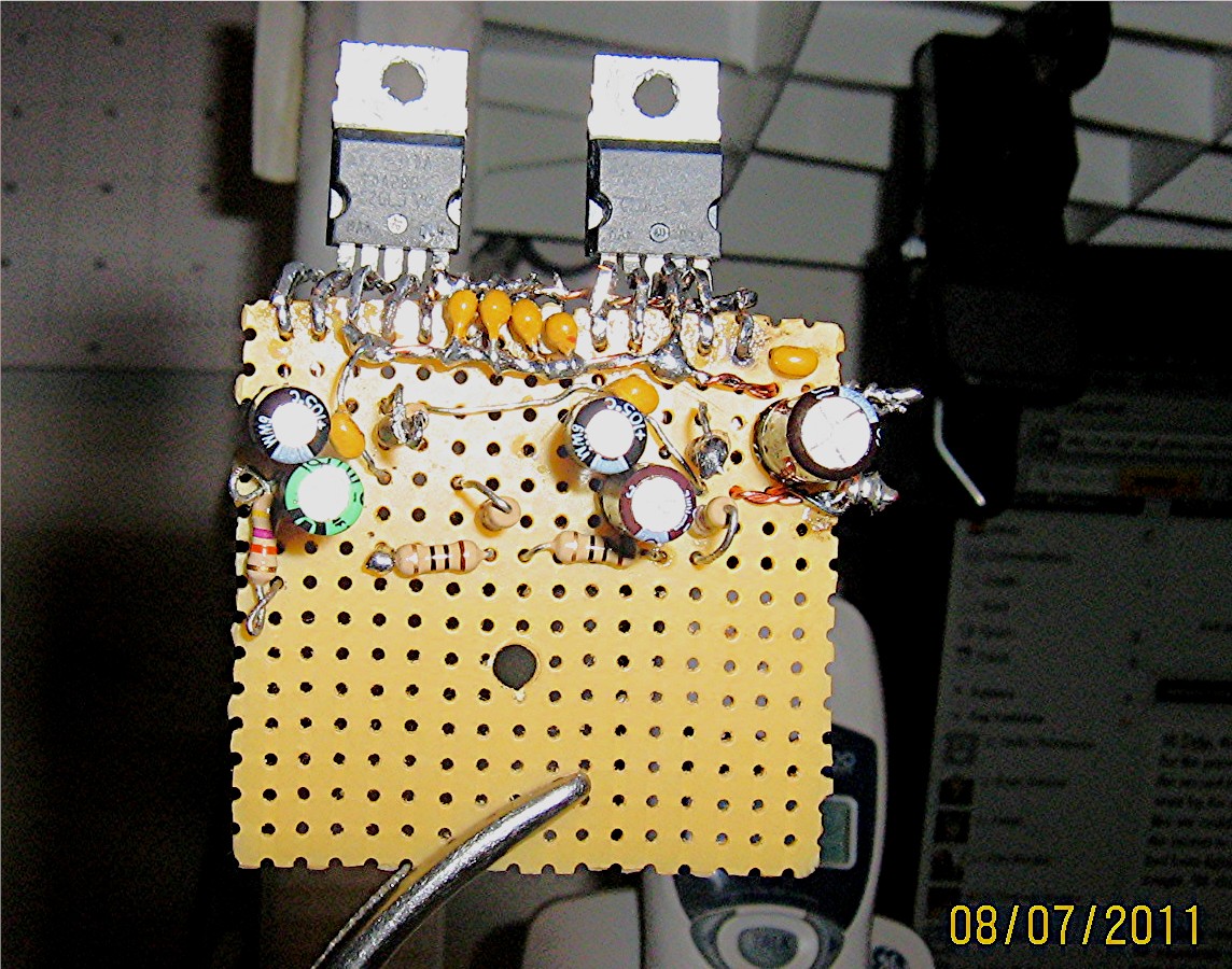

Hacked It!!!
For the second time in about 30 years, working with the LM383 / TDA2003 line of "car radio" amplifier chip amps, I came up with one that was stable, no oscillation!!! The first time I had a stable amp and did not know why and also didn't document that circuit, in the early 90's. Raymond Haigh's explanations and circuit board art gave me all the insight I needed to identify and correct all of my grounding issues. I ended up using 3 grounding systems in my amp, one for the DC power and speaker RC network grounds, one for the feedback components grounding, and one for the input ground on each chip, when I translated to perf-board!
Raymond Haigh on chip amps: http://www.transkommunikation.ch/da.../audio_circuits/Diverse%20NF-Verst%E4rker.pdf
2 X TDA2003 amp, about 10 Watts RMS, onset of clipping
into 4 ohms, 13.8 VDC powered.
Congratulations Edgar!
I used to destroy speakers using TDAs 🙂 lots of fun around 18years ago... when I was 16... then I discovered LM1875 and fell inlove with it... 🙂
Great PDF as well... thank you for sharing.
Now They Tell Me!!!
Ha! I went to the datasheet for the LM1875 and it also gives all that great information on grounding and stability concerns. Too bad NS didn't include the info in the LM383 datasheet! It would have been great to know that stuff 30 years ago!!!

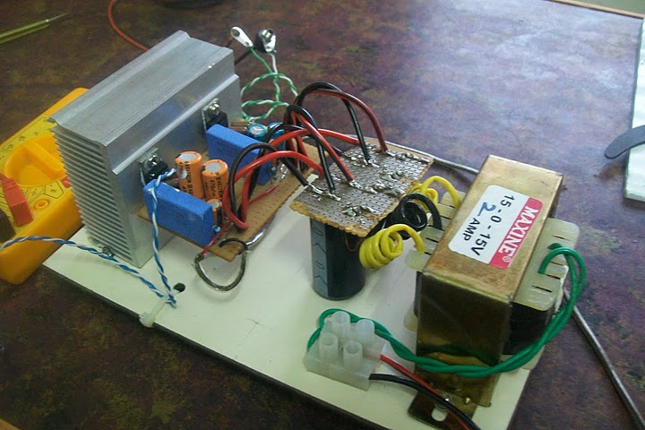

My first LM1875 for my PC system

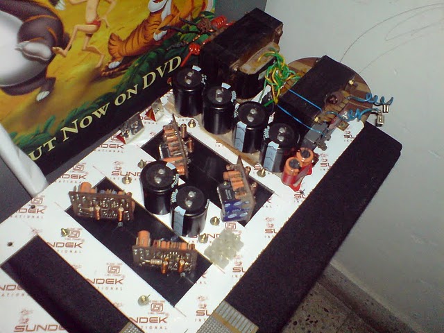

And my LM4780 based 5.1 setup in progress...
More pics -> https://picasaweb.google.com/103346623669691743811/Sub#
Will update the complete build shortly. 🙂
A PC heat sink without a fan is less efficient than just a 8"x4" square of heavy gauge aluminum plate.
The fins are too dense to allow for efficient convection.
The sink should also be turned 90 degrees so that the fins are vertical to have any hope of convection...
I didn't know that.. thanks!
Ya definatly, i'll be used cooling fan also once installed in PC cabinet 🙂
The heatsink is meant for force cooling.
