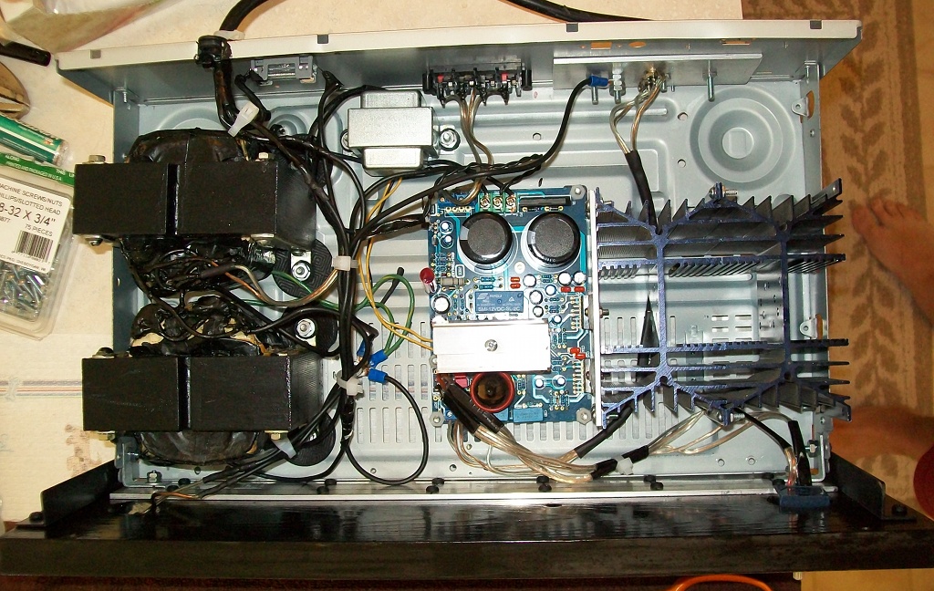

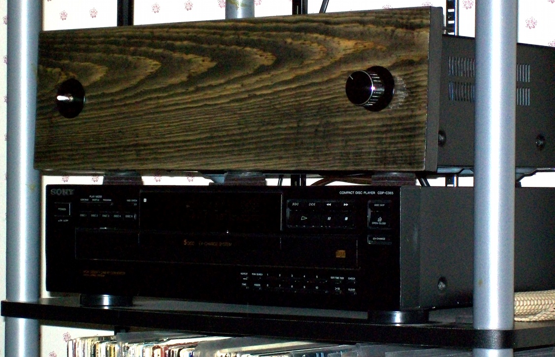

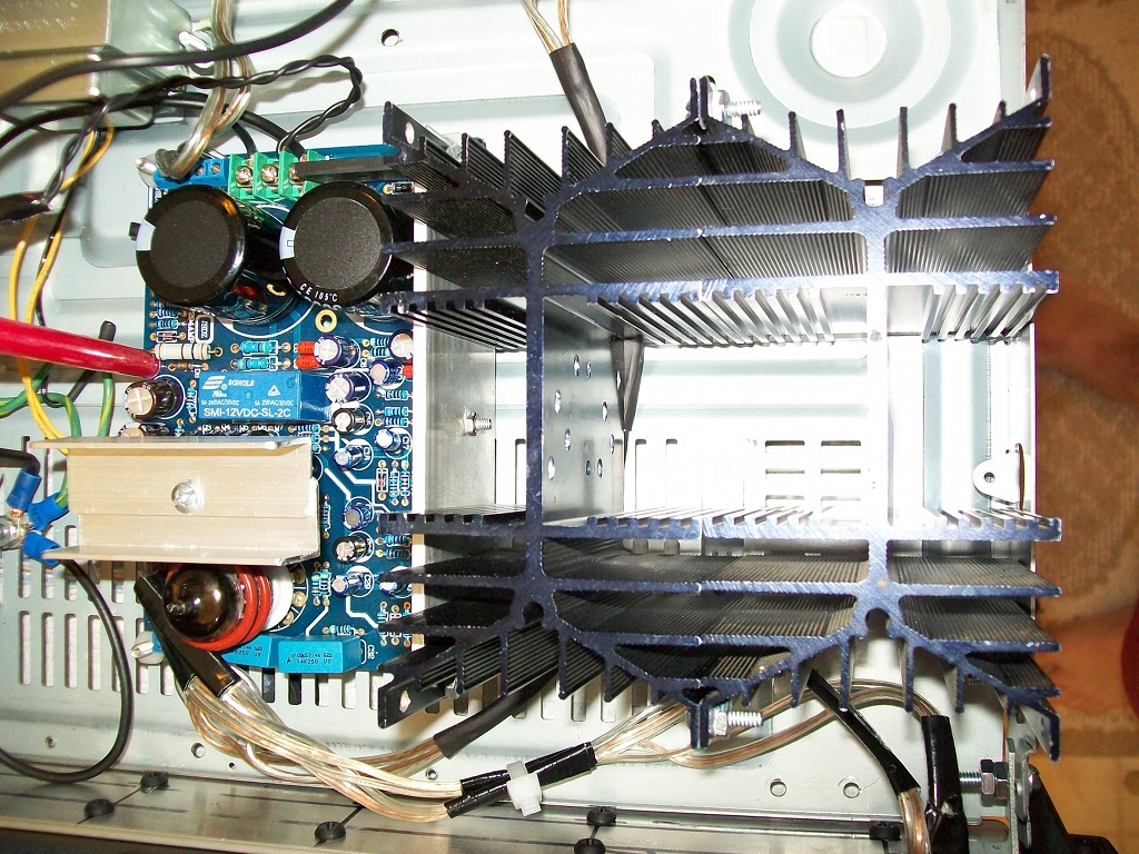

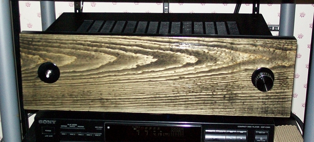

Thought I'd add my pics of my latest project I just finished. It a tube driven TDA7294 chip amp built from a Chinese eBay kit. I used two identical 24 volt transformers I've had sitting around forever. One for positive voltage and one for the negative, center tapped externally, and a Rat Shack tranny to power the tube. I replaced the Chinese tube with a NOS 5670WA. I used a dead Sony receiver for the case and built a simple front end out of cedar board. I used one of those fake ALP's stepper pots for the volume control. The amp can be driven to ear bleeding levels straight from a CD or phono preamp without a preamp. I'm probably going to drive it with a old NAD 1300 preamp ,I'm restoring, so I can use more than one input at a time, until I build a tube preamp to go with it.
