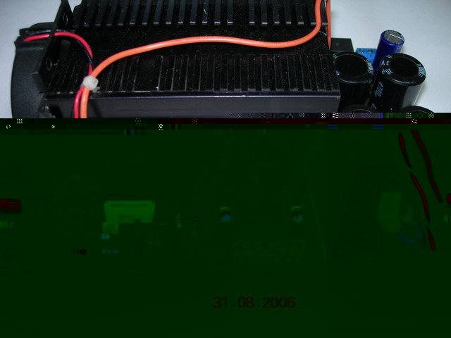

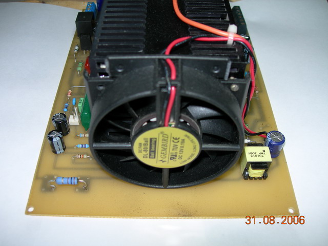

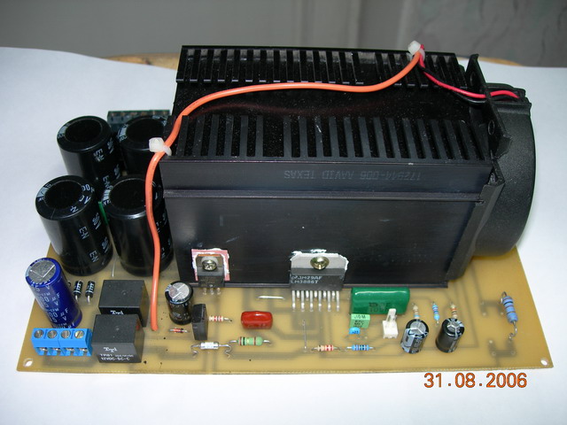

The area of radiators is too smallFastEddy said:... The Fan ... does it ever come active?? Wondering if it is actually needed.
It is compensated by thickness of pathsMick_F said:Hmmmm. I think the feedback path is far too long and the supply caps are too far from the chip.

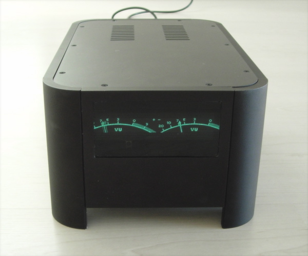

This is my Gainclone project. I designed my own PCB and build an alu case from scratch.
The amp has an external power supply, as can be seen at the photo's.

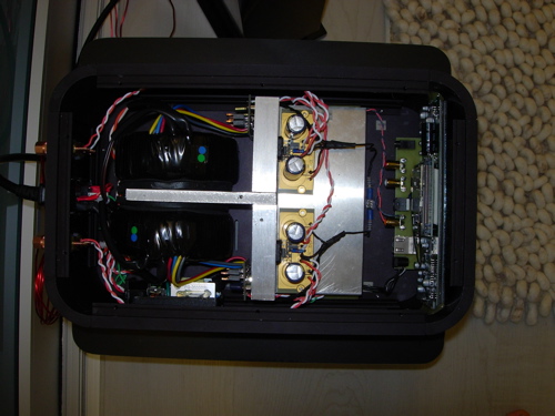

This was my first gainclone... a single integrated component. The chassis houses LM3875 bpards (Audio Sector), a NOS DAC (also audio sector) and a digital audio receiver by squeezebox.
The amp uses two PLitron toroids (120 V 22VAC). The case was manufactured by
Hexateq AV and i applie the custom black anodize finish on this end.The sound is clean and fast. I am a little dissapointed in the gain so i may investigate a buffer section.
It is still burning so i wwill wait before i pass judgement, but so far i like what i hear.
Thanks to everyone who lent there hand, Peter Daniels, Richard Krolla and the community at DIY audio.
