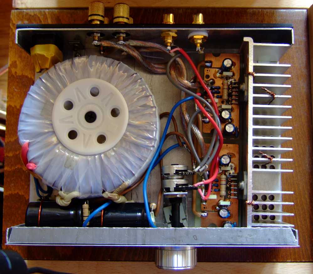

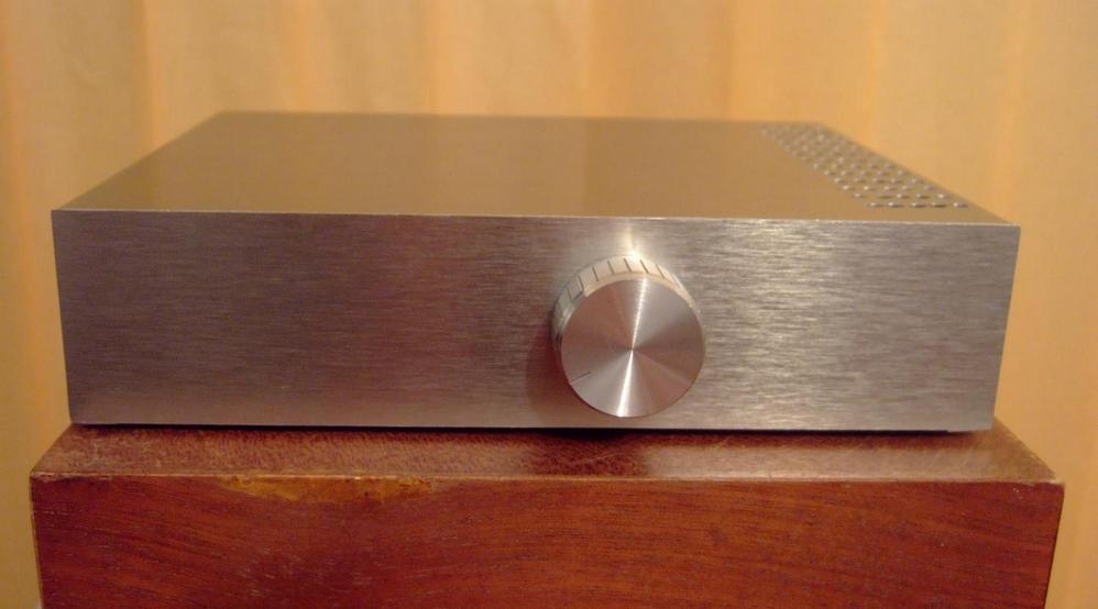

Finaly finished my litle gain-clone project.It is a stereo setup with 1 lm3886 per chanel. My goal was to make it as small as possible and as simple as possible while having a built in transformer. The simple part i think i got right, beeing that i did not put in even a power switch 😀. The pcb-s for the project are based on the ones made by BrianGT(thank you). The case I built is 21 cm(W) x 16 cm( L) x 4.6 cm(H). Its made from aluminium. Regardind the sound....like all gain-clones I believe...excellent.
marckus said:Finaly finished my litle gain-clone project.It is a stereo setup with 1 lm3886 per chanel. My goal was to make it as small as possible and as simple as possible while having a built in transformer. The simple part i think i got right, beeing that i did not put in even a power switch 😀. The pcb-s for the project are based on the ones made by BrianGT(thank you). The case I built is 21 cm(W) x 16 cm( L) x 4.6 cm(H). Its made from aluminium. Regardind the sound....like all gain-clones I believe...excellent.
Do you have pictures of the inside of this please?... it looks very very good on the outside!
Thank you! Here are some pictures of the interior.
The transformer is a bit on the small side (120VA) but it does it's job. The heat sink is kind of small...it does get quite hot when i turn up the volume ...about 60-70 degrese C , but the case takes away some of the heat. Considering that the lm3886 has thermal protection i'm not worried.
The front part of the case is made from a piece of thin(but very nicely machined ) aluminium about 0.5 mm thick epoxied to another thicker piece of aluminium.
I'm planning on adding a litle LED on the front somewhere, so i do not forget it turned on, and possibly a power switch.
