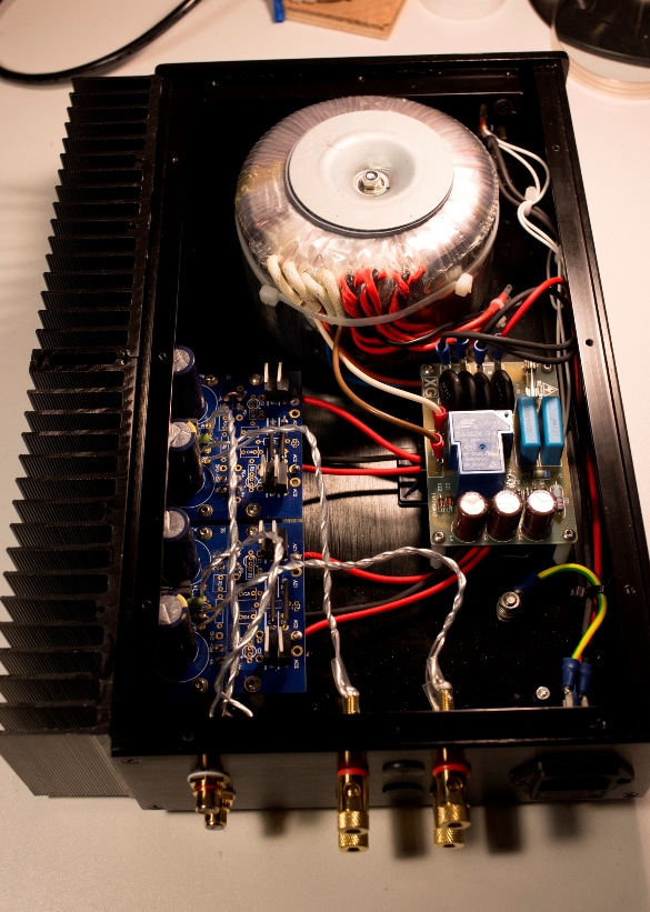

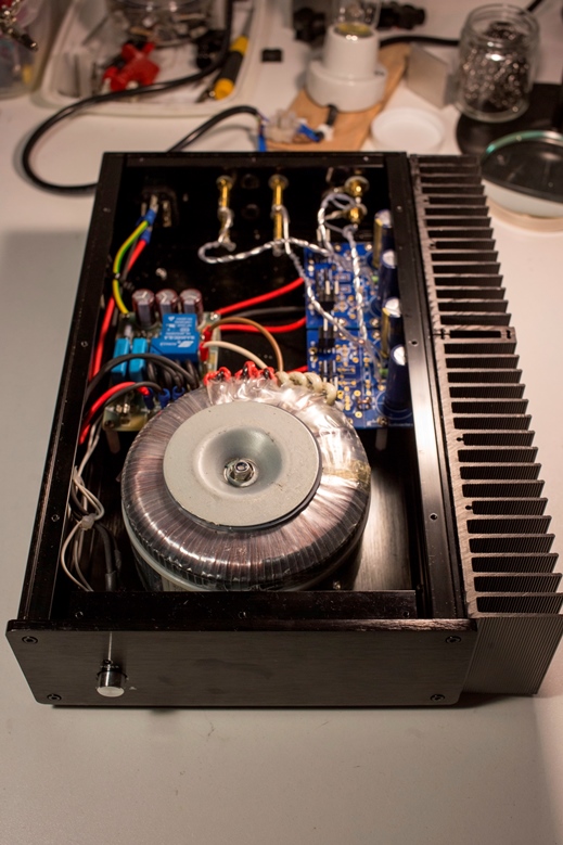

I just finished a first playing state of a Peter Daniel’s premium LM3875 Amplifier Kit. This one has a dedicated rectifier board per channel and unusual single 400Vac with centre tapped secondary windings, which I salvaged from an old Rotel power amp. Peter advised me not to use a single transformer, for the risk of getting a hum problem with two rectifier boards, but since I already had all the parts I gave it a try anyway. Fortunately I didn’t notice any hum yet. To use centre Tapped, means only using 4 diodes per side instead of eight. I also put in a slowstart board, which I’m not sure is needed but at least turning the amp on/off creates no audible noise which is what I was after.
This is my first experience with a Gainclone (and only the second amp I ever build from scratch) and I can already tell this is a seriously good amp, maybe a bit relentless even, I had to plug in my old speakers which are less analytical to keep things more musical. Obviously the new components still need to burn in but I’ve had a few goose bump moments allready.. 🙂
Thanks to everybody on this forum for inspiring me to build this amp.
For people still on the fence about one of these. This amp is ridiculously easy to build, even I could do it & Peter Daniel’s Kit’s make it even easier (www.audiosector.com)
Here are some pictures. I went for this form factor to match my Audio-GD NFB-28 DAC/Pre-amp.

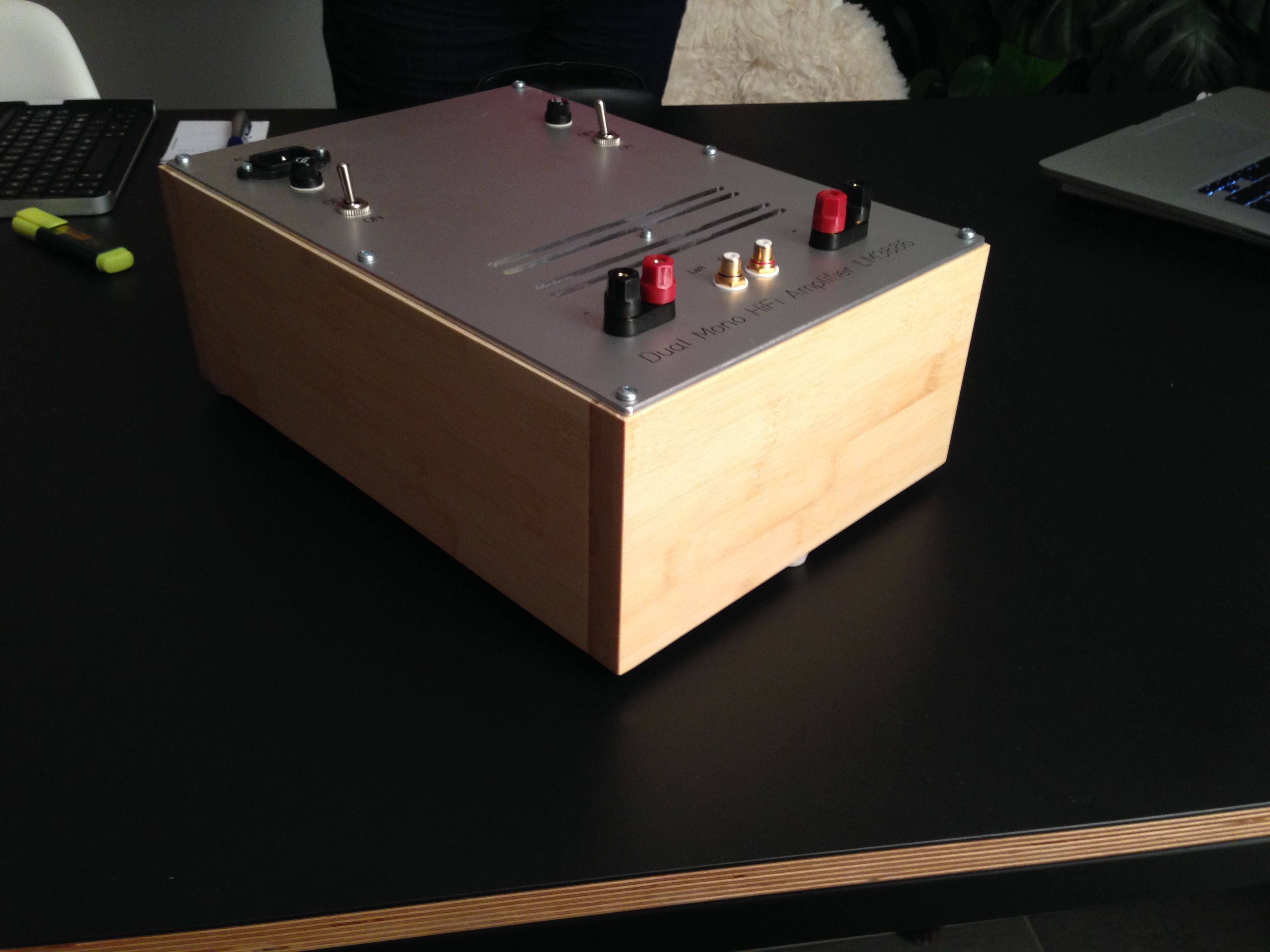

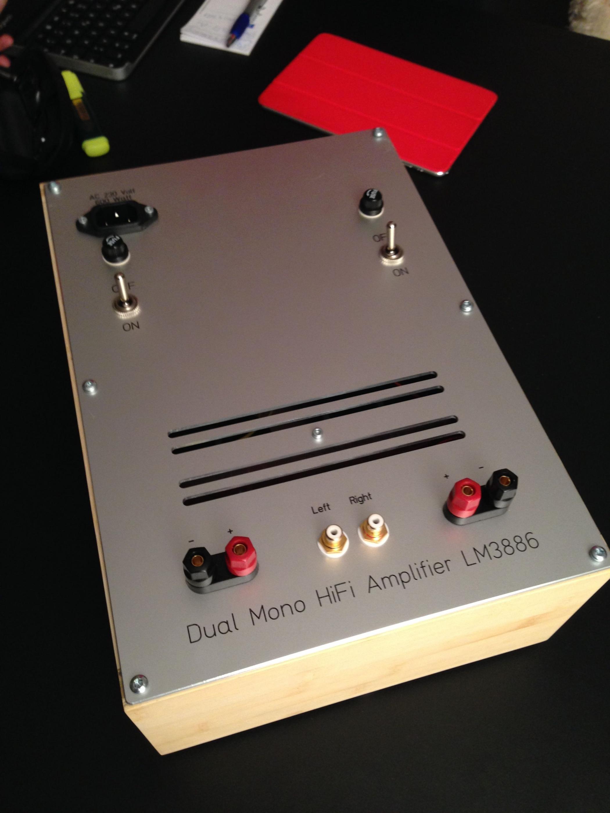

Kit is from chipamp.com, base case is bamboo and the top plate is 3mm aluminium.
Michael
Nice, looks smart and purposeful.
