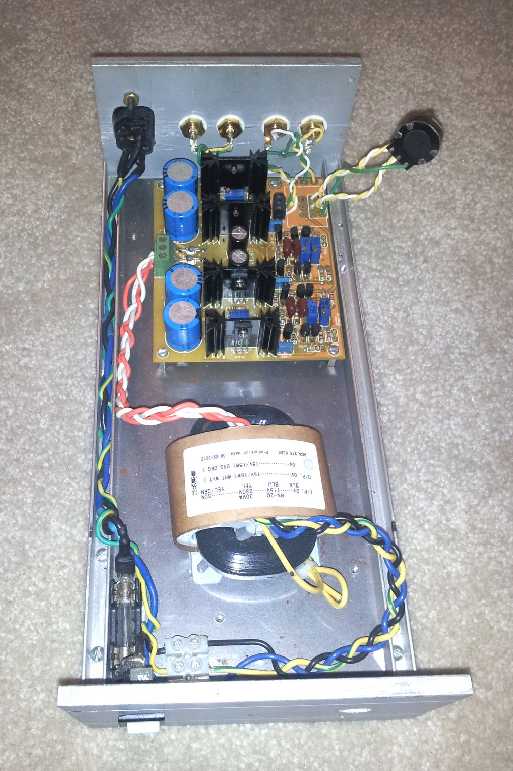

WoW! I clicked on the second pic and a toroidal the size of an lp appeared 😀

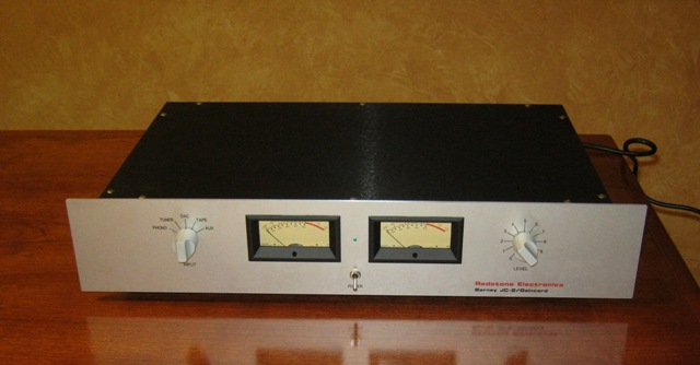

I have that same JC-2 kit and love it. I've never seriously considered another pre since it was built. To my ears it sweetens the sound a bit without adding a lot of coloration. John called it a "straight wire with gain" and it does perform as such. In several other builds I use simple pot attenuation, but where gain is required the Jim's Audio kit excels.

And Cheers to you too Bob, funny that we should pick the same pre and power amp kit's. I was directed to that JC-2 kit by a guy on pink fish media's diy section because I had found the one by tubeshunter, it looked quite good so i was asking for opinions about it when someone linked to Jims Audio's version, better spec components etc swayed me.
After I had ordered it however, I did a search on here and came across a thread on the tubes hunter one which later also covered the one I had ordered. Whaleman seemed impressed with the Jims Audio version which was encouraging.

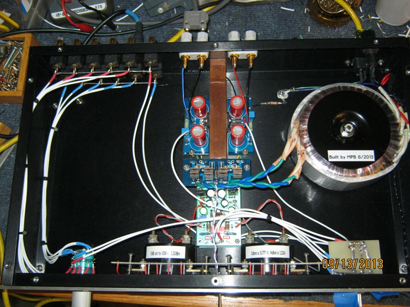

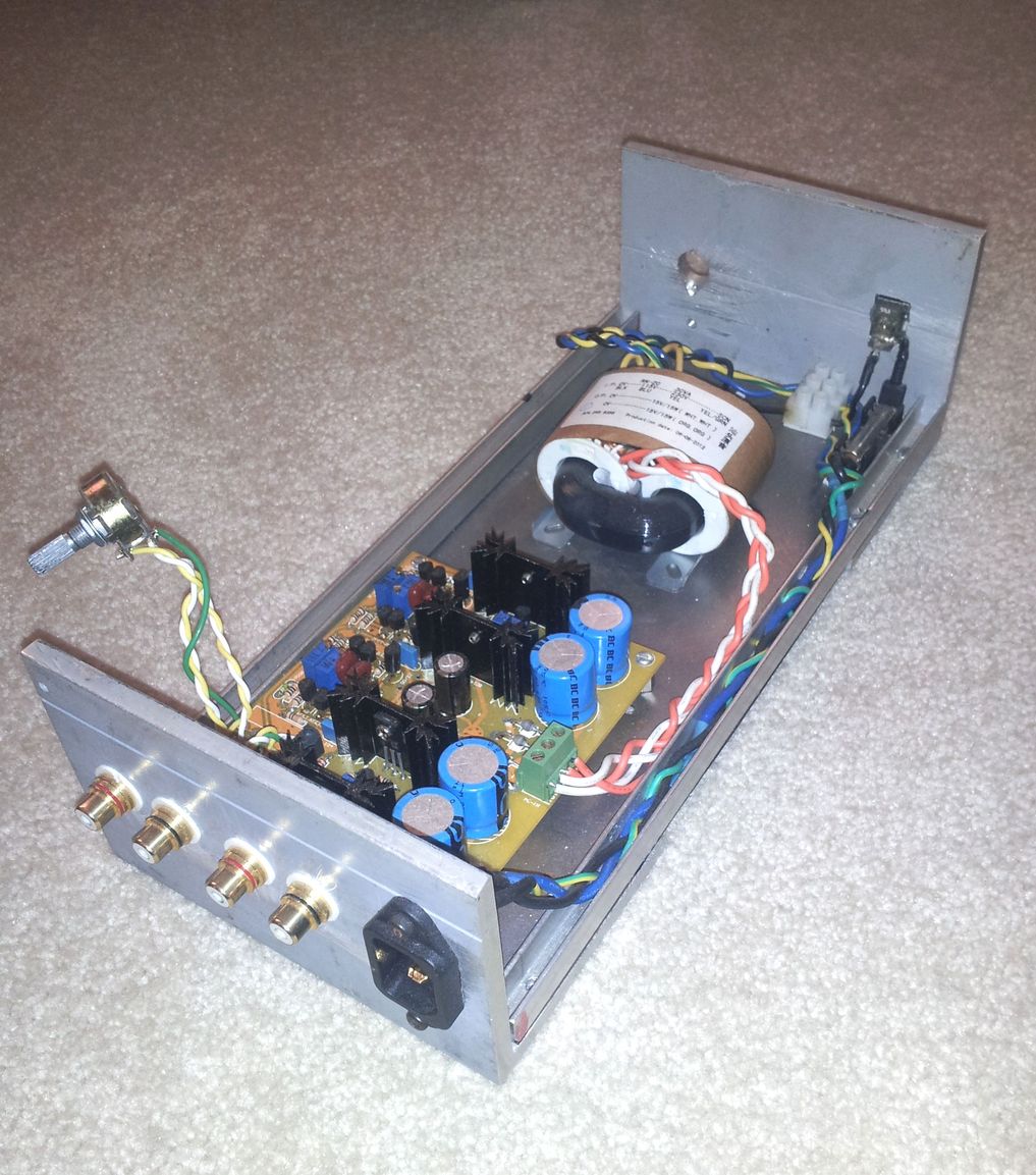

The pics are of the not yet completed (need pot shaft & cover) separate unit build I'm using now. The R-Core transformer bumps up the quality a significant amount - not drastic but well worth the cost..

Looks good Bob! where did you get your enclosure?
The resistor replacer is interesting too, I was going to try Riken's in that position at some point but before I try any mods I need to get some of those speaker posts which have grub screws instead of trying to solder and desolder to those large bolts with a 25w soldering bolt.
That pot looks like the ones I ordered from ebay, the sellers called gigawork in HK. How do you find them?
Edit, ah I see your a fine craftsman when it comes to enclosures too, nice work!

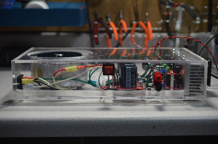

Here's my latest, the Mylo amp (named after my my baby)......
This amp uses an LM4780 chip mounted on one of Peter Daniel's boards. Powered with a 120VA 2 x 0-15V toroid.
The A-B switch on the front allows you to select analogue input (A) or Bluetooth input (B). The Bluetooth module I'm using isn't pictured as I blew up my current one, but it attaches to the 6 way dupont connector which can be seen in picture 3 and slots into the oak side to allow it to receive the Bluetooth signal. The heatsink was acquired from an old variable speed drive.
Again, the sound quality from this amp paired with my full range speakers is as good as expected. The LM4780 chip never fails to impress 🙂

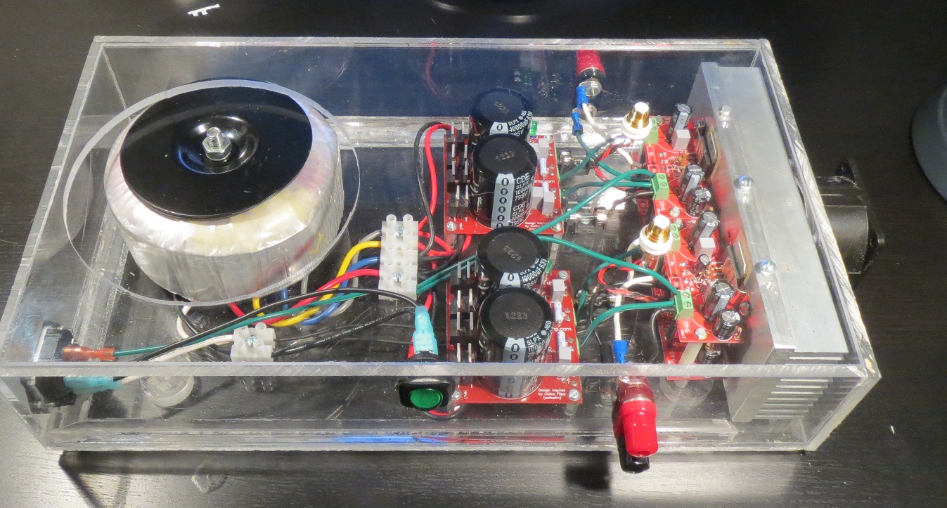

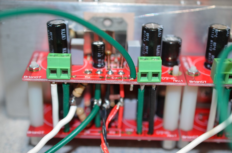

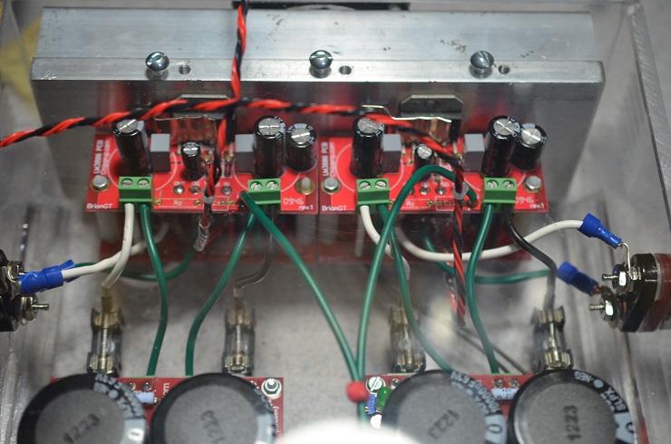

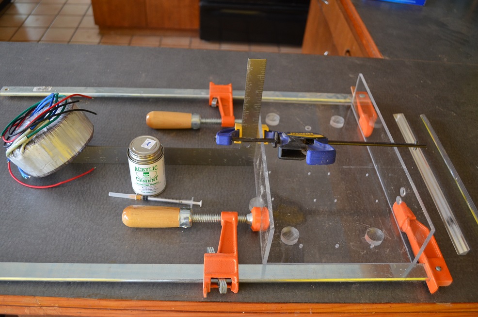

another paralleled LM3886 build
This is a two channel amplifier made from paralleled LM3886's. I used one Chipamp.com board from Brain GT for each chip, then put the boards in parallel. This matches very closely schematic 6.2.1 (PA100-100W parallel circuit) in National's Application Report AN1192. I omitted Cin and Rin is off the board. Rout has one end connected to each board, which can be seen in the close-up photo of the boards. Rails are +/- 34V for, 116 Watts into a 4R load.
The chassis is not the prettiest thing ever. It's my first time working with acryllic. The big hole in the top was from when I had a larger transformer, and will probably be replaced.
