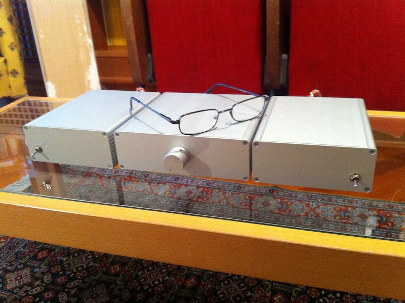

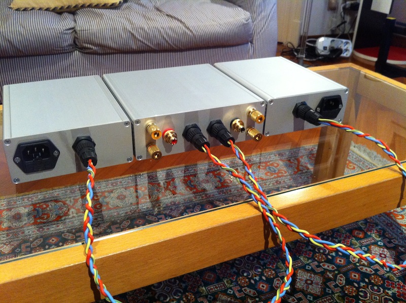

My LM3886 Chip Amplifier
The implementation concept is from the Gaincard, one power supply unit (2x24v a.c 150VA, EI transformer), and one amplifier unit (Stereo). Overall filter cap 8800uF (2200uF in Power unit, 6600uF in the Amplifier unit). The two units are linked by a OCF three wires power cable (detachable). Some photos to share
Final product
:cheers:

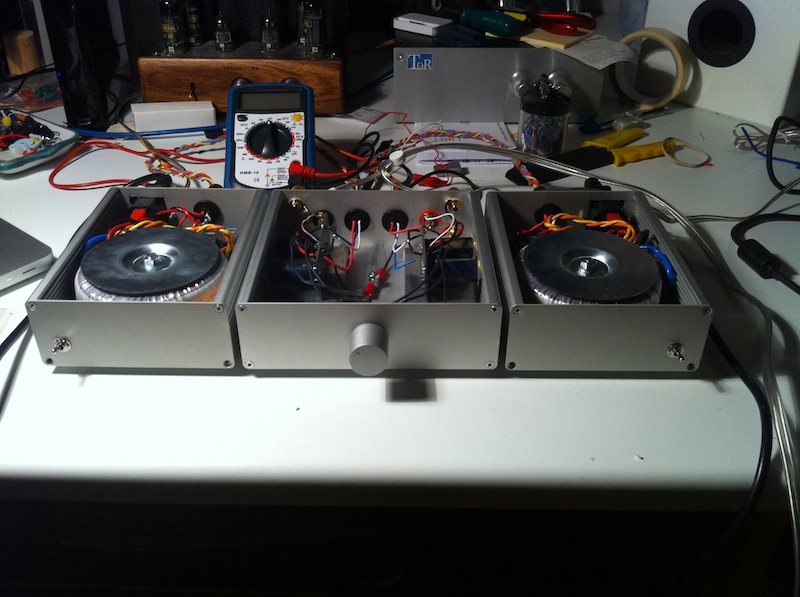

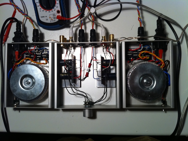

This is mine
nothing special, but I like to show you.
LM3875 Audiosector premium kit;
dual mono configuration with stepped attenuator similar to the original 47 Labs Gaincard;
2 trafos 160VAx25V.
It sounds great!

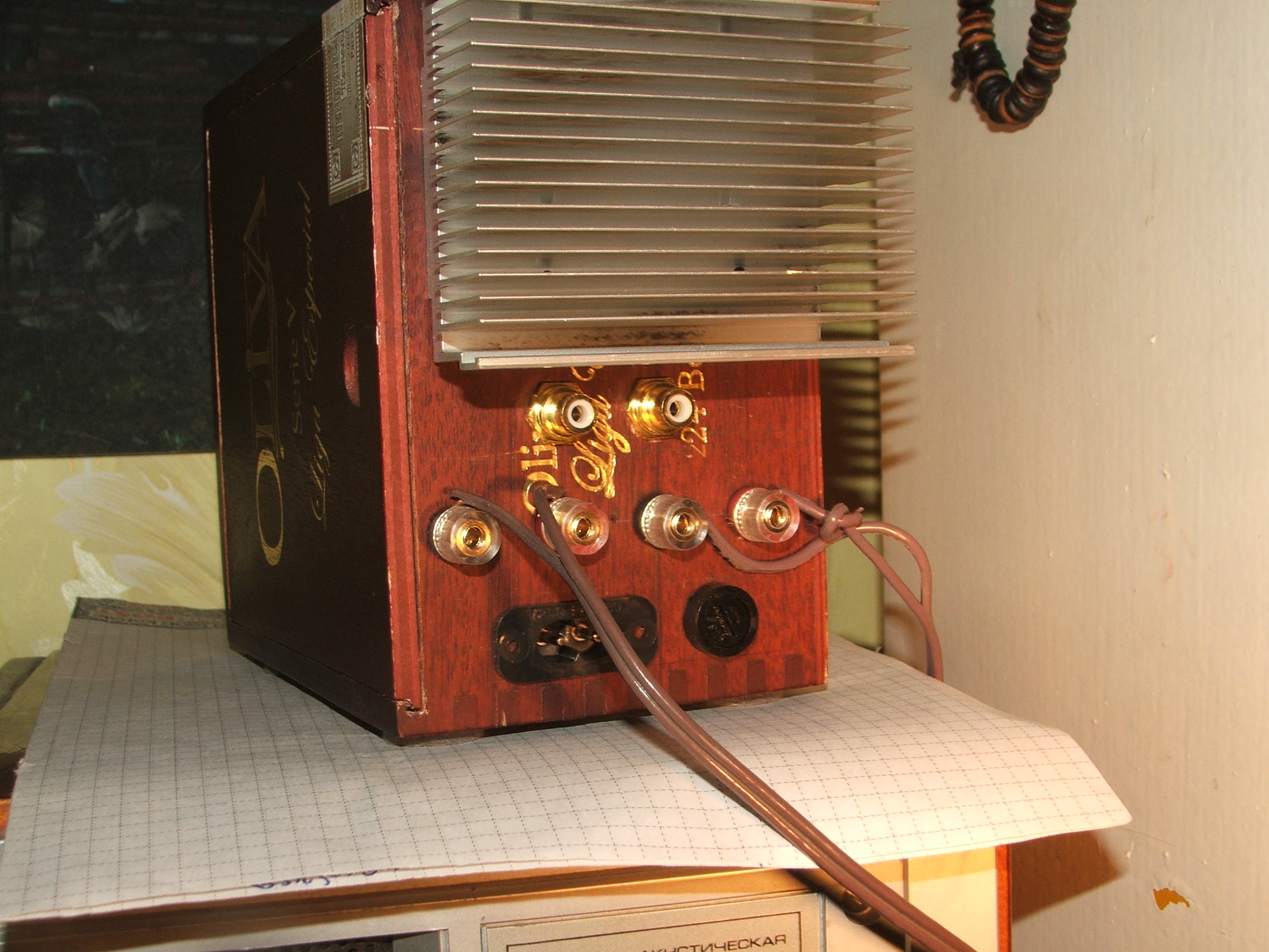

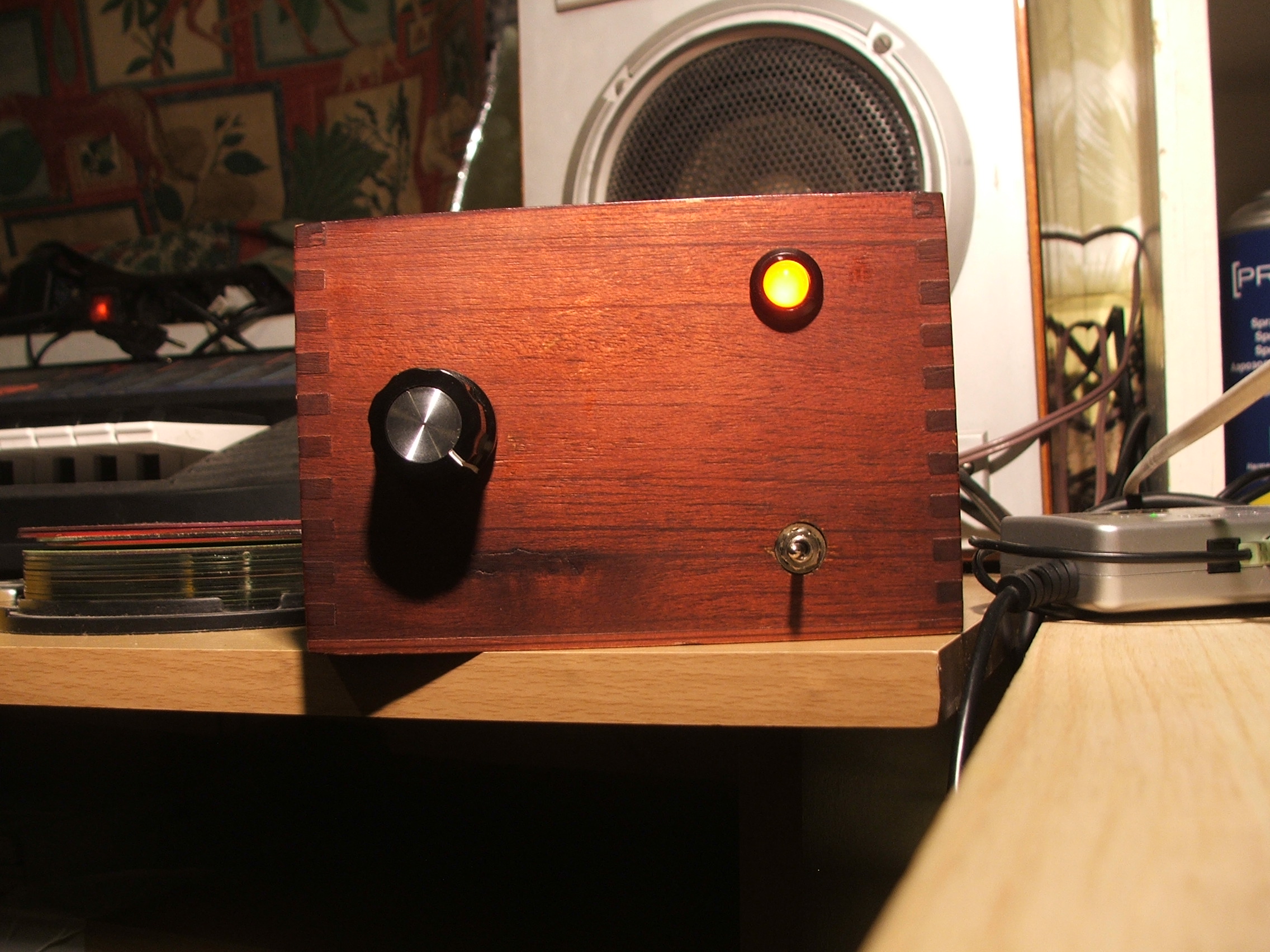

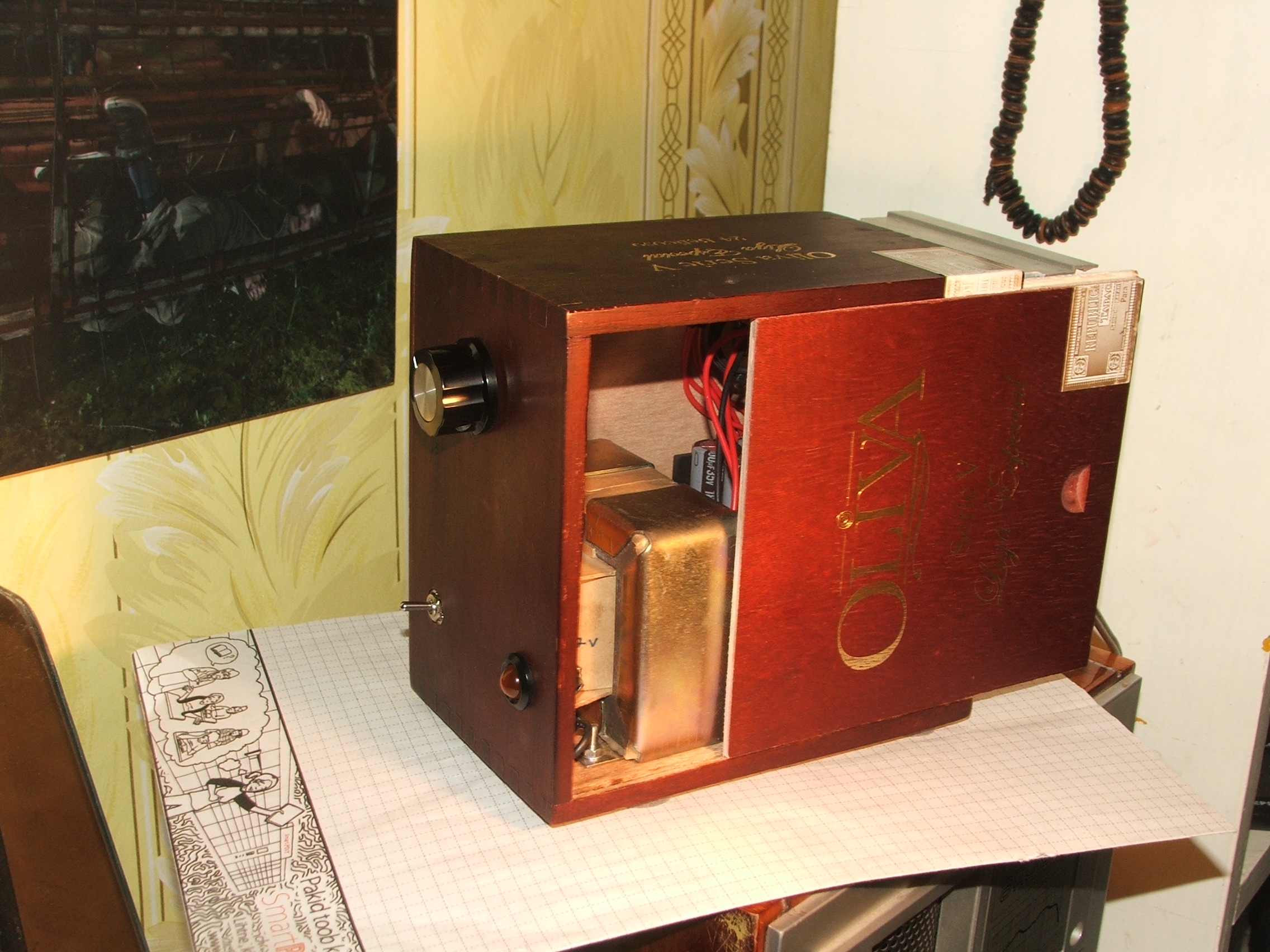

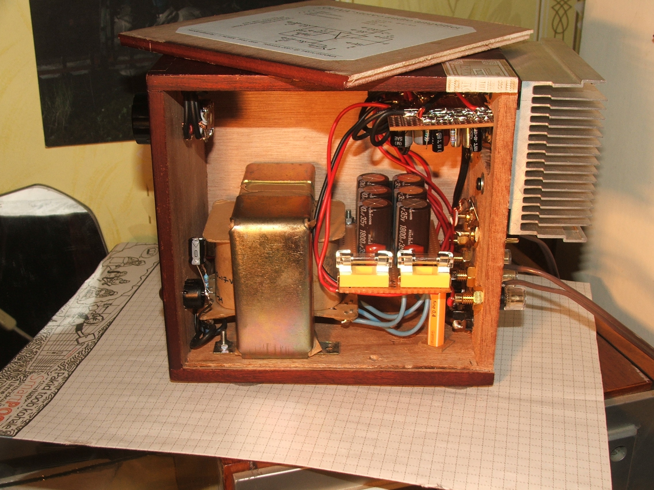

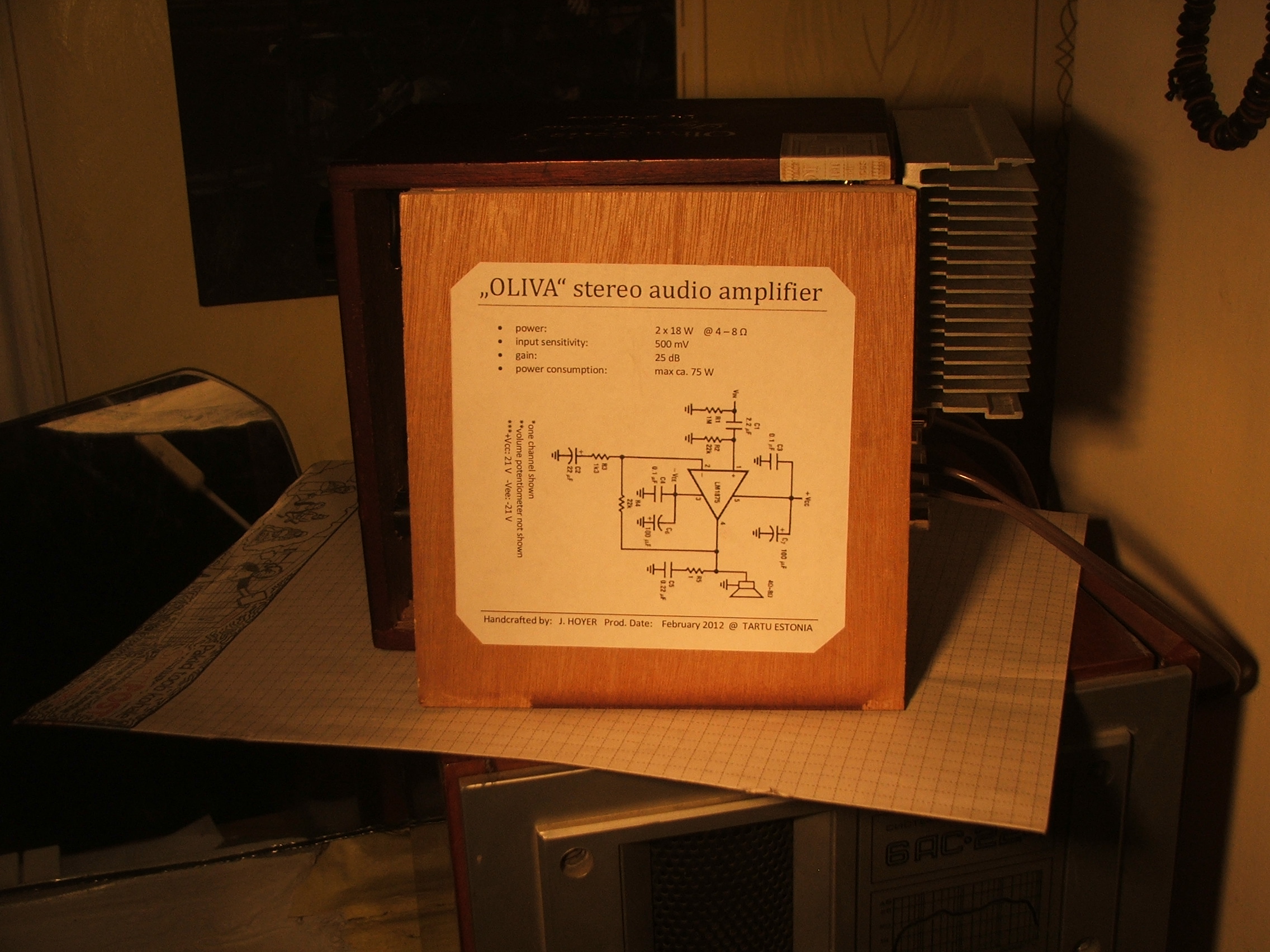

LM1875 stereo "Oliva"
Here's the LM1875 stereo amplifier I built for my close friend last week. It follows a RETRO style with bakelite volume knob, tumbler power switch, 10mm amber led and all enclosed by cigar box. Led has separate transf. winding with half-wave rectifier. There's a heatsink salvaged from old PC that stays cool while listening on moderate levels with 4Ω speakers. PSU has 6 x 1800uf capacitance. Transf. salvaged from some USSR equipment.
Main problem was fitting all components in that very tight enclosure. I am very pleased with the results, both aesthetics and sound quality are good. Very low level audible hiss.
Heres some pics:
DSCF2552.JPG DSCF2542.JPG DSCF2545.JPG DSCF2546.JPG DSCF2550.JPG DSCF2557.JPG

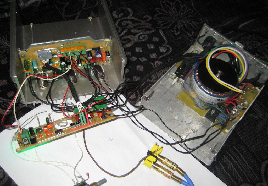

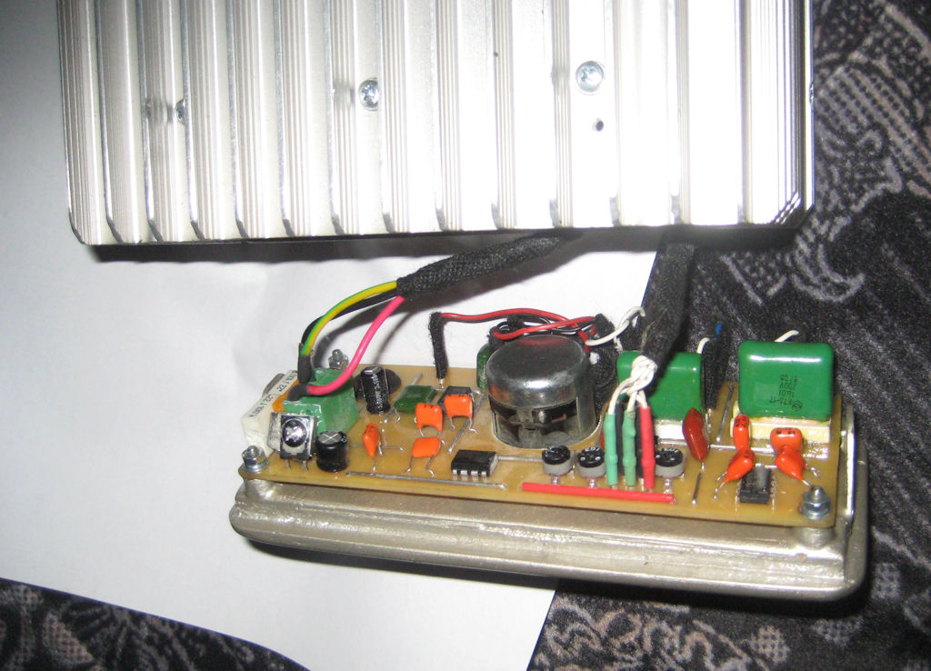

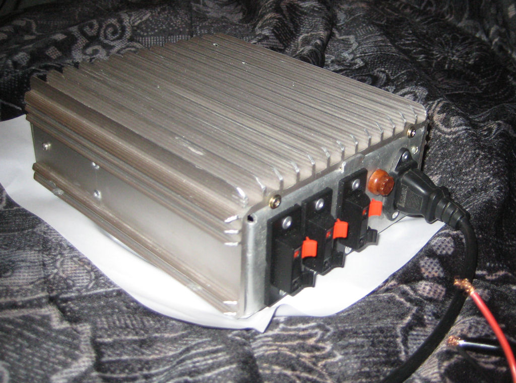

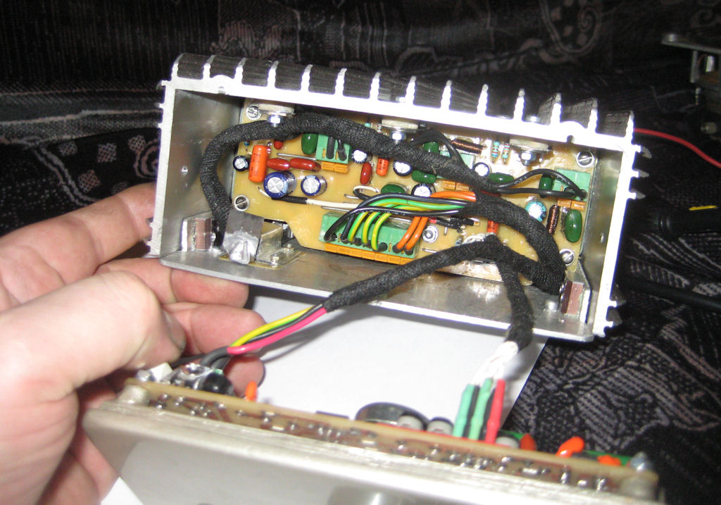

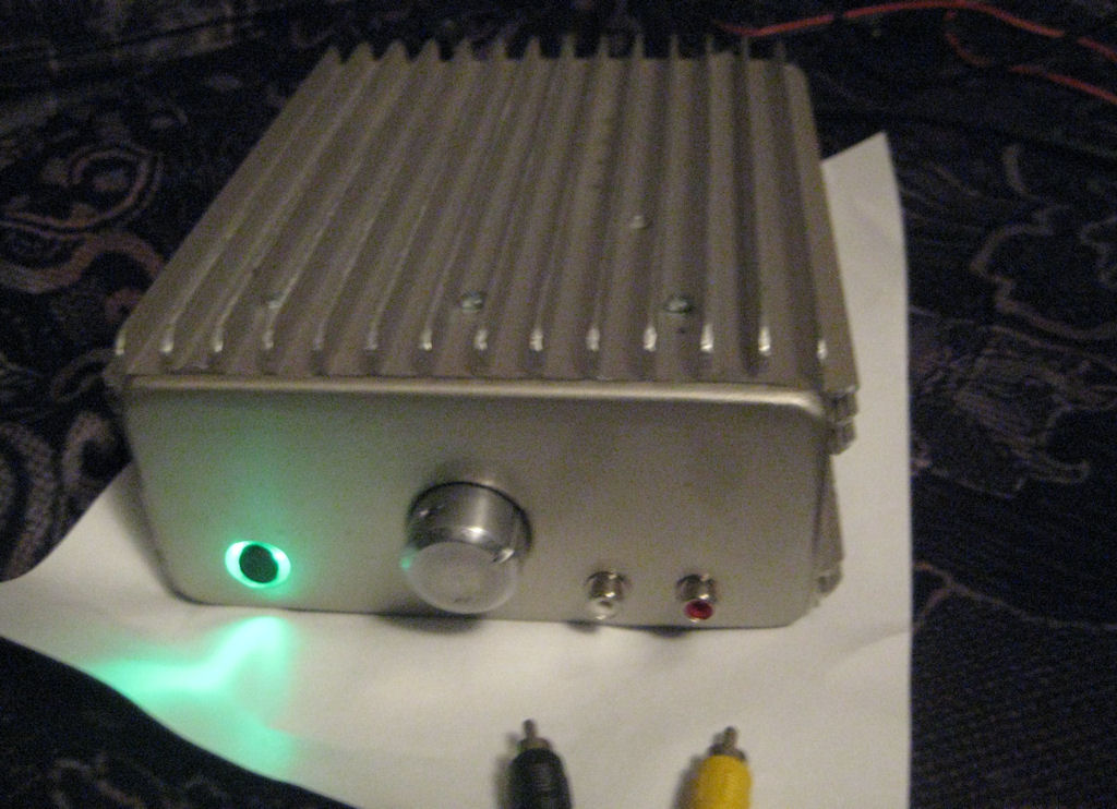

While I have them, I think I can share these photos.
Some time ago I built this toy for my work room and wasn’t interested in fine finish.
Heatsink was taken from blown DC/DC converter.
3 channels TDA2050V. Bipolar power supply 2x18V.
Two channels are high-passed by 2nd order 80Hz for 5.25 coaxial speakers.
One channel has the 4th order 80Hz low pass filter and used for similar, toy transmition line. (1.8 meters cardboard tube with 5.25 mid-woofer).
Pre-amplification and filtering were made with OP275GP op-amps.
I found these chips TDA2050V are not very stable. Initially, the amplifier was working, but there was problem with light instability in idle mode and post-oscillation caused by EMI from speakers. Instability was cured by capacitor in parallel with 22kOhm resistor, connecting the positive input with ground. And signs of post-oscillation were eliminated by replacing 2.2ohm resistors in zobel network by coils. Coils are approximately 5mkH, 60 turns of 0.5 mm diameter wire , coil internal diameter is 1mm and wire is wounded in 3 layers by 20 turns per layer.
Only three parts here: heatsink with power amp, chassis with power supply and frontal panel with preamplifier, very easy to take all apart.
