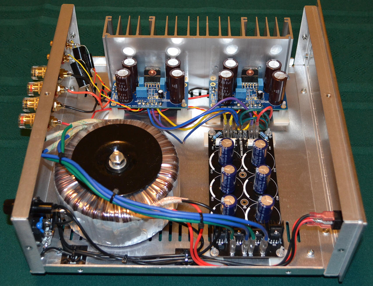

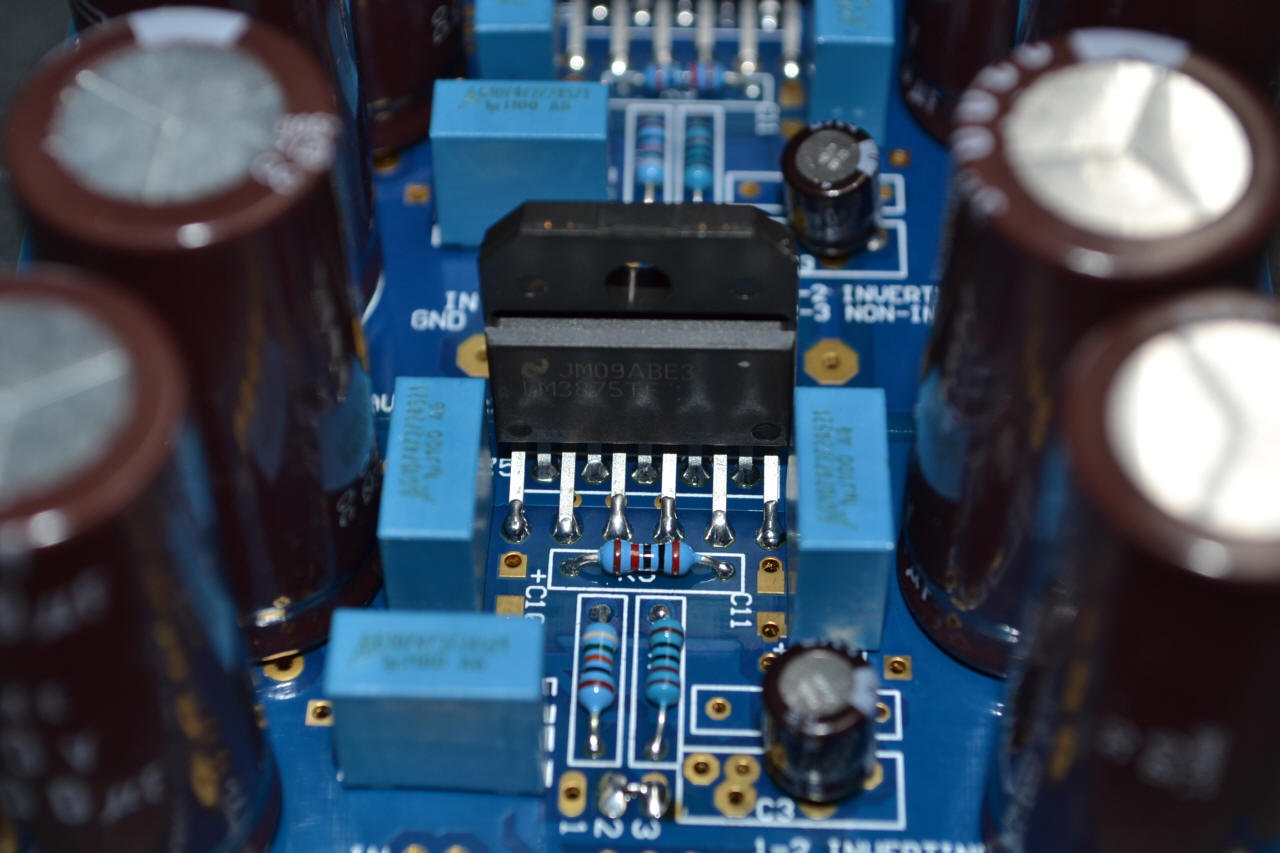

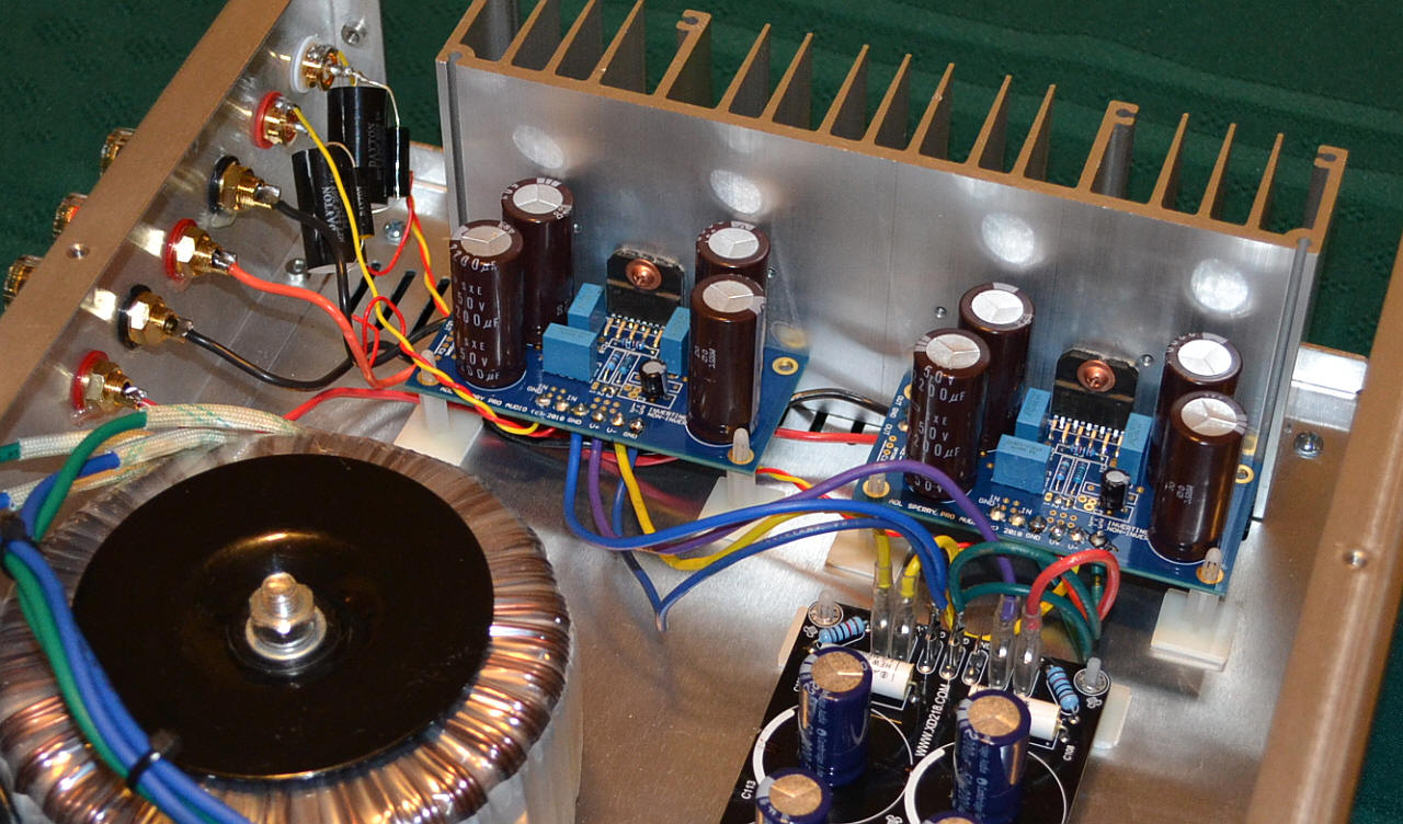

Here is a LM3875 based amp I just completed. The two amps boards came from eBayer audiosector in NJ, a very good quality kit.
Clean assembly Whaleman - where did you get the enclosure?![]()
whaleman...where did you get the heat sink???

Par-Metal 20 series
Thanks,

Very nice job whaleman ! I like those big input caps, I did it the same way but using Sonicap. I would use bigger caps for power supply at least 4.700uf 105c X 3 on each rail.

Hi Waleman,m
Your LM3875 doesn't look anything like the one from Audio Sector and he is from Canada, not NJ. Are you sure you are quoting the right board from the right Vendor?
Regards
I think there is another guy on ebay with that name. I bought some 'cheap' PGA chips from an audiosector ebay seller and I'm pretty sure its not 'our' audiosector guy from canada (peter).

That heat sink I think came from an Onkyo receiver I junked for parts.
Yes, agree. Those used to be 10,000, but turned out to be fake Nippon Chemi-con, so I tore them all out and had those 2200 uF laying around. Do you think I will hear a difference with bigger caps?

No, do not think is the man from Canada that posts around here, unfortunately...but he is eBayer audiosector in NJ, at least that is what is claimed.
These boards were quite nice, gold plated I think. But not the same person.

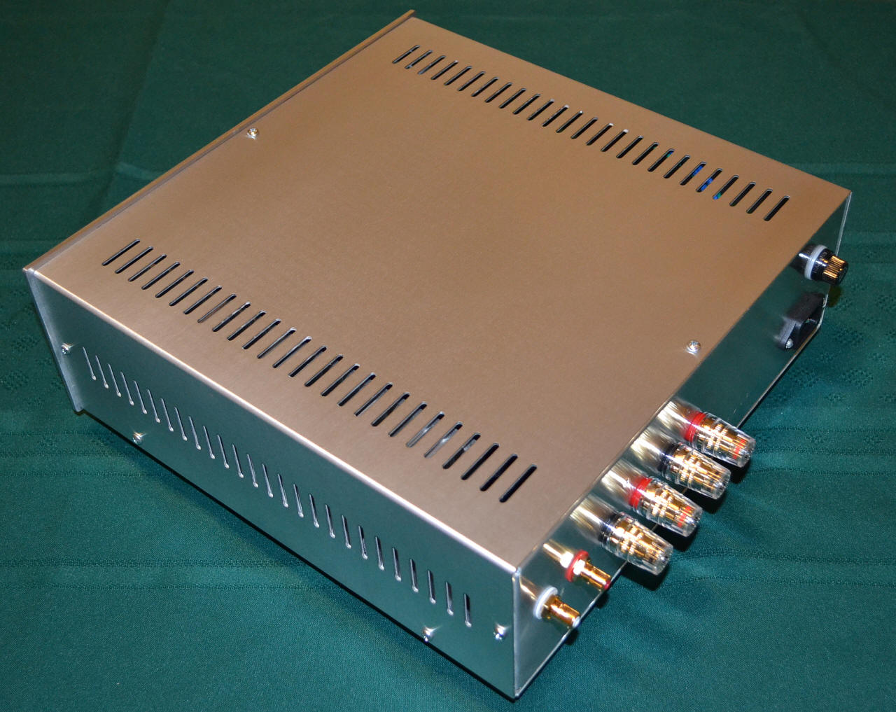

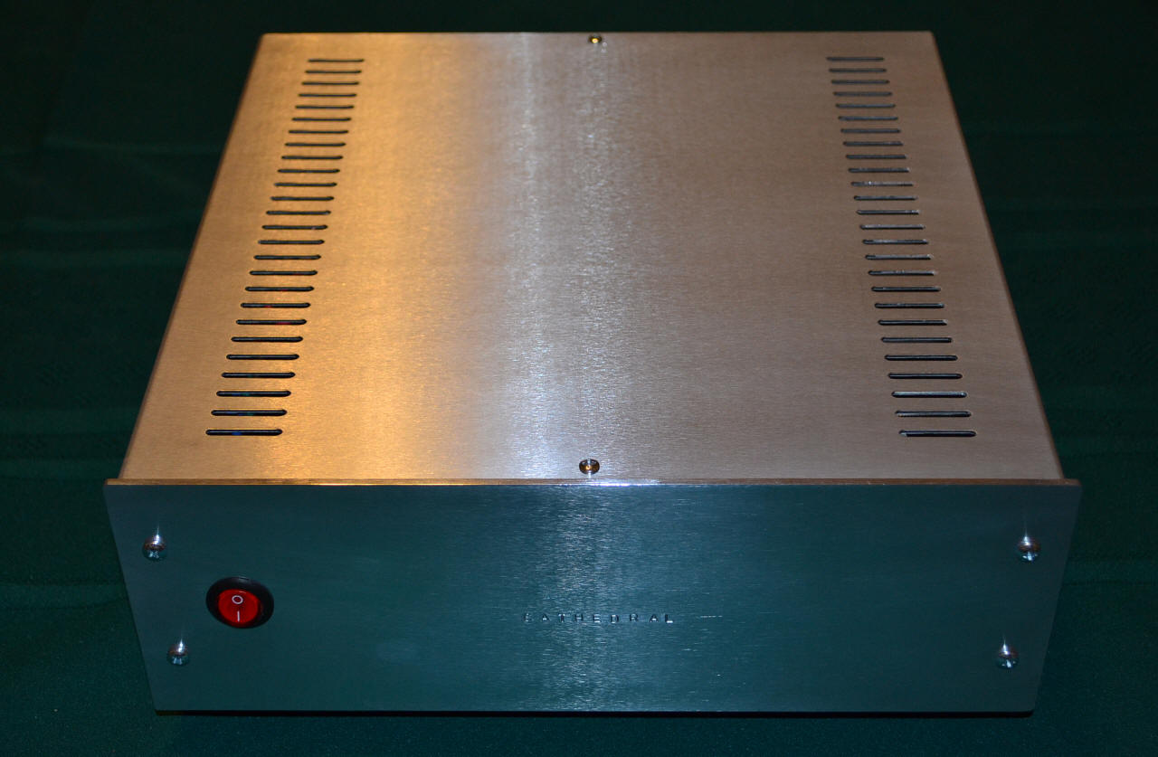

Audiosector LM3875, Antek 300va 22v+22v transformer, Par-Metal 12x12x4" chassis.
It's built exactly like the schematic right now, The case is kinda big so I have room to play with PSU configurations. There is no doubt I need to get a prettier power switch...
Initial impressions are very favorable! 🙂 🙂
Once it's all done in it's final configuration I will do a build thread.

Very nice! I recognize that case. Here is a nicer neon lit power switch:
SPST Round Rocker Switch w/Red Illumination 125VAC 060-716
