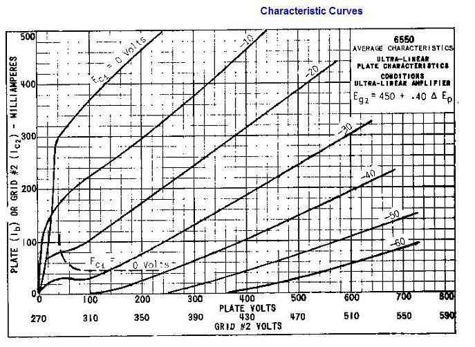

Here are the specs on the 6550 with the type of amp I want to build and a couple of applications. The curves for the tube I found online is attached.
Thank You,
Sal
NJ7P Tube Database Search
6550
Power Pentode
Base & Bulb ( RCA RC-29 - 1975)
EIA Base 7S
Application
Glass octal type used in the output stages of high-fidelity audio amplifiers. Requires octal socket.
Mechanical Data
Pentode
Input ......................................... 14 pf
Output ........................................ 12 pf
Grid to Plate ................................. 0.85 pf
Maximum Ratings (Design Center Values)
Pentode
Plate Voltage ................................. 600 V
Grid No. 2 Voltage ............................ 400 V
Plate Dissipation ............................. 35 W
Characteristics and Typical Operation
Push Pull Class A Amplifier
Plate Voltage ................................. 400 V
Grid No. 2 Voltage ............................ 275 V
Grid No. 1 Voltage ............................ -25 V
Plate Current (Zero Signal) ................... 180 mA
Plate Current (Maximum Signal) ................ 270 mA
Grid No. 2 Current (Zero Signal) .............. 9 mA
Grid No. 2 Current (Maximum Signal) ........... 44 mA
Load Resistance ............................... 3500 ?
Power Output (approx) ......................... 55 W
Push Pull Class A Amplifier (Triode Connected)
Plate Voltage ................................. 450 V
Grid No. 2 Voltage ............................ 450 V
Grid No. 1 Voltage ............................ -46 V
Plate Current (Zero Signal) ................... 150 mA
Plate Current (Maximum Signal) ................ 220 mA
Load Resistance ............................... 4000 ?
Power Output (approx) ......................... 28 W
Total Harmonic Distortion ..................... 2.5 %
Push Pull Class AB1 Amplifier
Grid No. 1 Voltage ............................ -23 V
Peak Grid No. 1 Voltage........................ 17 V
Total Harmonic Distortion ..................... 3 %

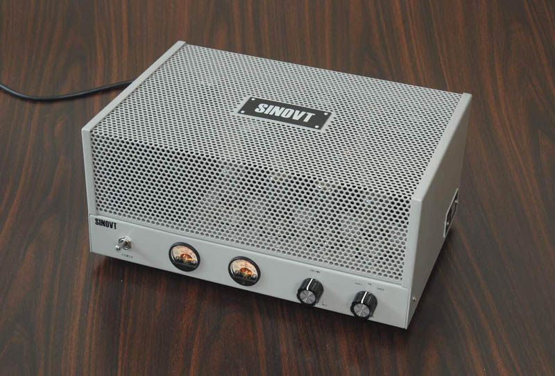

Olá BSGD
You can have a look at the work done by Ricardo, here is a picture of one of his amps. http://www.diyaudio.com/forums/showthread.php?postid=1185789#post1185789
They fit your need for power, seem to perform quite well, reliable and the stuff. But they will cost you somewhat more than a cheap chinese though. Still cheaper than an Audiopax, I imagine...
Good luck in tubeland, Erik
I am a brazilian, and know Ricardo from a yahoo discussiongroup called justtubes.

ErikdeBest said:Olá BSGD
Thank you very much Erik, I just sent Ricardo an e-mail.
BTW, do you know Ricardo's e-mail? Thanks.
