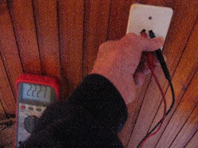

Ok. 222.7 is VOLTAGE, not CURRENT.
It is an effective voltage while an amplitude is 1.42 times higher.
