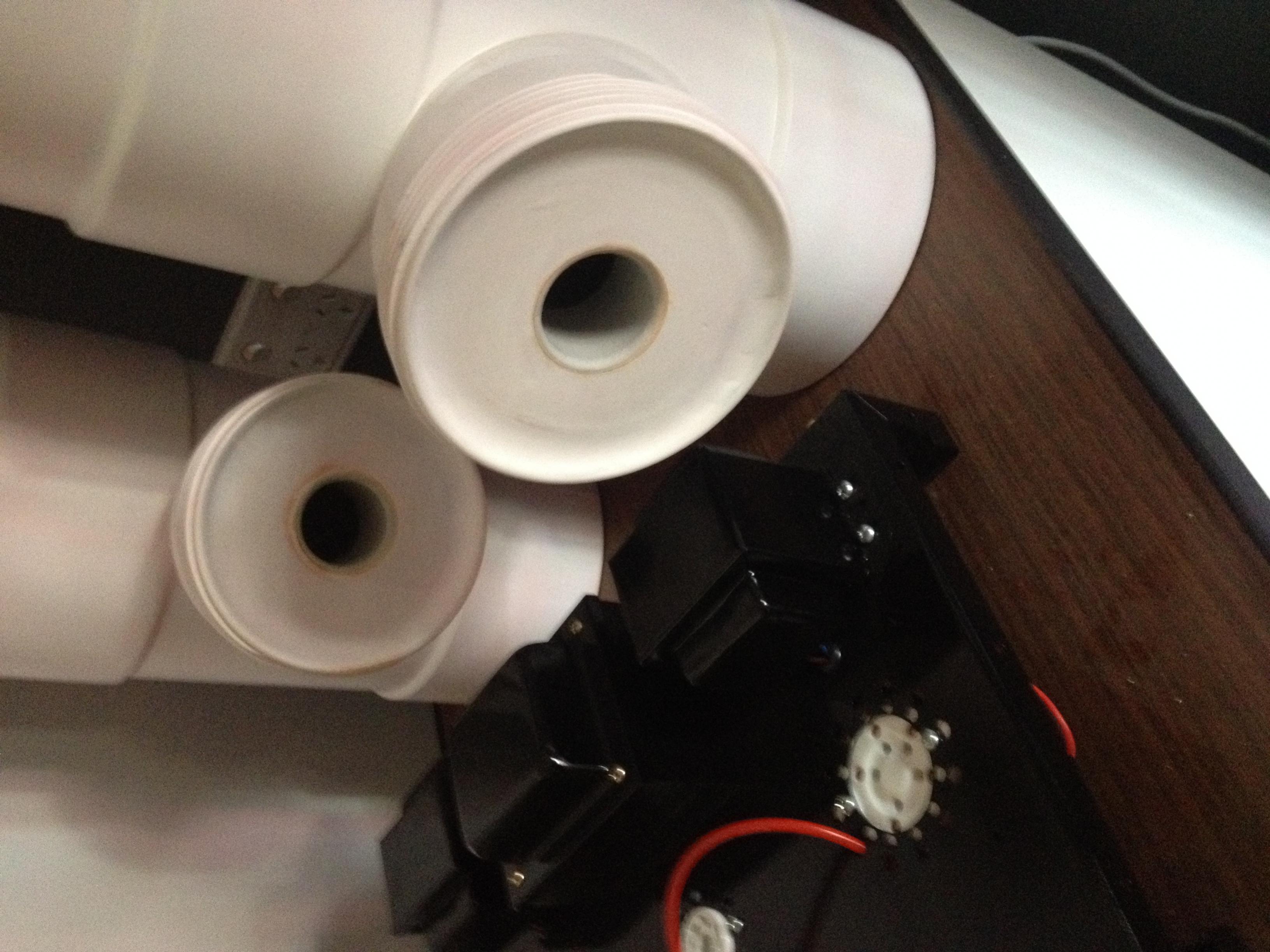

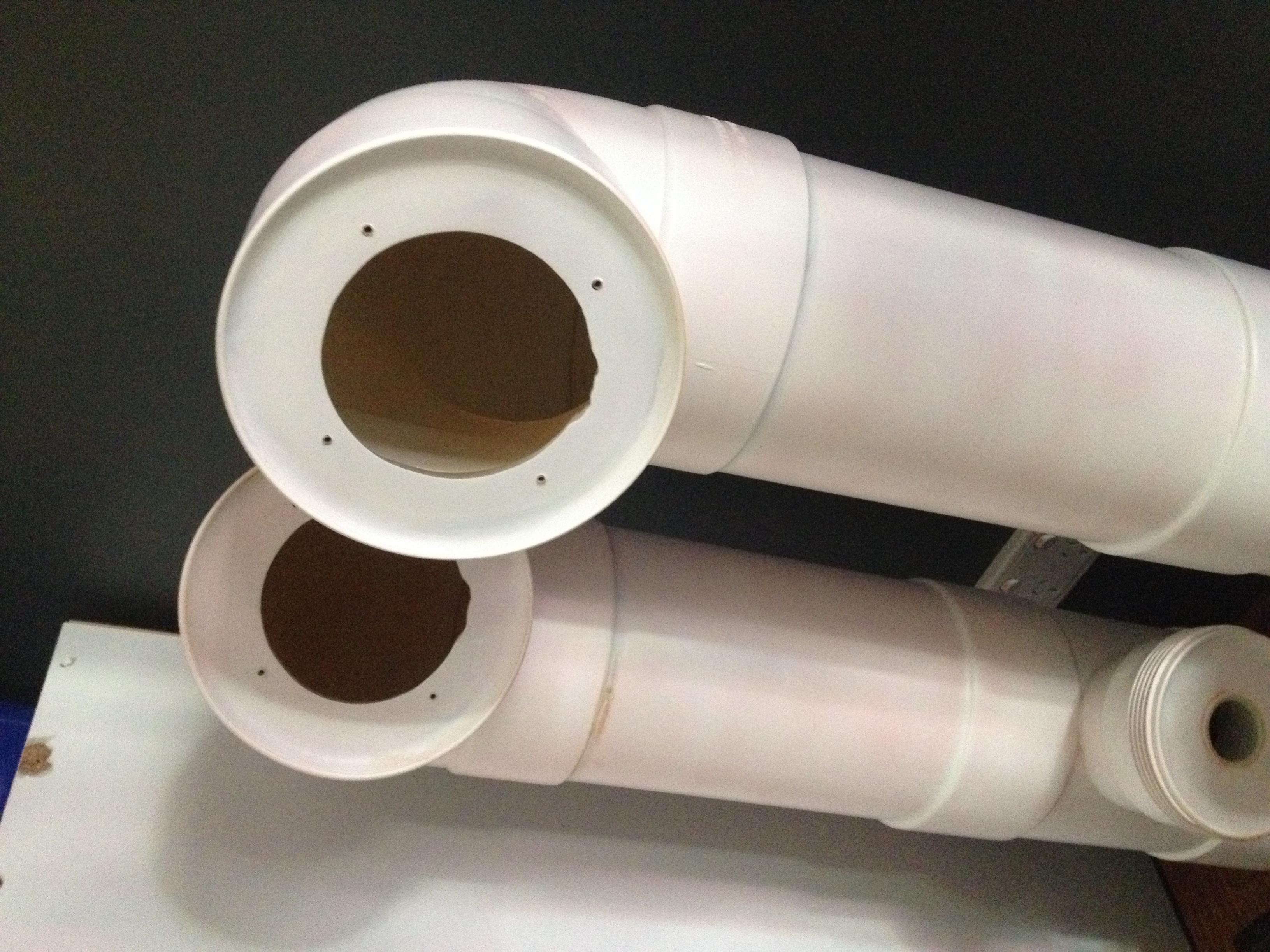

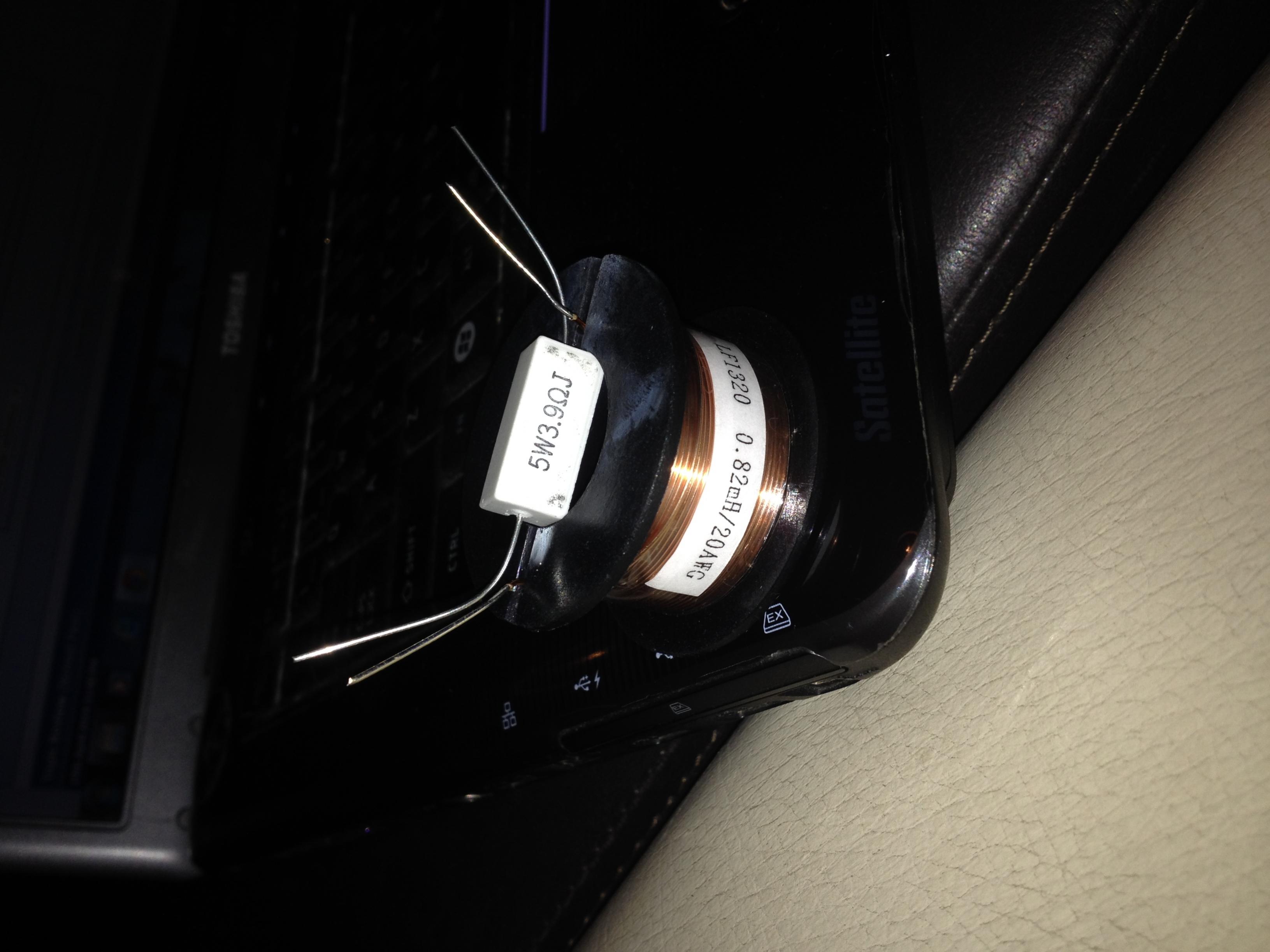

thats what im all about the accidental design, thanks very much for your response i have now upgraded the port to a 35mm internal tube witch i winISD ed to 37 mm long ?? and will stuff as you suggested when installing driver im interested in the relationship between the distance the driver is from the port ?? mine so far is 490mm from center port to center driver hole my baffel dia is 165mm ive purchased my baffle step stuff i got from my local JCAR .82mH and 3.9 ohm res just to check i wire these 2 components in parallel then insert into pos lead to driver once again thanks for the responce
any further tuning advice is much appreciated including modding pipe lengths ect as im going to prep them for paint soon once there painted that will be it
colors ???????
Looks very cool. I think you may have built yourself and accidental mass loaded transmission line (AMLTL). The port looks a little on the small side and that may be what is limiting your bass. Put some pillow stuffing in the upper third to half to reduce resonances.
What is the port dia and length you are using? A good rule of thumb is the port cross sectional area should be about 1/3 the area of the cone. Then set the length based on tuning. It appears to have quite a low fs which is good. Set the tuning freq just at of little below fs - say 60 Hz. What is the length of the pipe from driver face to bottom at base?
One thing you may be getting is a loss of bass due to baffle step loss as the area around the driver is small. You will need a baffle step compensation circuit to reduce the highs to balance with the bass. Probably a 0.8mH + 4 ohm resistor in parallel to start with and see if that helps.
colors ???????
