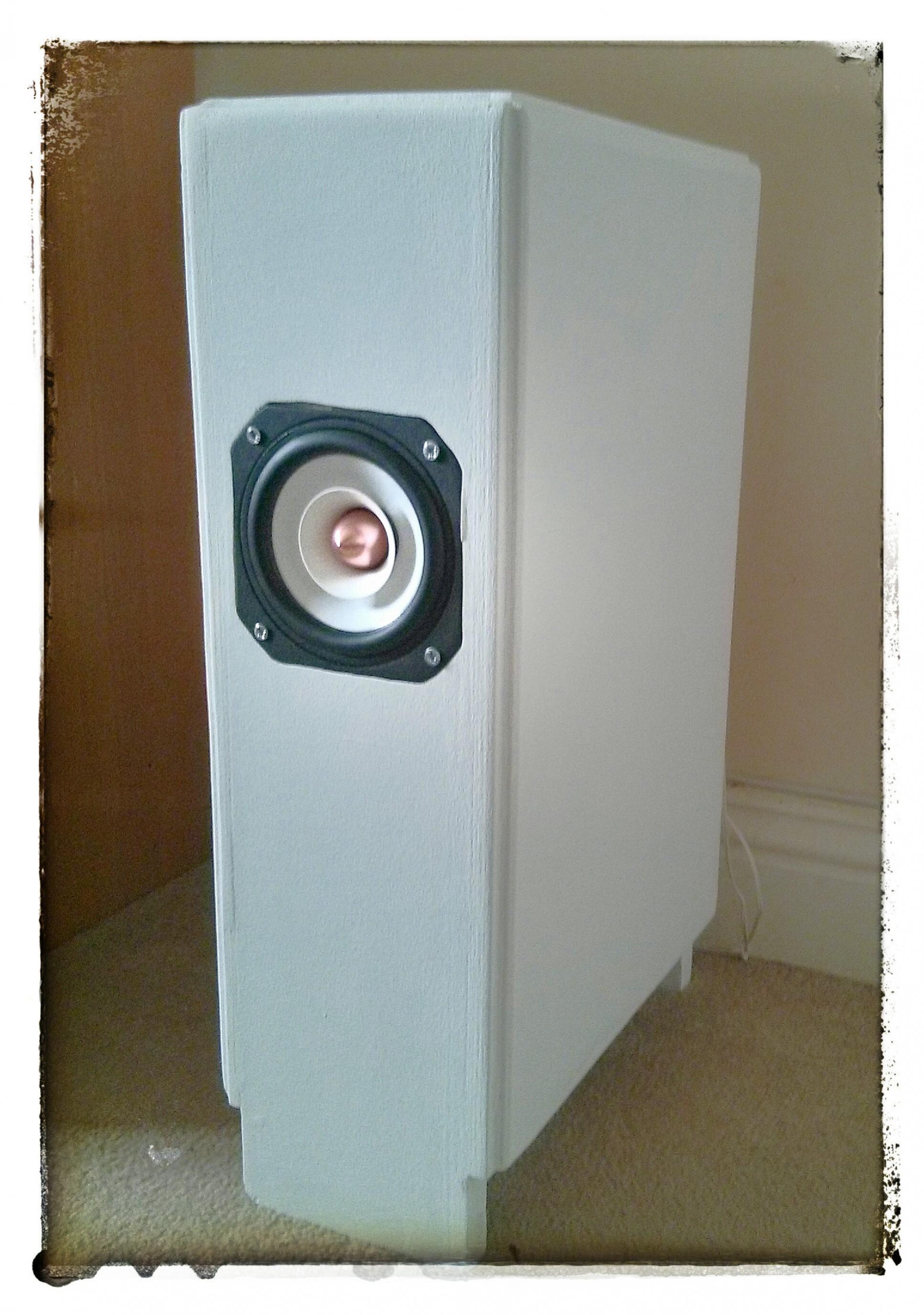

Hi recently i finished my speakers with this drivers.
The design is a folded TABAQ
They sound really good, I used the original measurements. I think to build the TABAQ floor standers with them because its easy build and you get great sound and great bass out of them. Before them i was listening to logitech 525 2.1 system and i don't miss them.

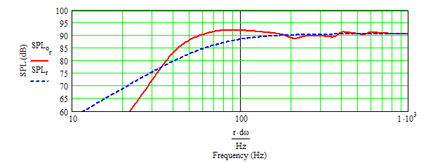

Using your previous speaker dims and keeping the driver at 7.5 cm, a 2.4 cm diameter vent down ~70.1 cm yields an acceptable response with somewhat more bass at the expense of some mid-bass, but still a better overall alignment in general and especially if it can be near a wall or corner.

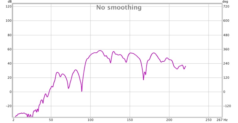

as promised here is a sweep test of the speaker. I've been listening for hours now and the treble is becoming annoying. so first thought was to build a speaker cabinet for the 5" but that would be to big. now I'm thinking about adding a woofer and a crossover filter or pushing it as it is now with a linkwitz filter. or maybe I should add a separate woofer... still not sure. anyway see the attachment for the result. anyhow I think the results are still stunning considering the size of the cabinet and the size of the speaker. cheers.
