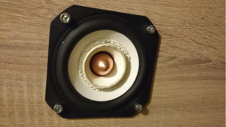

Would you mind sharing some pics of your mod? I can't really ficure out how to apply blue tac and how much...
Did you try to apply the EnABLed painting pattern?

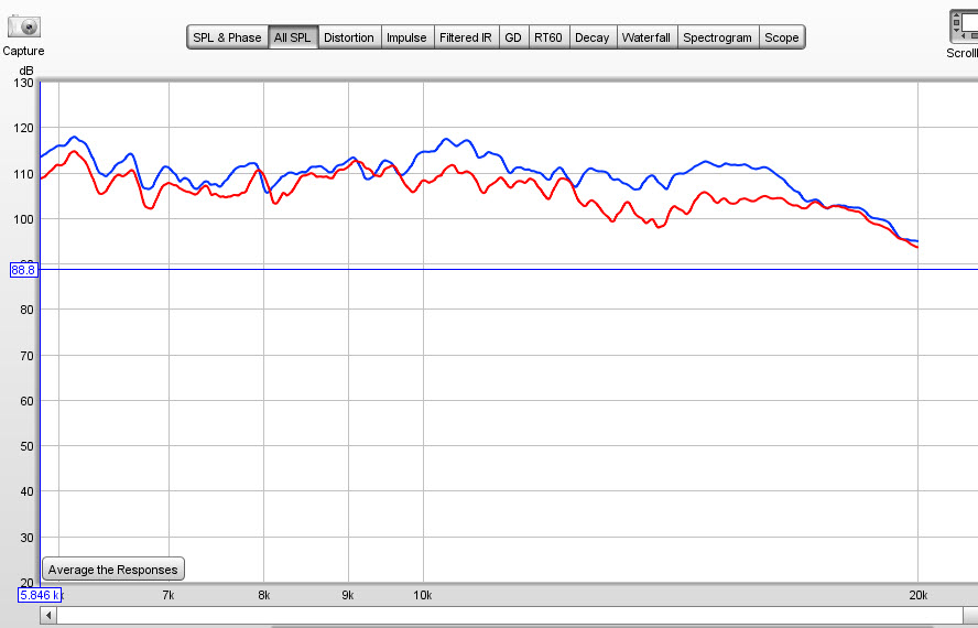

Application around the edge of the whizzer is to control 10KHz and above. On the main cone 12 cm from the voice coils damps 8/9Khz. Its trial and error process and the added mass will definitely change T/S parameters. Even the shape of the added mass affects the reponse and phase, so lot of experiment.
Blue graph is before application of damping on whizzer and Red is after application.
Both response have damping on the main coil to control 8/9Khz
Not good, but good try! Maybe you could find a spot on whizzer just to tame that peak? 🙂
It seems that this driver need's a supertweeter, or maybe just a rear firing supertweeter ambience enhancer? 😀

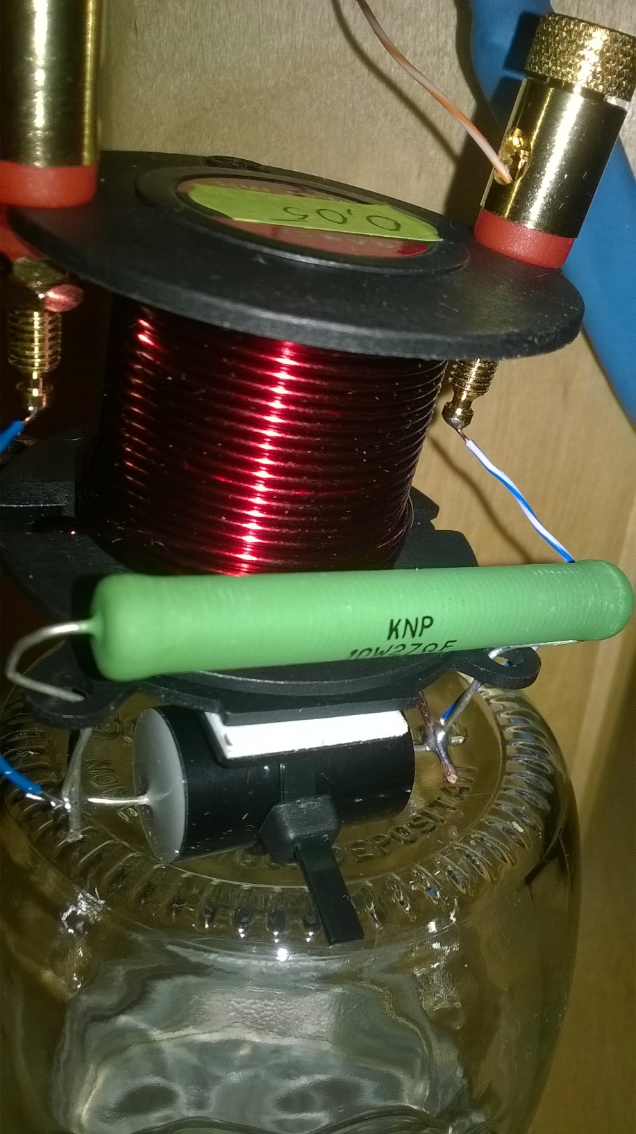

27ohms
Filter
Today I finished Ttan98's BSC filter.
Still to make any critical listening test, but the filter is really unintrusive, it doesn't change the sound signature of the speaker.
This is a nice thing, IMHO.
Thank you Ttang98!
