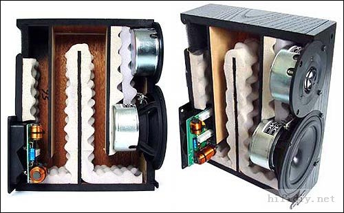

There was a picture there you didn't link... and it explains that my drawing is a sketch (estimate) of the internals of the small PMC enclosure (attached). None of these enclosures are likely suited to the driver. The BD-Pipe and the FE103 TQWT likely aren't... the latter being unlikely to be optimum for any driver.
The power of the internet, grrrrr! That sucks your image was used without permission. Impossible to regulate. The drivers look really good... but the quality of the veneer is spoiled by the hole cutouts.
