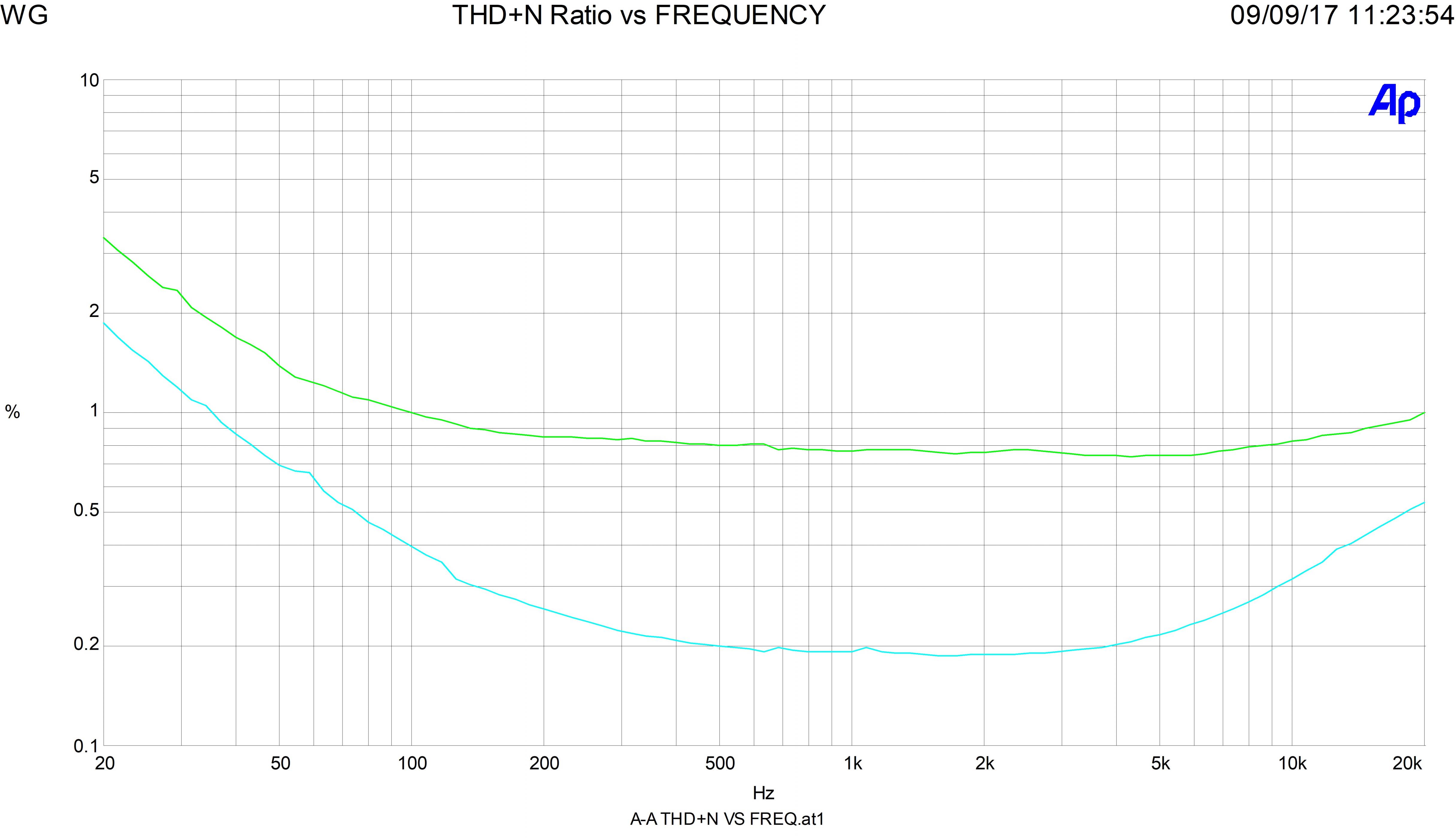

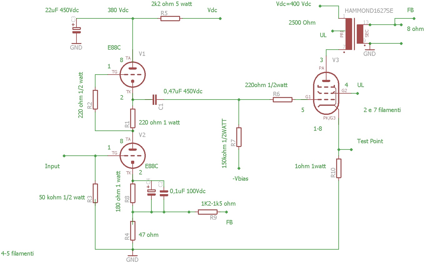

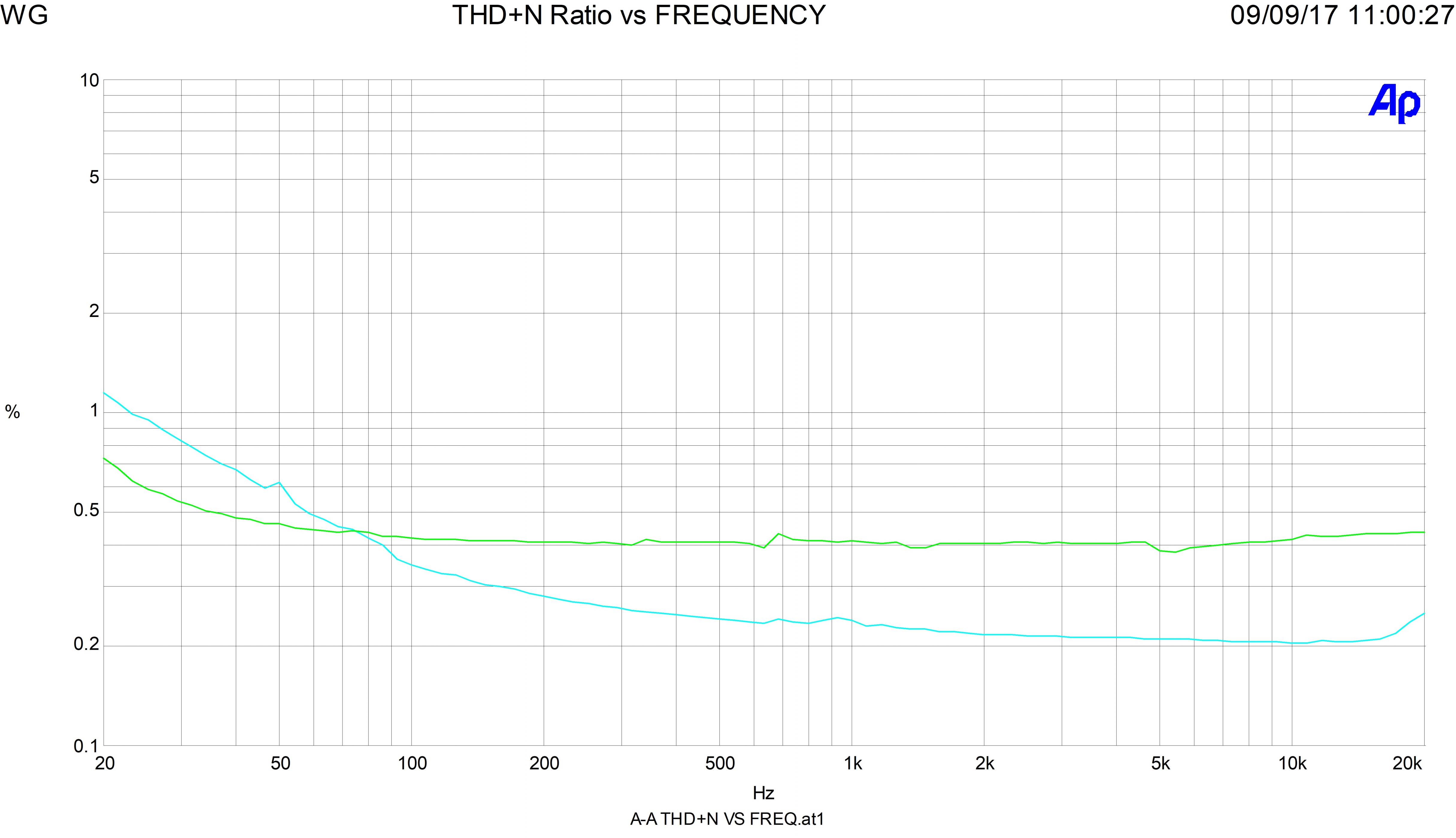

No test lab that can ceritfy the performances! This is the major problem of this tye of kit ( and in general)

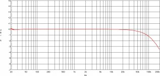

Jut to be clear, in attach a circuit, simply and certified.
With freq. answer and thd vs frequency with two different I bias.
The trafo are custom but also with Hammond is possible to get a good results
Walter

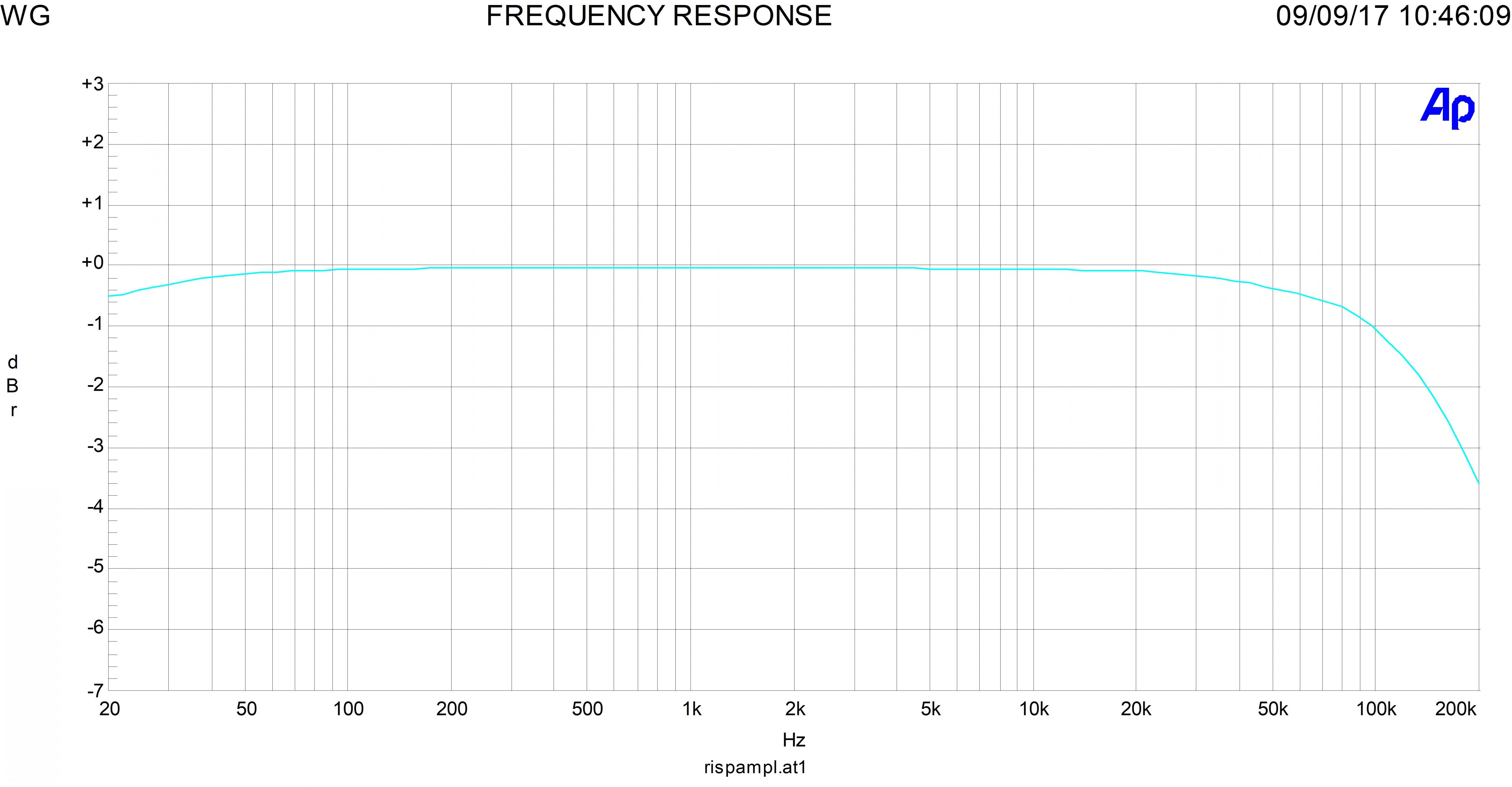

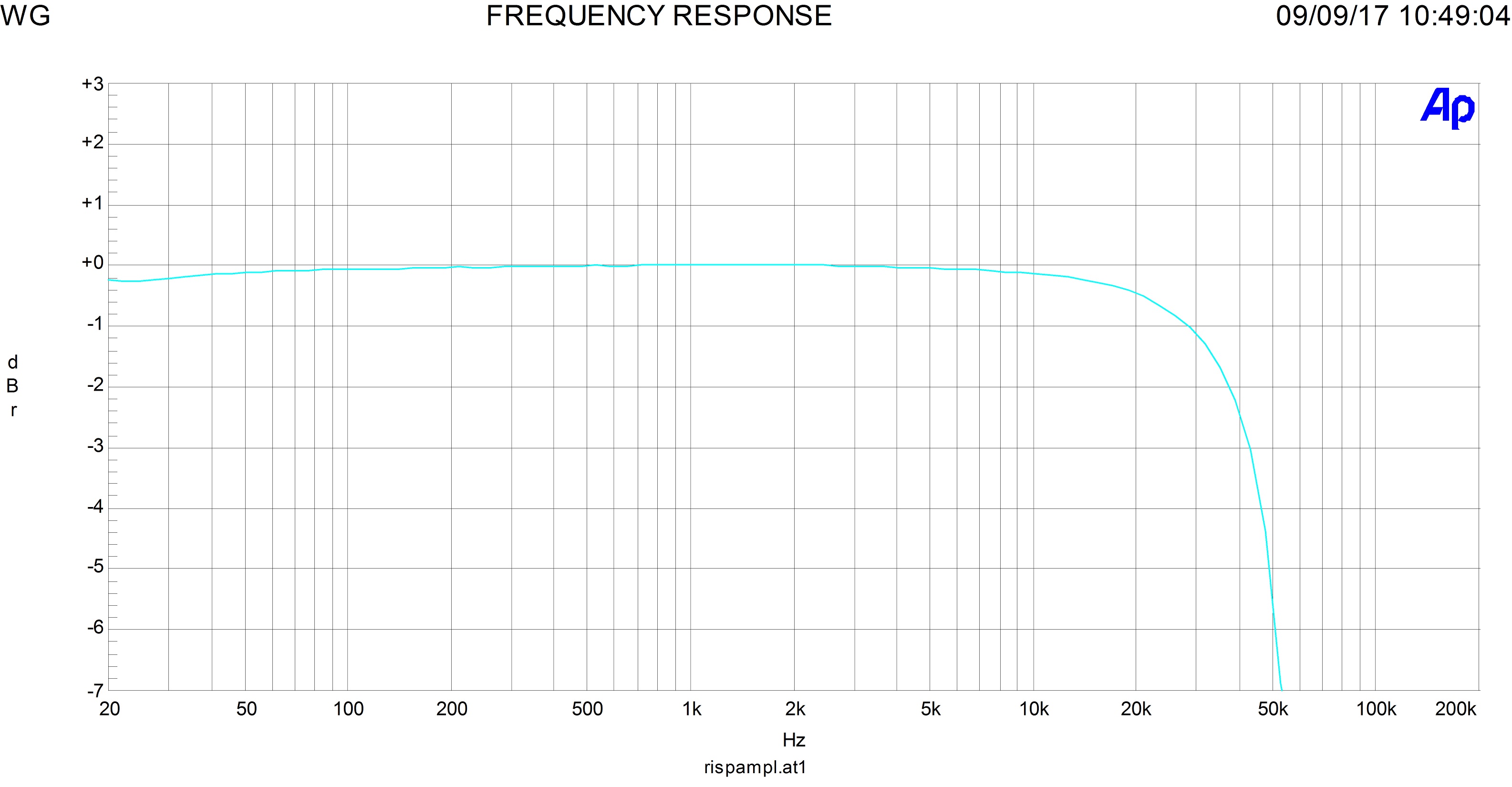

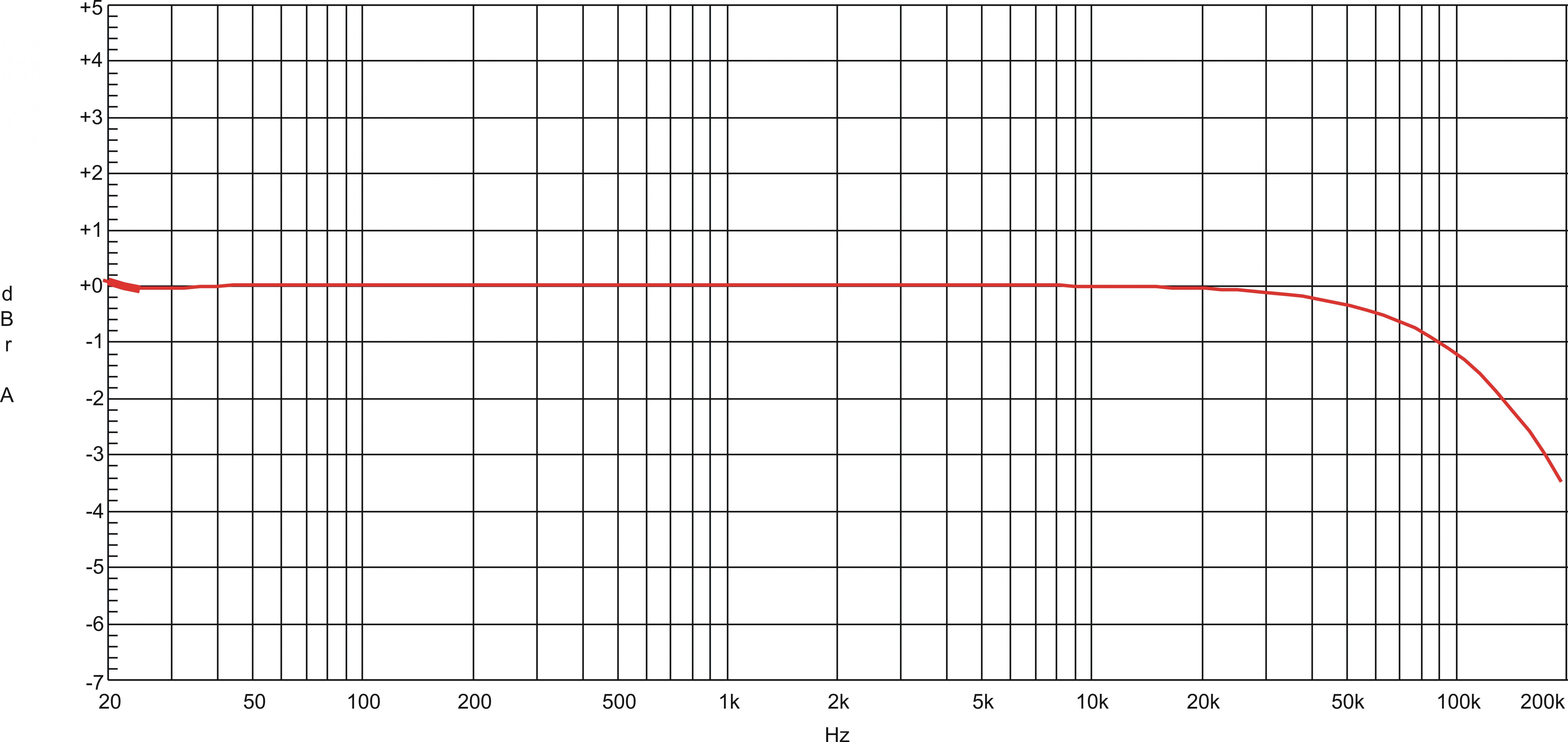

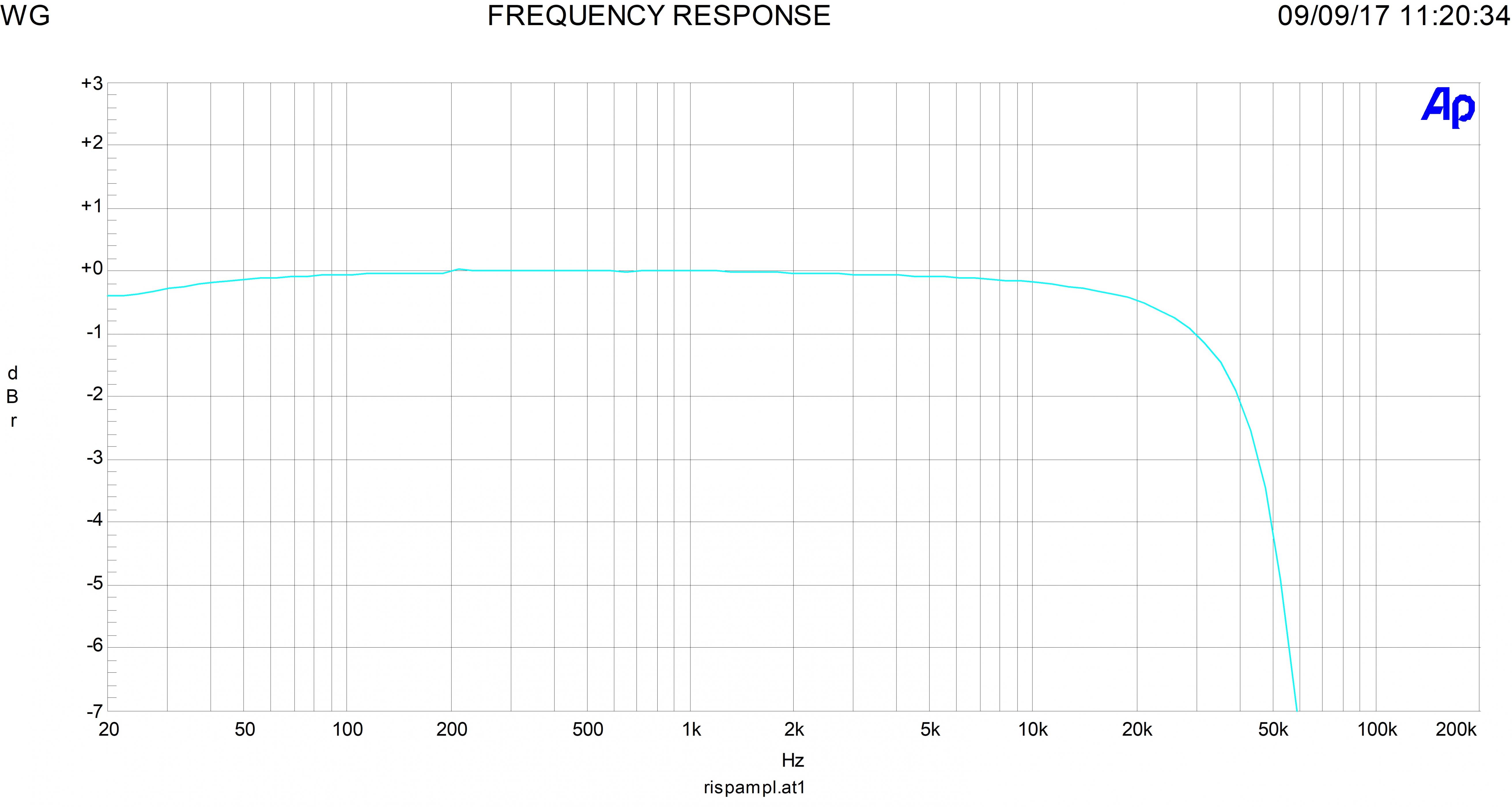

In attach the real test on Srpp of the circuit sent post ago
With 450 mV in you got 20 Vout rms with a BW of around 200 kHz and distortion less than 1%; in this way the grid of EL34 or KT88 will be driven good
This is E88C, single triode
In addition a freq. response of a Srpp withh 6922, 1 Vin, 23 Vout,
I have a lot of preconcept about simulation until the real circuit is done with real test.
And the comparison is verified.
When there are involved the trafos and inductors this is not possible
Walter

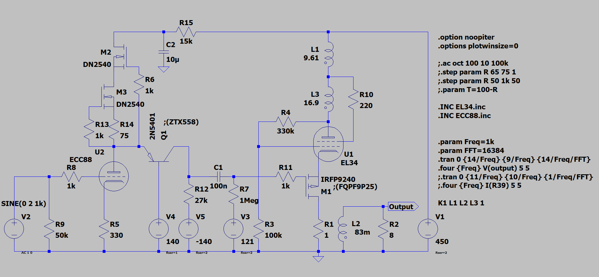

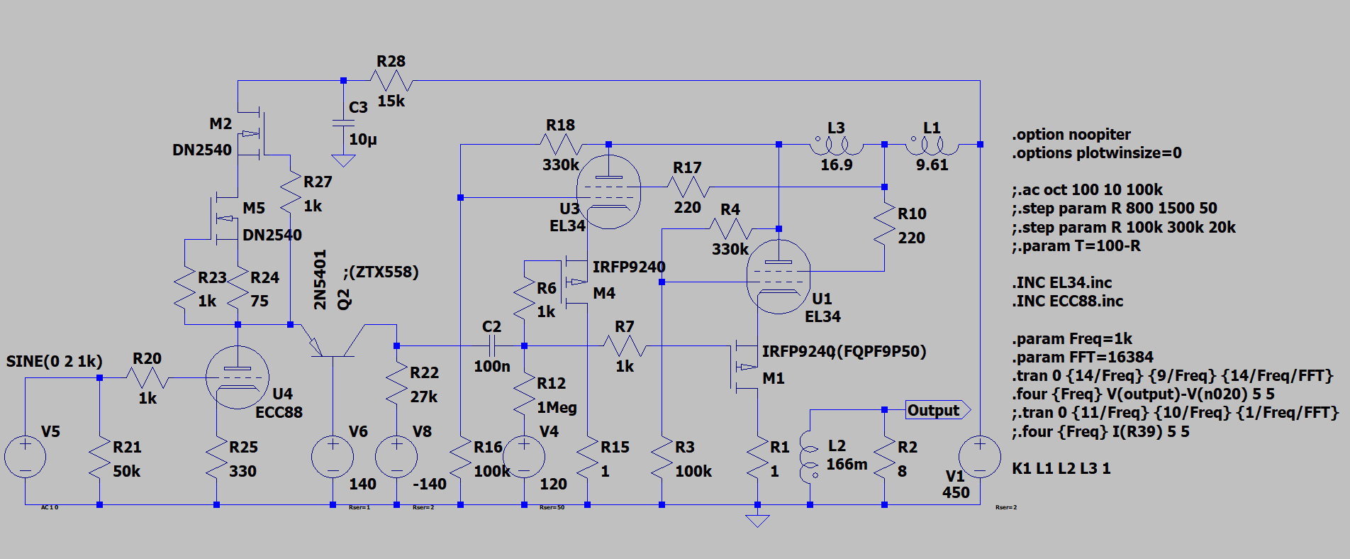

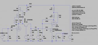

Thanks for your comment Walter,
if you look at the circuit I've posted, I have a cathode driven output tube à la Tubelab with local feedback anode-to-grid. That causes to add the swing of the grid (that is a percentage of the anode swing) to the driver's swing. That's why I went to Rod Colemans' shunt driver, that working on a vertical load line is able to swing 100 Vrms with a THD lower than 1 and mainly 2nd harmonic (due to the knee at the bottom of the curves).

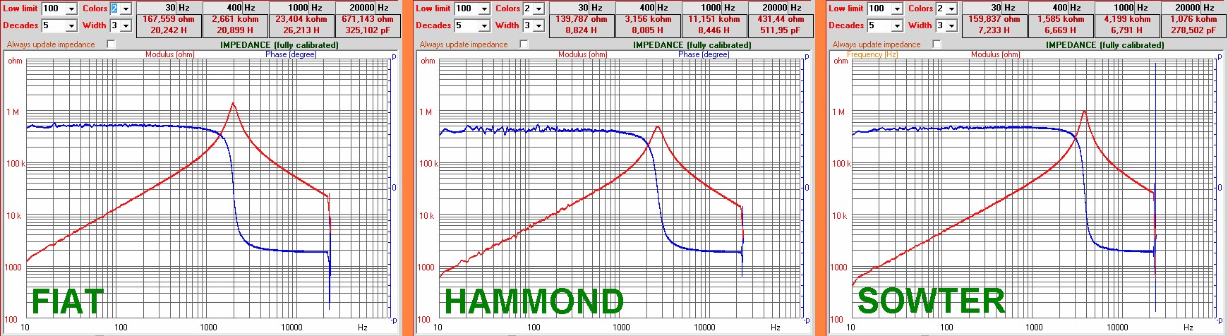

In which way you can simulate the trafo if you aren't able to get the real parameters of it?
At mid frequency is possible to assume that the trafo is quite ideal but at the ends is another story,
In attach three different s.e, trafo under test.
The test is done with a particular sw by Fabrizio Montanucci in Audioreview magazine in Italy where I write .
It is possible to measure the inductors and caps.
You can see the differences on each one.
The shape of Z in function of frequencies.
As you see the resonance varies between 2 kHz and 3 kHz with different Q.
After the resonance the phase switch from +90 to -90° this because the trafo is acting, less or more, as capacitor (due the parasitic)
In which way you can simulate this?
These are the real problems in tube amps.
Not the swing at 100 Vrms that is not necessary in your case
And the use of sand while you can reach a very good results in other simply way also to spent money for OT

Looks like a simple elegant circuit. What do you think about substituting 2X 6L6 tubes instead of the KT150?
Instead of doing the coffee break I switched the input tube to a ECC88 with good results, but I still have a predominant 2nd harmonic even at low power.
I only simulated the version with one output tube, because that's the version I have on the laptop I'm using now. This evening I will simulate the PSE.
These the results at 15 Wrms:

I'm looking at the datasheet of the FQPF9P25 ( https://www.mouser.it/datasheet/2/308/FQPF9P25-D-1809691.pdf ) and here I have a limit on the Vds that could make me move towards the FQPF9N50 ( https://www.mouser.it/datasheet/2/308/FQPF9N50CF-D-1810101.pdf ) or reduce the local feedback on the EL34s.
By the way, this is the circuit with two EL34s in parallel.
and these the results at 30Wrms:
Code:
Harmonic Frequency Fourier Normalized Phase Normalized
Number [Hz] Component Component [degree] Phase [deg]
1 1.000e+03 2.165e+01 1.000e+00 -1.66° 0.00°
2 2.000e+03 4.459e-01 2.059e-02 -100.93° -99.27°
3 3.000e+03 2.672e-01 1.234e-02 4.76° 6.43°
4 4.000e+03 8.060e-02 3.722e-03 -72.40° -70.74°
5 5.000e+03 9.459e-02 4.368e-03 -174.10° -172.44°
6 6.000e+03 4.972e-02 2.296e-03 97.96° 99.62°
7 7.000e+03 3.956e-02 1.827e-03 3.07° 4.73°
8 8.000e+03 2.149e-02 9.923e-04 -87.12° -85.46°
9 9.000e+03 1.436e-02 6.630e-04 177.01° 178.67°
Total Harmonic Distortion: 2.488472%(2.488905%)
