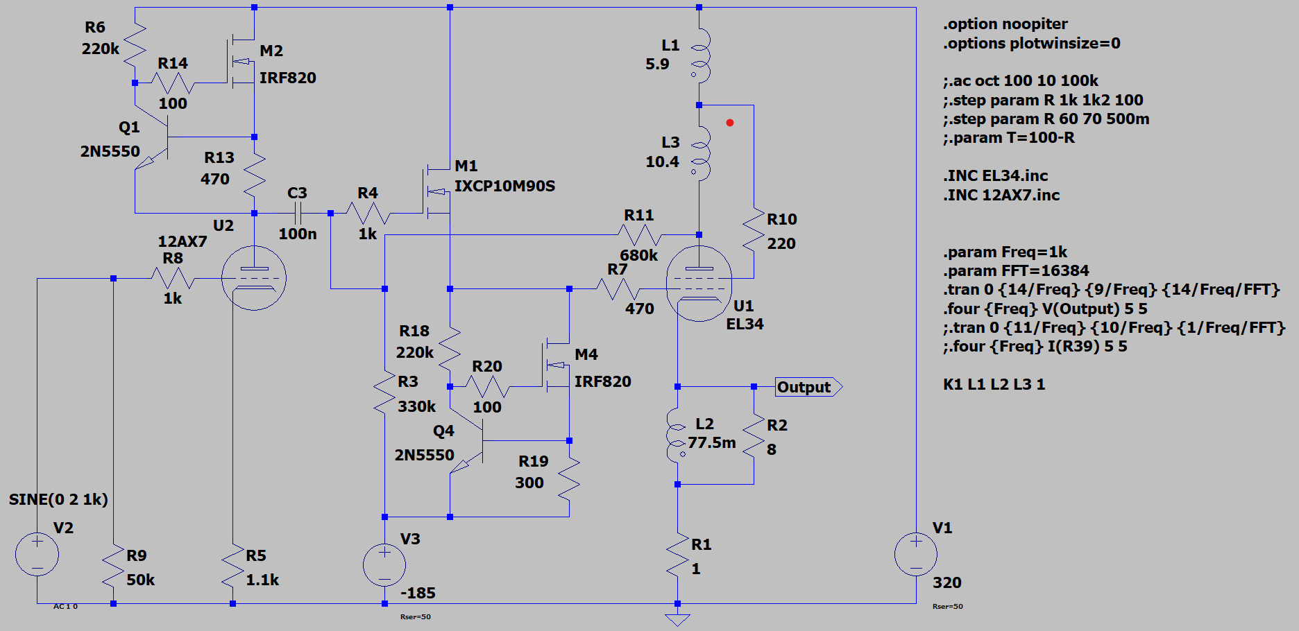

A friend of mine gifted me that module, and while I'm buying new output transformers for the PP amp, I would like to order transformers for this amp too.
I came out with the attached schematic:
that gives 11 Wrms with the following data:
this at 10 Wrms:
and this at almost 8 Wrms:
Does anyone see any way to simplify it or improve it?
I'll sketch it also in PSE with two EL34 in parallel per channel.
Thank you in advance,
Roberto
Code:
Harmonic Frequency Fourier Normalized Phase Normalized
Number [Hz] Component Component [degree] Phase [deg]
1 1.000e+03 1.354e+01 1.000e+00 178.90° 0.00°
2 2.000e+03 1.521e-01 1.123e-02 92.80° -86.10°
3 3.000e+03 6.767e-01 4.999e-02 177.54° -1.37°
4 4.000e+03 1.056e-01 7.802e-03 -87.59° -266.49°
5 5.000e+03 2.325e-01 1.718e-02 -6.56° -185.46°
6 6.000e+03 1.945e-02 1.437e-03 91.28° -87.62°
7 7.000e+03 5.335e-02 3.941e-03 162.08° -16.83°
8 8.000e+03 3.060e-02 2.260e-03 82.12° -96.79°
9 9.000e+03 1.087e-02 8.028e-04 -155.33° -334.24°
Total Harmonic Distortion: 5.481168%(5.487636%)
this at 10 Wrms:
Code:
1 1.000e+03 1.267e+01 1.000e+00 178.93° 0.00°
2 2.000e+03 3.748e-02 2.959e-03 96.87° -82.05°
3 3.000e+03 3.042e-01 2.401e-02 178.51° -0.42°
4 4.000e+03 5.439e-02 4.293e-03 -86.35° -265.27°
5 5.000e+03 9.497e-02 7.496e-03 -3.42° -182.35°
6 6.000e+03 3.630e-02 2.865e-03 87.46° -91.46°
7 7.000e+03 3.493e-02 2.757e-03 172.21° -6.72°
8 8.000e+03 1.447e-02 1.142e-03 -100.16° -279.09°
9 9.000e+03 1.019e-02 8.040e-04 -17.72° -196.64°
Total Harmonic Distortion: 2.602950%(2.603615%)
Code:
1 1.000e+03 1.115e+01 1.000e+00 178.95° 0.00°
2 2.000e+03 2.558e-02 2.294e-03 -93.37° -272.32°
3 3.000e+03 1.116e-01 1.000e-02 178.62° -0.33°
4 4.000e+03 2.893e-03 2.594e-04 29.98° -148.97°
5 5.000e+03 1.631e-02 1.462e-03 -1.50° -180.45°
6 6.000e+03 2.694e-03 2.415e-04 99.45° -79.50°
7 7.000e+03 3.595e-03 3.223e-04 178.12° -0.83°
8 8.000e+03 1.157e-03 1.037e-04 -81.89° -260.84°
9 9.000e+03 9.910e-04 8.885e-05 -3.72° -182.67°
Total Harmonic Distortion: 1.037667%(1.037674%)
Roberto
