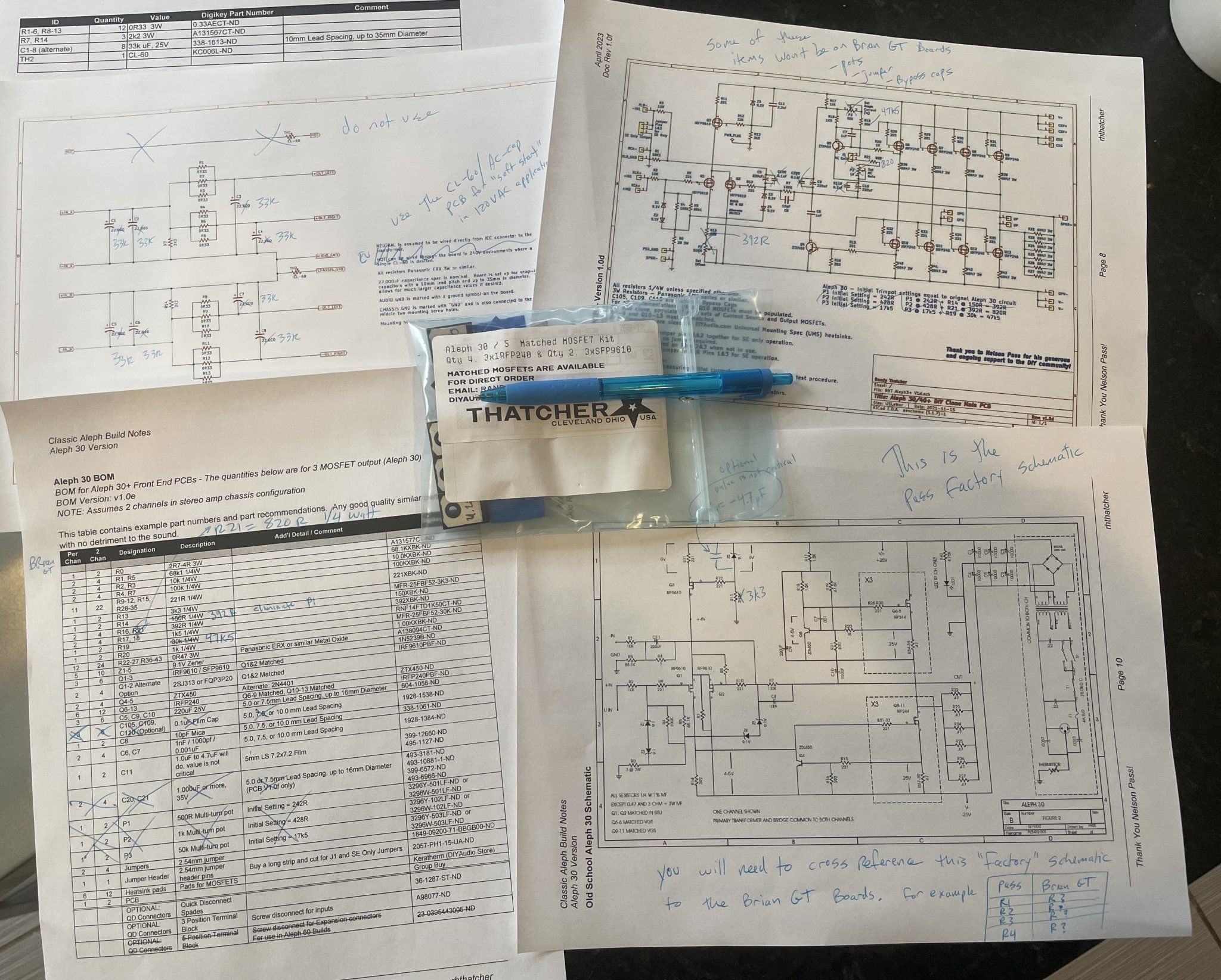

I downloaded your build PDF for the Aleph 30. Are there any parts differences that I need to be aware of for the classic build?
The part location names like R1 C1 etc may be different between the boards that you have and the boards that Peppe is sending you. But the schematic should be very close if not the same to the original aleph 30 schematic. Look at the Aleph 30 schematic and see if they match. You may have to do a little cross referencing.
Randy's boards are going to have a few more parts than the classic 30 like a jumper and some bypass caps.
The potentially tricky part will be cross referencing the original part numbering to BrianGT’s boards.

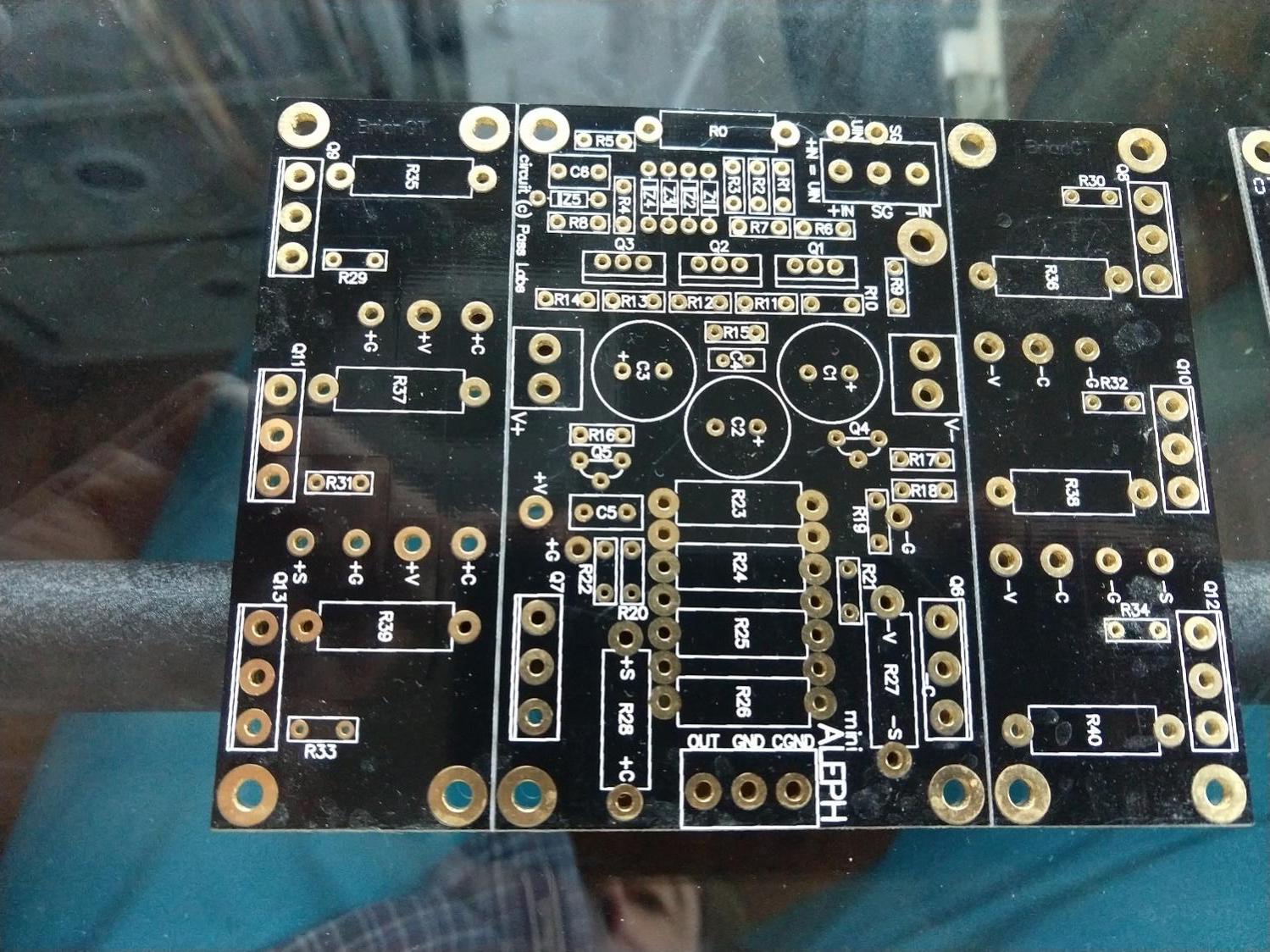

I have compared the original schematics (in your picture) against my PCB picture and it seems that this PCB iteration uses the original part numbering.
Peppe, I think those are Peter Daniel's boards and are based on the original Aleph 30 schematics.
Edit: I noticed the predrilled UMS store heatsinks were mentioned earlier. Note these PD boards most likely do not fit the UMS pattern since I believe they pre-dated that standard.
That is correct. Those are PD boards but they look very similar to the BrianGT Aleph Mini/5/30 boards (picture below). The latter do not follow exactly the original part numbering.
I get confused myself about these boards. Actually, I don't even remember why I had both types in my drawer. I guess I have hoarded them back when group buys were the only way to get some.
