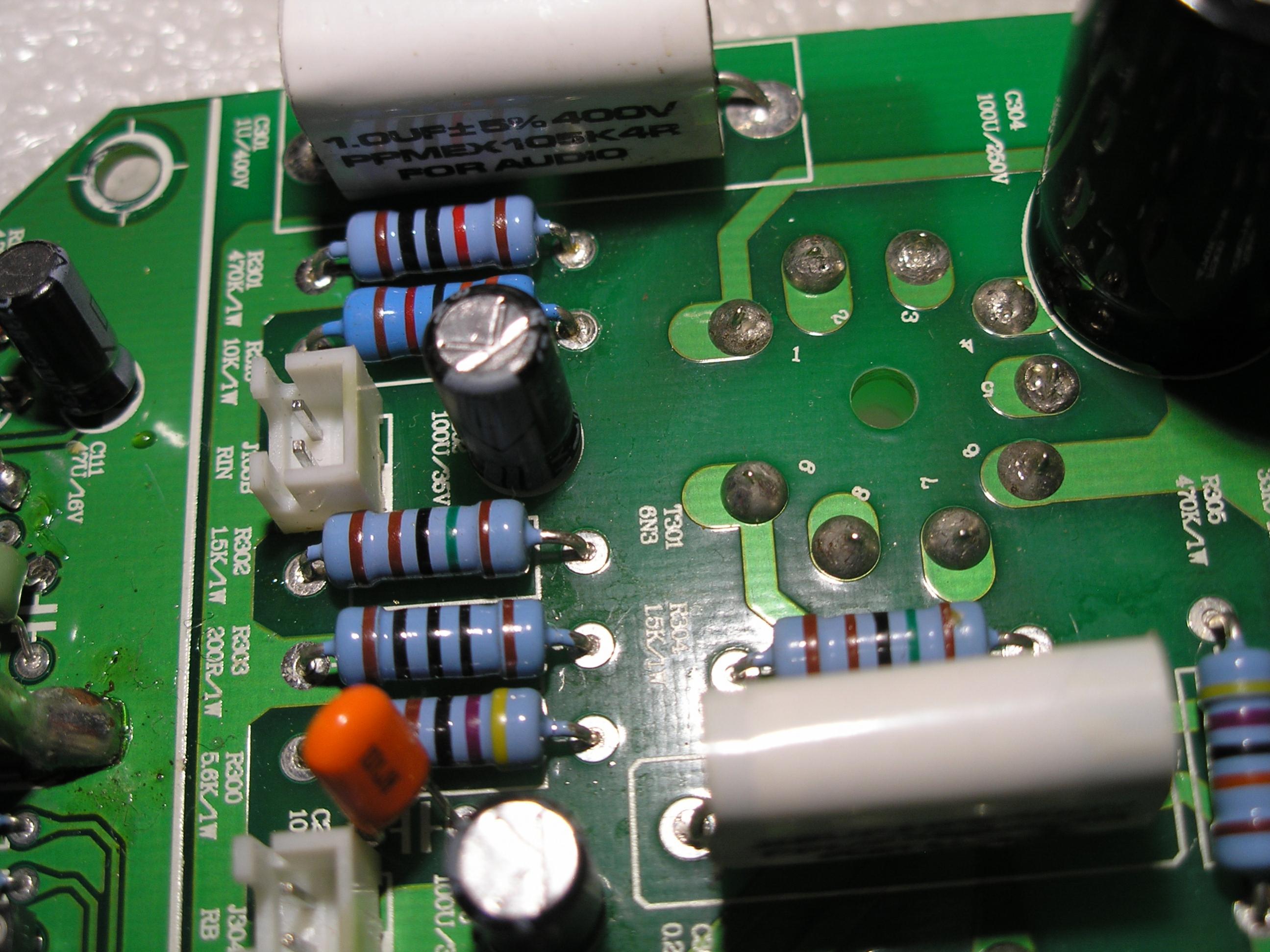

Not my intention to derail off topic discussions, but what happened with OP's amplifier? 😕
I am still here 🙂
I have been enjoying reading through all the posts!!!
My "workshop" is a storage closet without any windows and no air conditioning. We are in the middle of a heat wave and it's oppressive in there🙁 I might move either my tools and stuff to an air conditioned room to work on my projects when I have more time. Hopefully tonight I can make some time to look at the amp again. It is one of the nicest Chinese amps I have seen, I got it for $250. If I change the topology it must still fit to the existing circuit board, which shouldn't be an issue. I have also been reading the oscillation in tube amps section from George to help me "sniff" out the oscillation. As suggested I might just re-solder the tube sockets and see if that fixes it.
I tracked the oscillation back to the preamp section. I have continuity in feedback wiring from speaker tap and the 4k7 resistor is fine. I pulled the preamp board out because the solder joints look really bad. The picture really doesn't do it justice. The Power amp boards are much better in comparison. I will resolder all the tube sockets on the preamp board for both channels. Hopefully that does the trick.
I wanted to update the thread and let everyone who helped know that the amp has been playing without any issues since I resoldered the sockets on the driver board.
I am open to suggestions for modifications now it's got a clean bill of health. I have a preamp and power amp project going so I am kinda all over the place.

I got this amp from China years ago and it has held up and sounded pretty good. Lately one channel has cutting in and out, loss of power, distorted sound. I found with the inputs shorted the right channel has a 50kHz oscillation. I do see an inductor that might be for an SMPS on the side with problematic channel.
Is the first stage and SRPP? If it is why? I thought they were good for driving heavy loads.....looks like it's driving 470k? I do remember reading that with the correct load they can cancel distortion like any push pull stage.
I would check these things first:
1 - Check that the coupling capacitors are not conducting DC. This is easy to do with the amp OFF using a DMM.
2 - Check to see if all connections from the input through to the end stage are good. Check ground connections too of course. Use a DMM with the amp OFF.
3 - Very carefully record all rail voltages with the amp on. only use ONE hand to hold your probe. Make sure your DMM is earthed. Keep your other hand behind your back.
4 - record all the voltages and put them in your schematic.. check if they make sense using Ohm's law.. etc..
Glad to hear this!!! 😀
If you're happy with the sound, then just leave the "SRPP" stage as is... That's my advice. 😉
Yes it sounds good to me🙂 I do plan on leaving it as is for the time being, too many projects going anyway.
Thanks!
