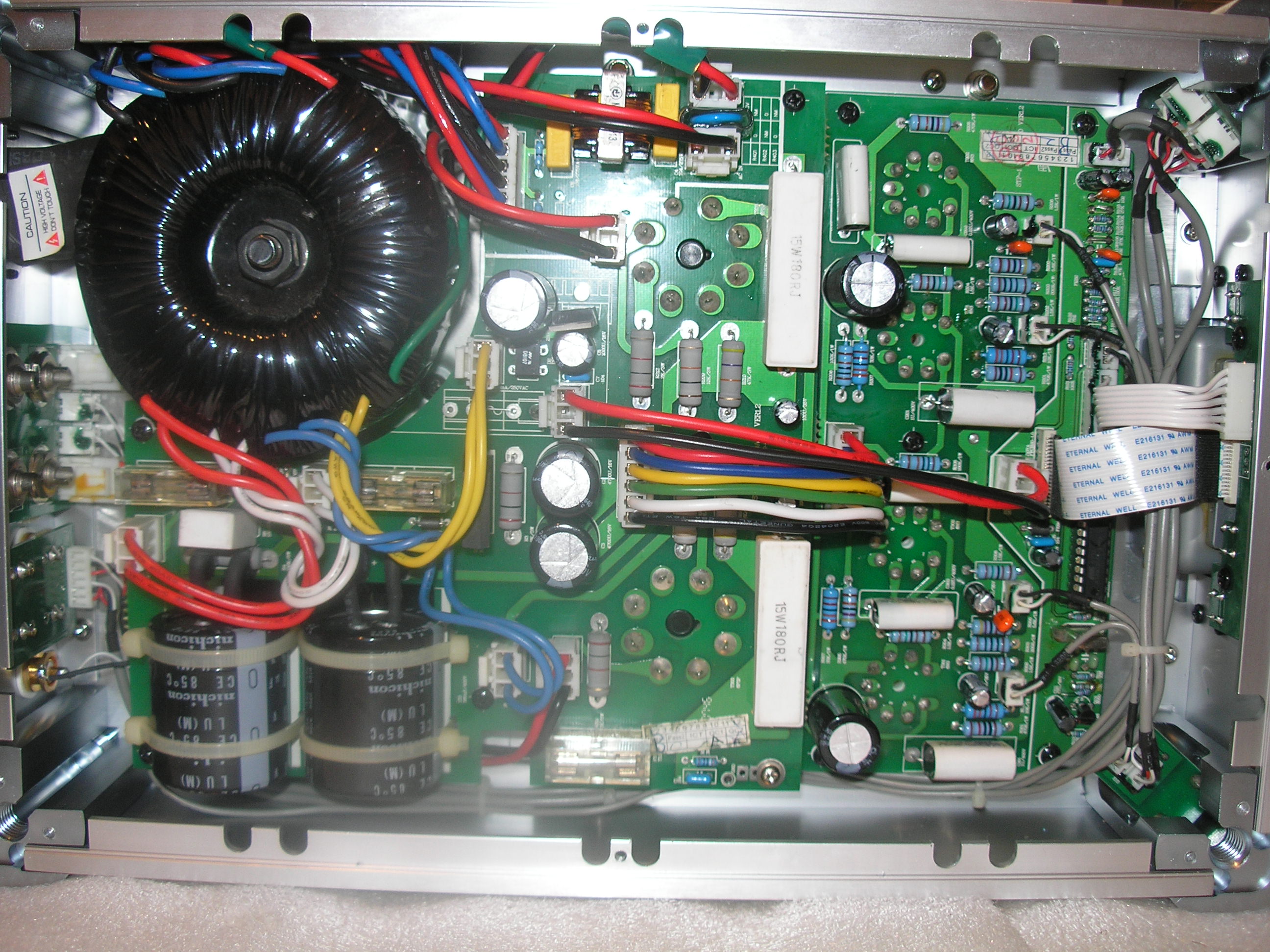

My "workshop" is a storage closet without any windows and no air conditioning. We are in the middle of a heat wave and it's oppressive in there🙁 I might move either my tools and stuff to an air conditioned room to work on my projects when I have more time. Hopefully tonight I can make some time to look at the amp again. It is one of the nicest Chinese amps I have seen, I got it for $250. If I change the topology it must still fit to the existing circuit board, which shouldn't be an issue. I have also been reading the oscillation in tube amps section from George to help me "sniff" out the oscillation. As suggested I might just re-solder the tube sockets and see if that fixes it.
I tracked the oscillation back to the preamp section. I have continuity in feedback wiring from speaker tap and the 4k7 resistor is fine. I pulled the preamp board out because the solder joints look really bad. The picture really doesn't do it justice. The Power amp boards are much better in comparison. I will resolder all the tube sockets on the preamp board for both channels. Hopefully that does the trick.

I wanted to update the thread and let everyone who helped know that the amp has been playing without any issues since I resoldered the sockets on the driver board.
I am open to suggestions for modifications now it's got a clean bill of health. I have a preamp and power amp project going so I am kinda all over the place.

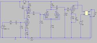

If this is what you want, then you'd do better with this design (attached). It still bootstraps the gain stage to a higher gain while making for a shallow, low distortion loadline. It also provides a Lo-Z output, and lower than the SRPP. It also allows for larger output swing for the DC rail voltage.
It can be worked in two ways: the bootstrap capacitor can be sized to make it effective at all frequencies of interest. It can also be made quite small ( ~20pF ) so that this operates as an output buffered gain stage. The PFB becomes effective just on fast transients, with the capacitor acting as a "hurry-up" capacitor.
This topology can work very well. Depending on the design and chosen operating point, the cathode by-pass might not be necessary too.
I got this amp from China years ago and it has held up and sounded pretty good. Lately one channel has cutting in and out, loss of power, distorted sound. I found with the inputs shorted the right channel has a 50kHz oscillation. I do see an inductor that might be for an SMPS on the side with problematic channel.
Is the first stage and SRPP? If it is why? I thought they were good for driving heavy loads.....looks like it's driving 470k? I do remember reading that with the correct load they can cancel distortion like any push pull stage.

If you're happy with the sound, then just leave the "SRPP" stage as is... That's my advice. 😉
