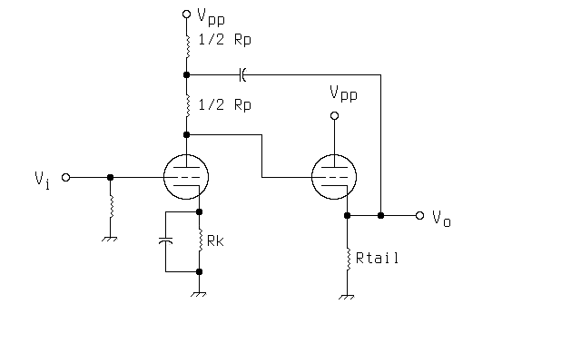

Note that a lightly loaded SRPP still has the lower output impedance of an SRPP, not the Ra/2 of an active load circuit. This may have no consequences, but it is still true.
If this is what you want, then you'd do better with this design (attached). It still bootstraps the gain stage to a higher gain while making for a shallow, low distortion loadline. It also provides a Lo-Z output, and lower than the SRPP. It also allows for larger output swing for the DC rail voltage.
It can be worked in two ways: the bootstrap capacitor can be sized to make it effective at all frequencies of interest. It can also be made quite small ( ~20pF ) so that this operates as an output buffered gain stage. The PFB becomes effective just on fast transients, with the capacitor acting as a "hurry-up" capacitor.
Yes, of course. The active load is also a modified CF, so you get lower output impedance - although not as low as an unmodified CF would give you.SY said:It is not because of any push-pull action.
Yes. The boostrapped circuit is a modified mu-follower.Miles Prower said:If this is what you want, then you'd do better with this design (attached).

Is the SRPP topology actaully dependent on its load?
I would say that the load is part of the SRPP topology. 😎😉

I guess if we use Merlin's definition, then it is not quite a SRPP, since it is both direct coupled to the next stage and it uses the anode of the lower tube for the output instead of the cathode of the upper tube. It gets even weirder, the cathode resistors are not the same value and only the lower tube's Rk is bypassed, wonder what Kondo-san was shooting for with this "SRPP" design?
Oh, yes, you're right, my fault. It's a half-mu variant, and no SRPP. Note the bypass cap is very small and only there to boost the top end of the audio band a little.
Not your fault at all, even Kondo himself called it an SRPP, and you are right about the small bypass cap, he must use it for shaping the high frequency response. But I think this one might be chucked into Broskie's "gratuious SRPP" bin.Oh, yes, you're right, my fault. It's a half-mu variant, and no SRPP. Note the bypass cap is very small and only there to boost the top end of the audio band a little.
