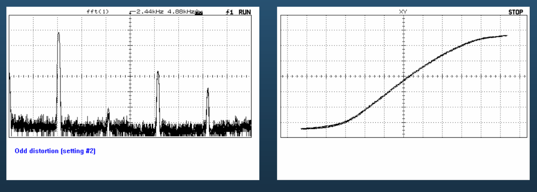

So we are back to considering the "transfer function" relationships that are discussed in the Pete Millet "Magic Box" article as a way to generate the harmonics:
https://www.ka-electronics.com/images/pdf/ThesoundofDistortion.pdf

What about something like modelling a MOSFET transfer function, but reducing the gain to 1?
The 'gate' input gets modified, sample by sample, by a 1d lookup table to produce a 'drain' output.

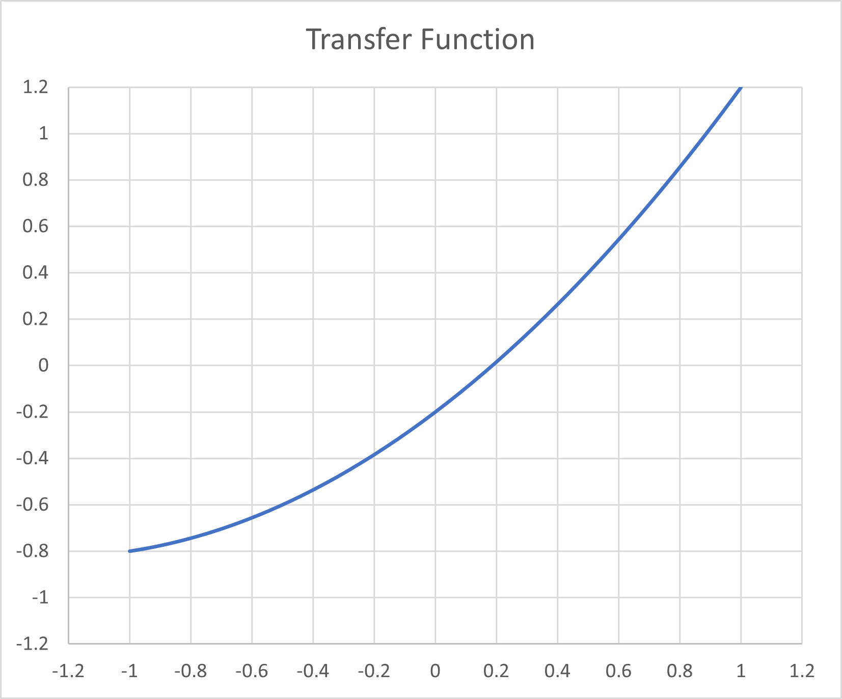

So, I have figured out how to implement the transfer function in code. Initially I will have the user define a static array in the code that consists of pairs of numbers (x,y) spanning the interval (-1:1,-1:1). These points define the transfer function. The user can supply as few or as many as they want. I will then interpolate these into an internal lookup table using a montonic spline on to a fixed grid of either 100+1 or 1000+1 points on two intervals, -1 to 0, and 0 to 1, including both end points. A monotonic spline must continually increase, and this prevents the interpolated values in between user defined point from looping/arcing in non-sensical ways. By performing the interpolation separately for positive and negative regions it is easier to model, for example, a class-B amplifier where the devices do not conduct near zero signal level. The other convenient thing about using a round base 10 number of points is in the ease of "looking up" the value in the table. Each sample is the x value we want to look up, and the output will be the corresponding y value. When the x value is, e.g. 0.123456789..., I can simply parse the digits in the number to directly obtain the position of the two nearest x values in the table, the one below is at position 123 and the one above is at position 124. I will then perform a simple linear interpolation on these two values to get the corresponding y value. This avoids the task of looking up a value in a list or table, which requires O(log N) operations by bisection for example. Since this has to happen for every sample passing through the plugin, it is worth saving these few operations each time. This approach can be used when the number of values is not a power of 10 but that would take some thinking and I am lazy!
So, the plugin is simply taking an incoming sample value, finding two bracketing values in a LUT, and then interpolating those to get the output sample value. That will be nice and lightweight, perfect for the LADSPA plugin.
I have attached a pic of such a transfer function. It's just a curve, like the one shown at right in the image. The shape of the curve determines the distortion products produced as a function of the signal level. This can be measured for an actual physical amplifier.
As a reminder, the user would still be responsible for performing the other associated and necessary tasks I outlined before, including low-pass filtering and upsampling of the incoming signal, and then (if desired) downsampling after processing the data with the plugin.

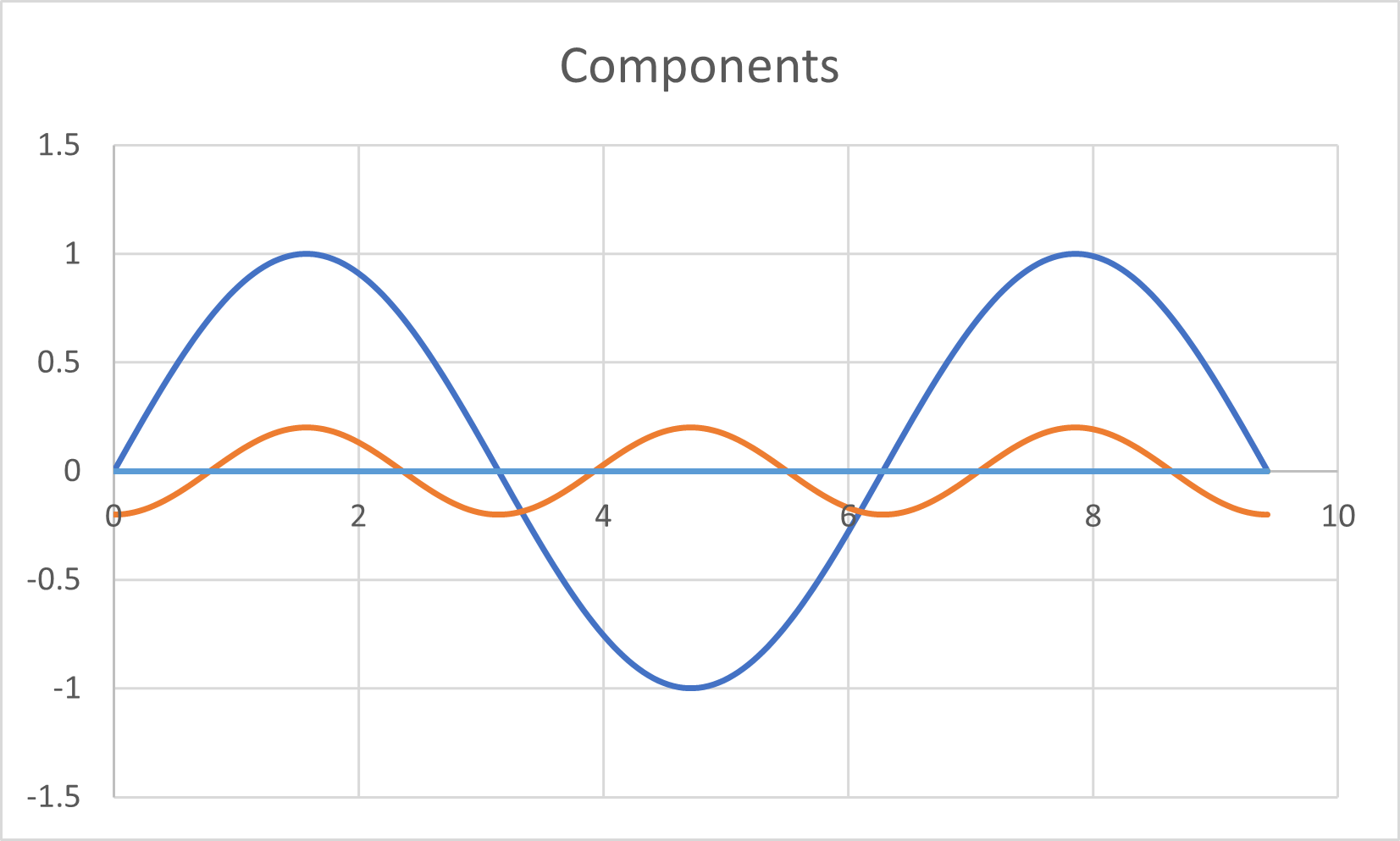

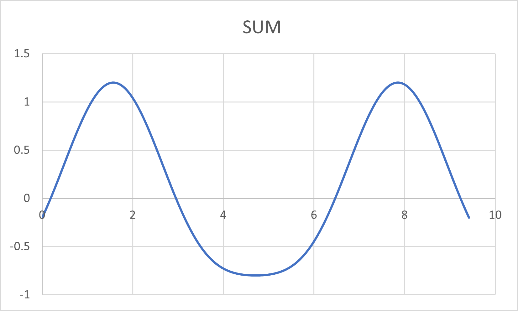

I did some testing of the concepts in Excel to see what happens. After some playing around I discovered that I could use the Chebychev polynomials to create the transfer function curve. The sum of the fundamental and all harmonics generated via Tn(x) is divided by the fundamental to obtain the transfer function. The Chebychev polynomials work nicely and I can generate various TFs that would make sense. An example is attached. In this example I added 20% "positive phase" second harmonic.
What's nice about this? I can still organize the program to generate distortion from the transfer function curve. This can be whatever curve you want. But it is possible to create the transfer function with only specific amount of the desired harmonics via the Chebychev polynomials. This is not easy to do otherwise. And it still provides the possibility of measuring the transfer function of an amplifier and then duplicating that with the plugin.
