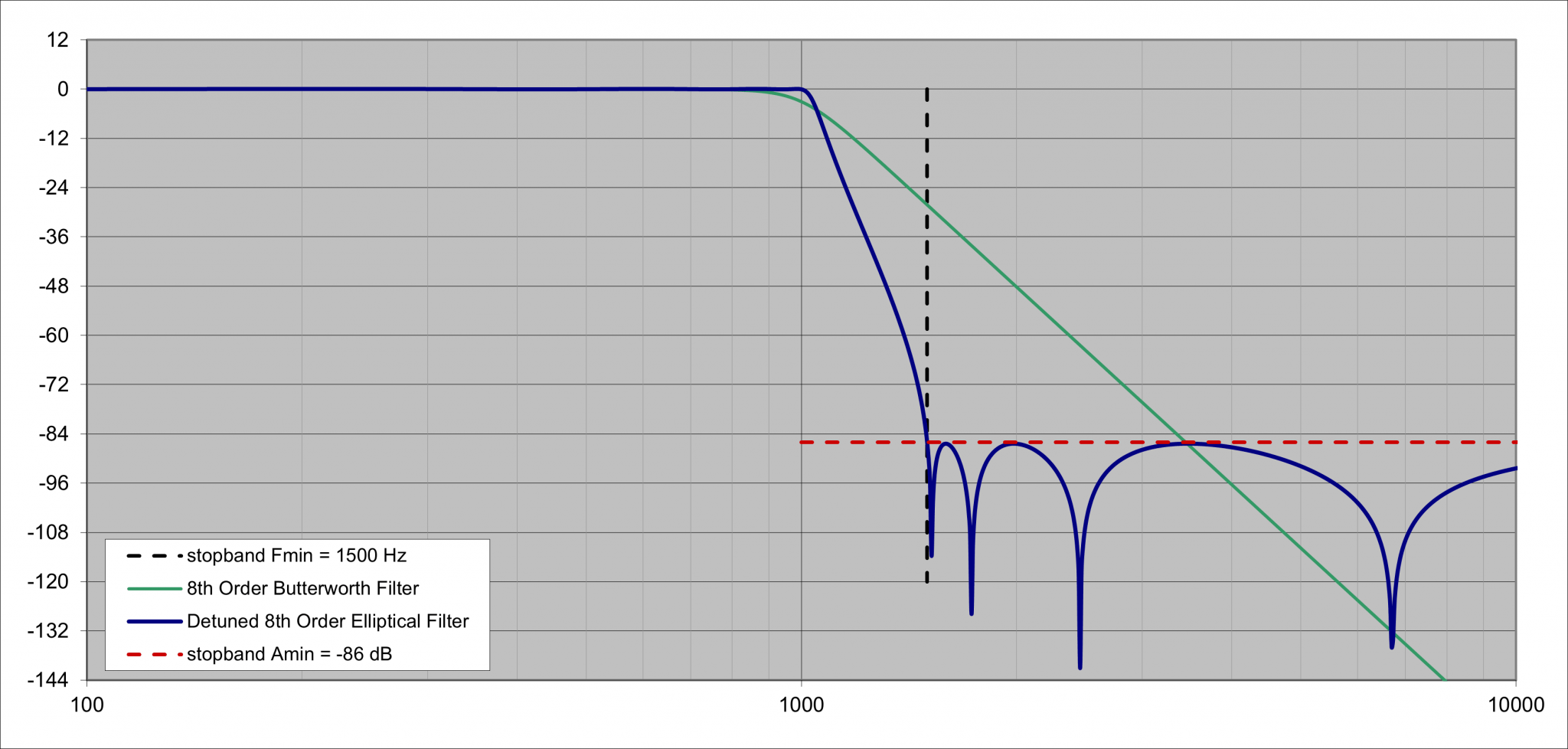

Here is some information about the anti-aliasing filters that will be applied to the side chains:
I have been working up some filters that are derived from elliptical filters and are intended for use in loudspeaker crossovers. These are IIR filters, which I like because there is no need to precompute the filter(s) for a variety of sample rates. IIR filter parameters/coefficients are computed on the fly during startup. Elliptical type filters of modest order can provide very steep attenuation. The response transitions quickly between the passband and a relatively level stopband, and does not continue to fall as you move farther into the stopband. Design of these filters is done by choosing the depth of the stopband and how wide the transition band is - these parameters dictate the order of the filter that is required. I know my way around these calculations and have a nice spreadsheet for calculating them and producing the IIR filter parameters needed to implement them as a series of biquads.
Lowpass higher order IIR filters have a non-negligible group delay profile and the group delay typically peaks around the corner frequency before falling back to zero in the stopband (where it wouldn't matter anyway). The samples coming out of the IIR filter are delayed, and the lower the corner frequency the higher the delay becomes.
Because the filters will be used on the sidechains to prevent aliasing, the sidechain outputs will be delayed WRT the unfiltered signal. Each sidechain will be delayed a different amount because each will have a different corner frequency. Because the delay will impact the phase of the distortion component in the processed signal, we need to "re-align" the output from all the sidechains before mixing them back together into the output. This will be done by shifting the samples by N sample periods (this is just simple digital delay with resolution of sample_rate^-1 seconds). Because I will know the filter group delay profile a priori as a function of frequency I will know how much delay to add to each sidechain so that they mix back together at the proper time.
Also, I could probably offer several filter options. For example, one that has more stopband attenuation than the others, one that has a flatter group delay profile without peaking, and so on.
Keep in mind that, because there is delay in the side chains, this delays the overall output from the plugin. The filter with the lowest corner frequency will cause the most delay, and the required Fc for that filter is a function of both the order of the highest harmonic and the sample rate used (the filters are for anti-aliasing). Restricting the harmonics to low orders and using a high sample rate will minimize this delay.

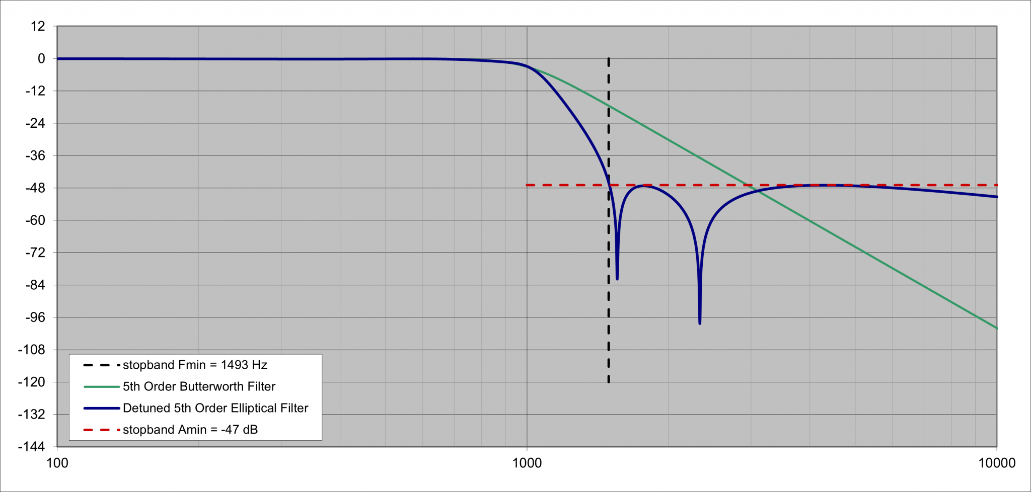

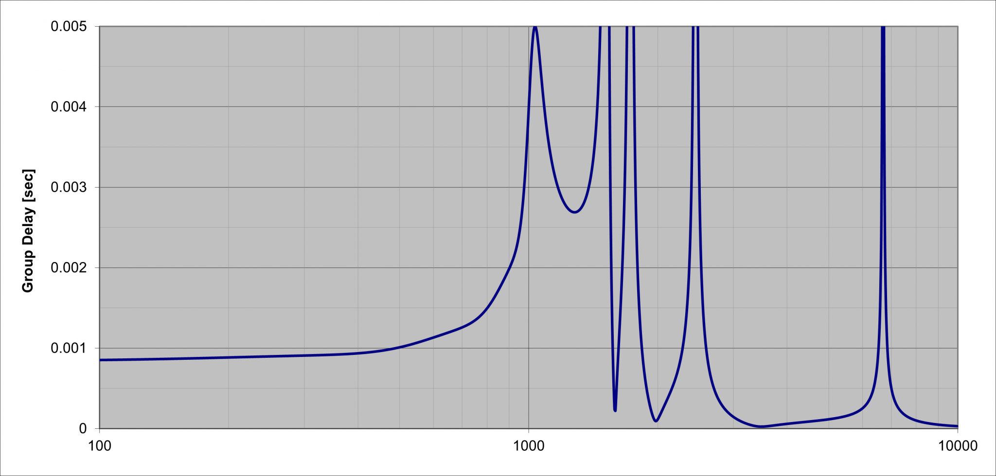

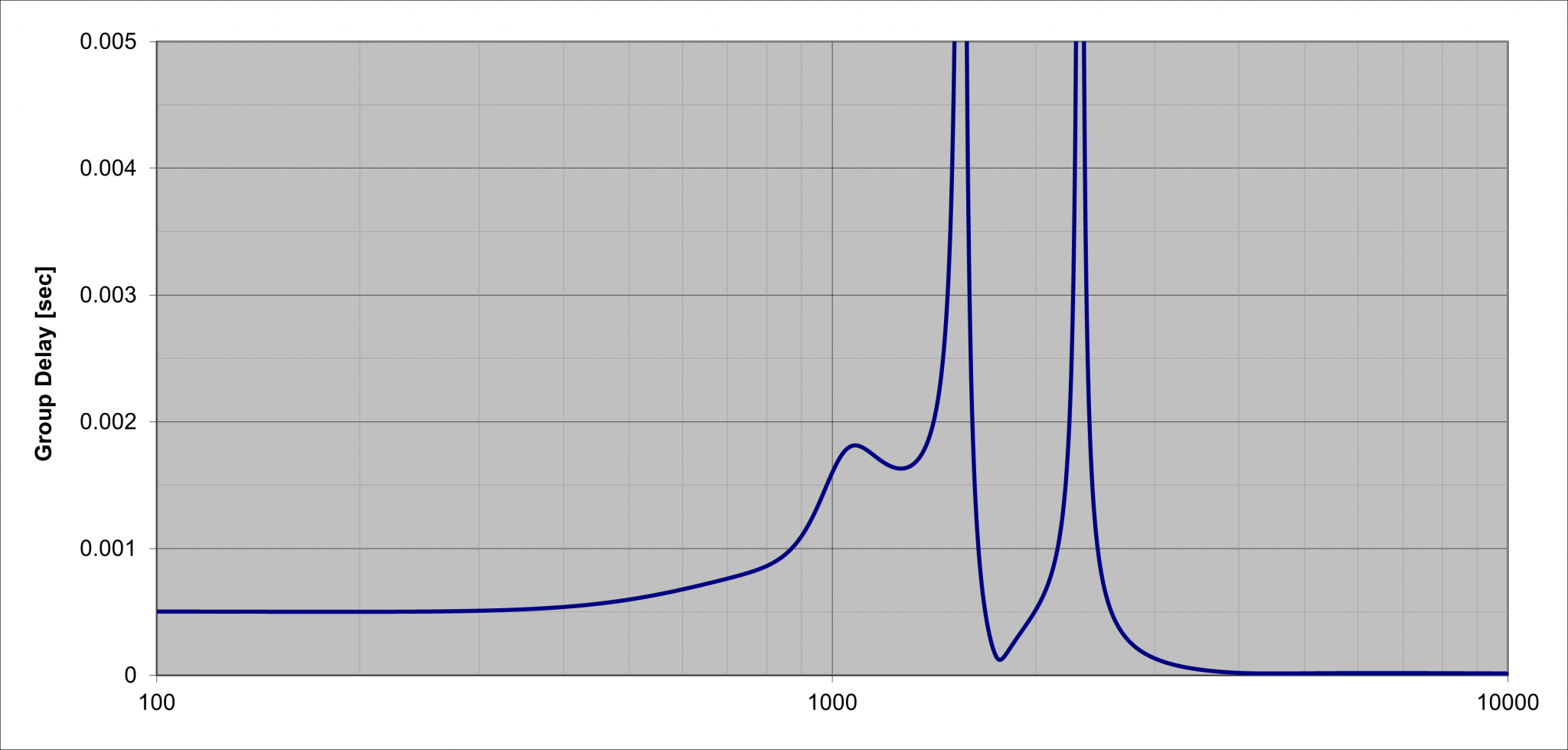

You said:
For example I have attached two plots, one of the lowpass filter response and the other of the filter's group delay. If you look at the GD, it's flat until about 500 Hz where it turns up slightly and then more sharply at 900Hz but the peaking is not bad. Above 1kHz the filter has entered the transiton band and the response is falling, and you can ignore the features above 1.5k Hz. The response gives about 48 dB of attenuation but the requirement for what we are doing is much less severe than for normal antialiasing because the sidechains producing the harmonics will be mixed back at much reduced levels. There are steeper and deeper filters that I can use but in trade they have higher peaking near Fc and higher passband delay. It might be possibly to offer a few different ones or I might just try to find a good compromise and then just go with that.
The filter is not a brick wall and does not reach the stopband until 1.5 times the corner frequency. Since it is the stopband edge that must correspond to the Nyquist frequency there is a partial octave that is occuring in the transition band that would be passed by a brick wall filter. This will happen to some degree (depending on the width of the transition band) for any non brickwall filter. But the result should be just fine.
So IIR is really the best option here IMO, unless someone can change my mind.
You said:
That's not really a good characterization of the group delay profile. When the passband ripple is low the group delay in most of the passband is flat. This means linear phase in the passband, just like the vaunted FIR stuff. The difference comes as you approach the corner frequency. In this region the delay grows and has a peak around Fc. This is "group delay peaking". One has to be careful in designing the filter so that this is not too severe. But I have experience in doing this.With IIRs you'd have to pick between lagging the HF with respect to the input, leading the LF, or some balance between the two.
Here is an example of a steeper filter. Again the stopband is at 1.5 times the corner frequency but we have 86dB of attenuation there. Note the higher peak in the plot of group delay neat Fc (1k Hz). It's difficult to say if this would be audible if the levels of distortion products are only a few percent, that is only a couple percent of the sidechains are being re-combined with the fundamental.
