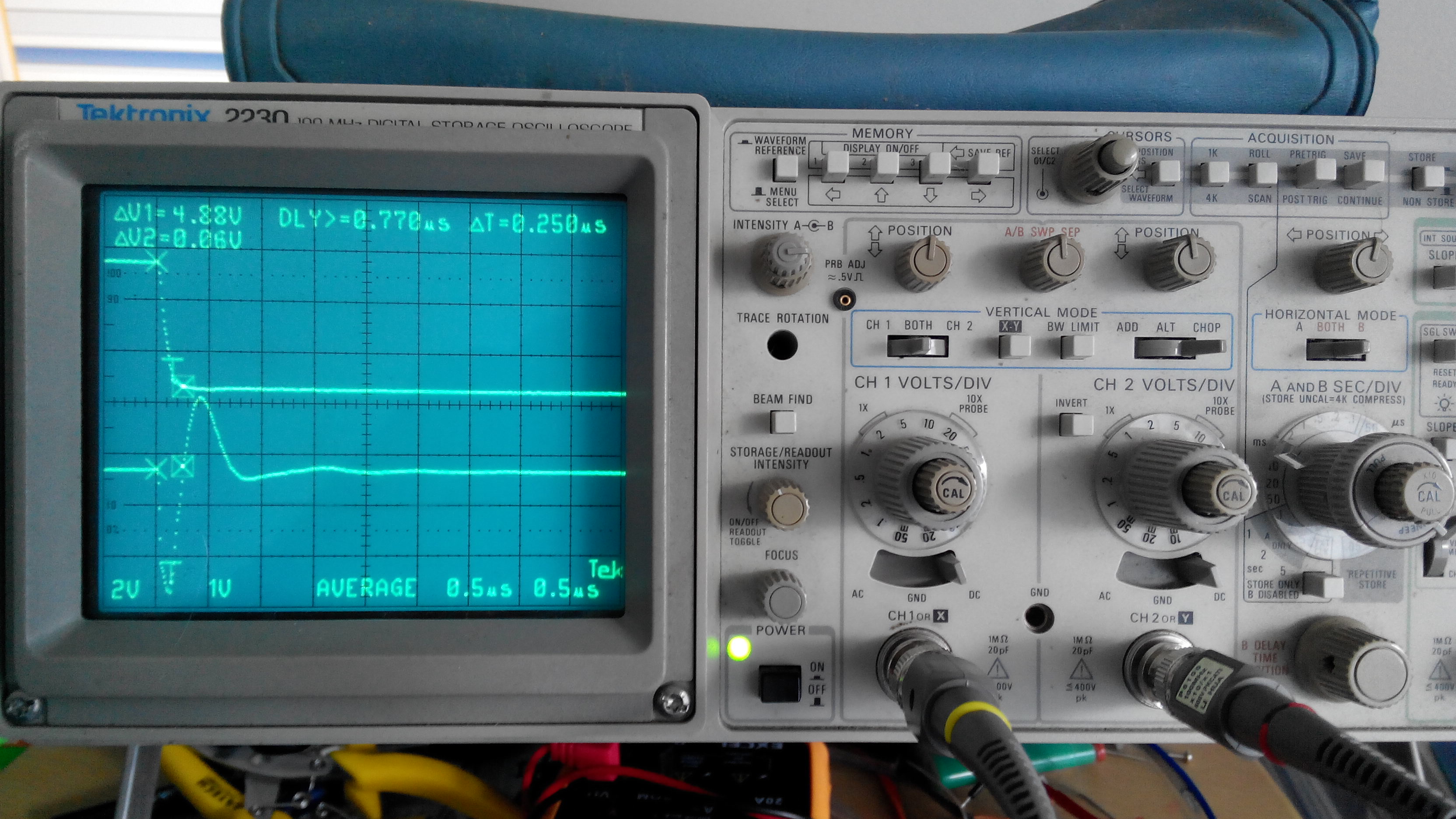

A better attempt

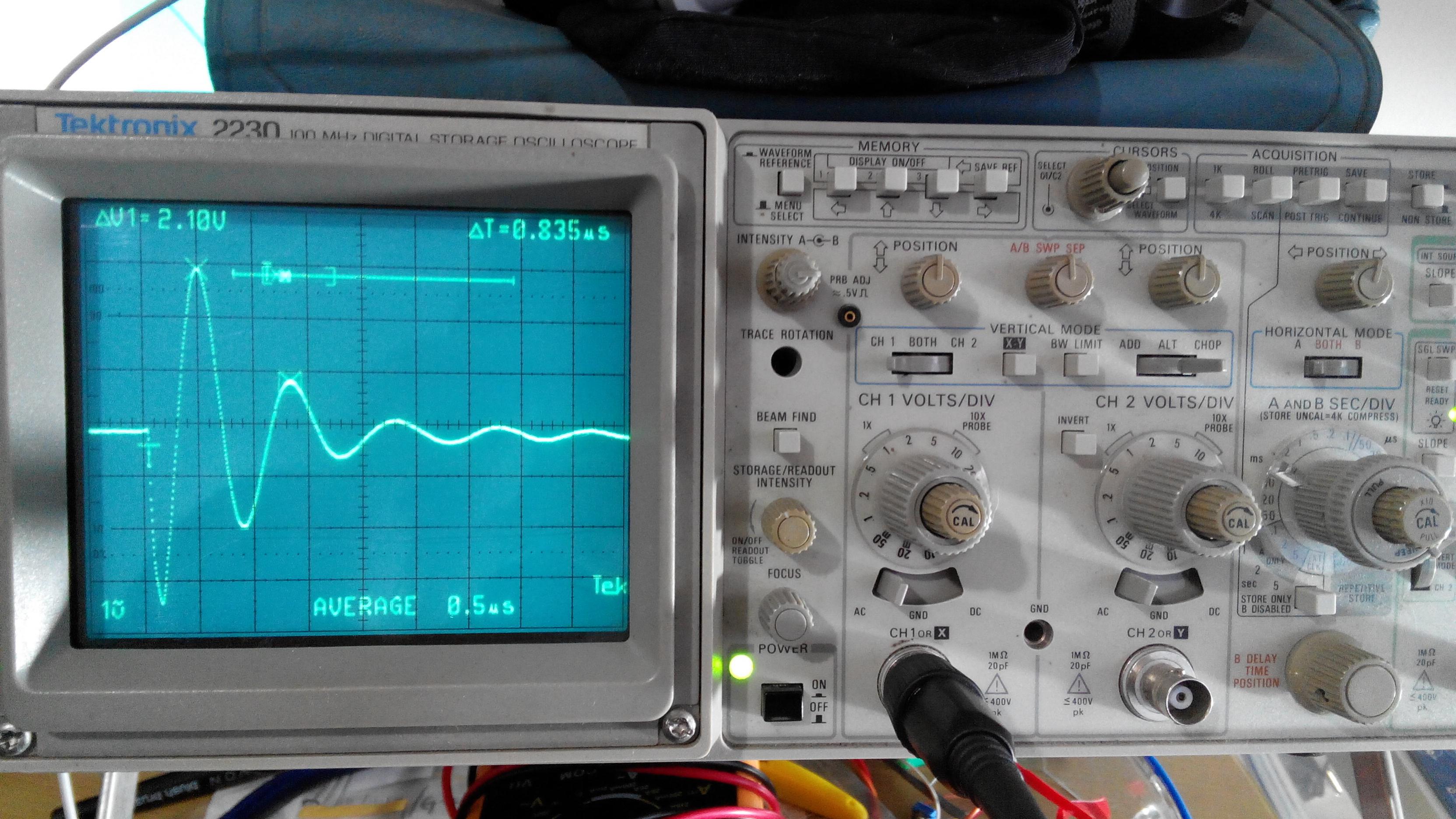

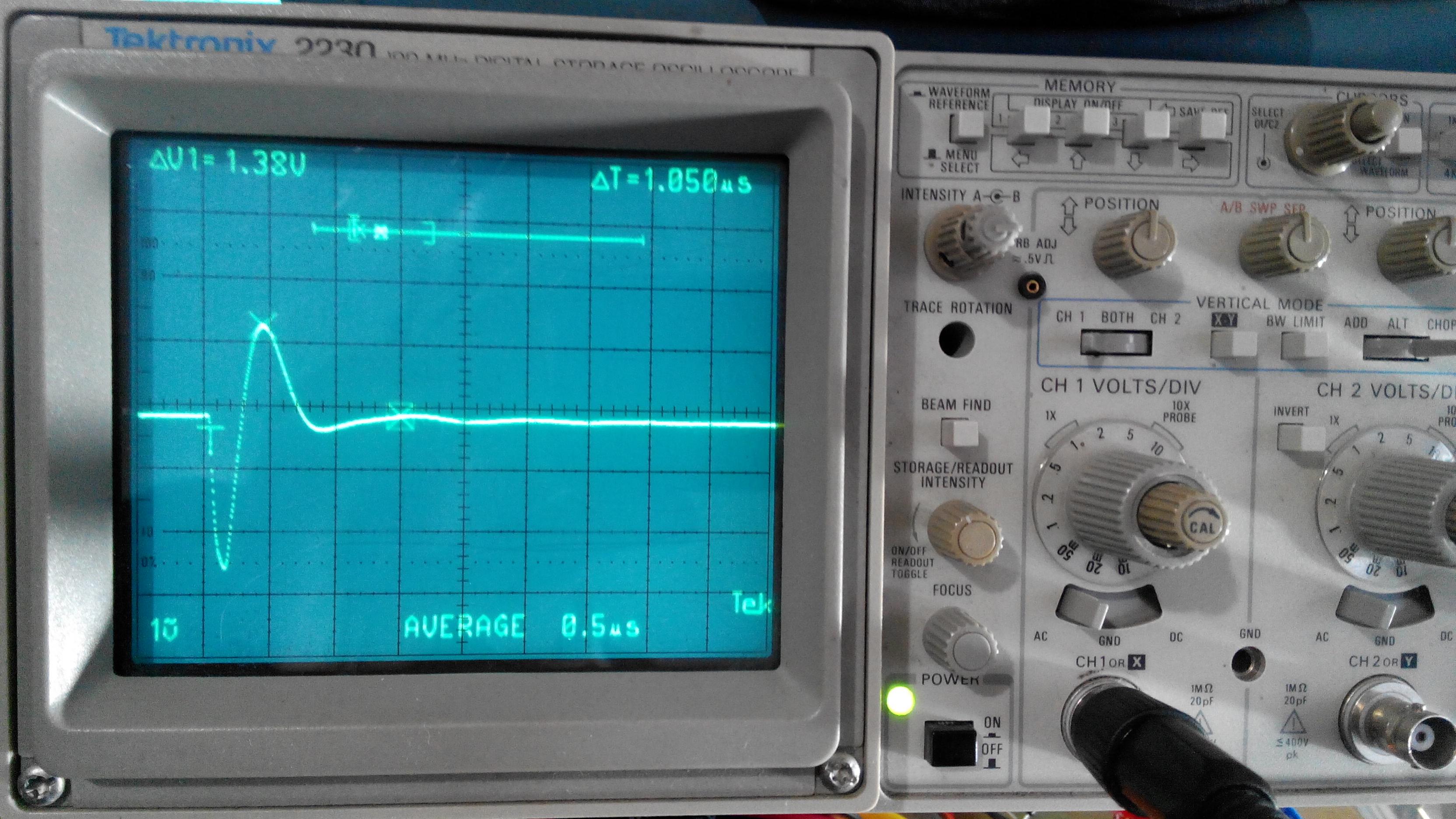

The last set of images I posted were taken with Cx mistakenly 1nF instead of 10nF.

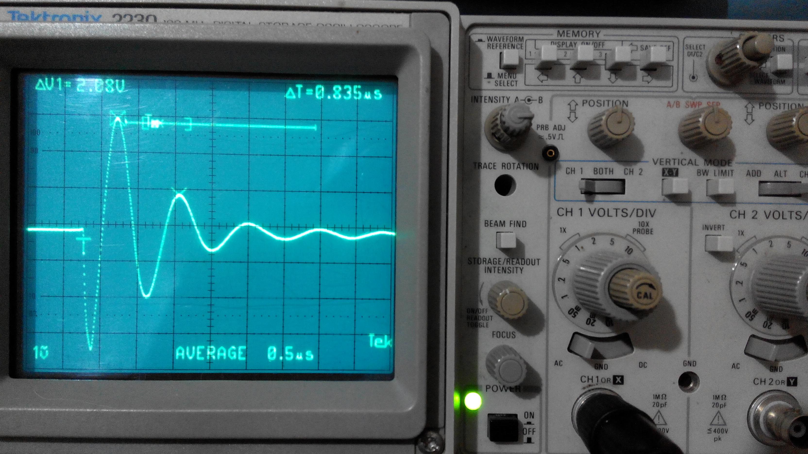

These images were taken with Cx=10nF and the results are quite a bit nicer.
It's a 300VA toroid with dual 18V secondaries. The primary and unused secondary are shorted. Rs for a critically damped system = 20ohms
In operation, the snubber action on one secondary (which is just finishing its conduction phase) occurs when the other secondary is effectively open-circuit (rather than short-circuited as per the standard test jig setup), and the primary winding is connecting to main impedance (rather than short-circuited as per the standard test jig setup).

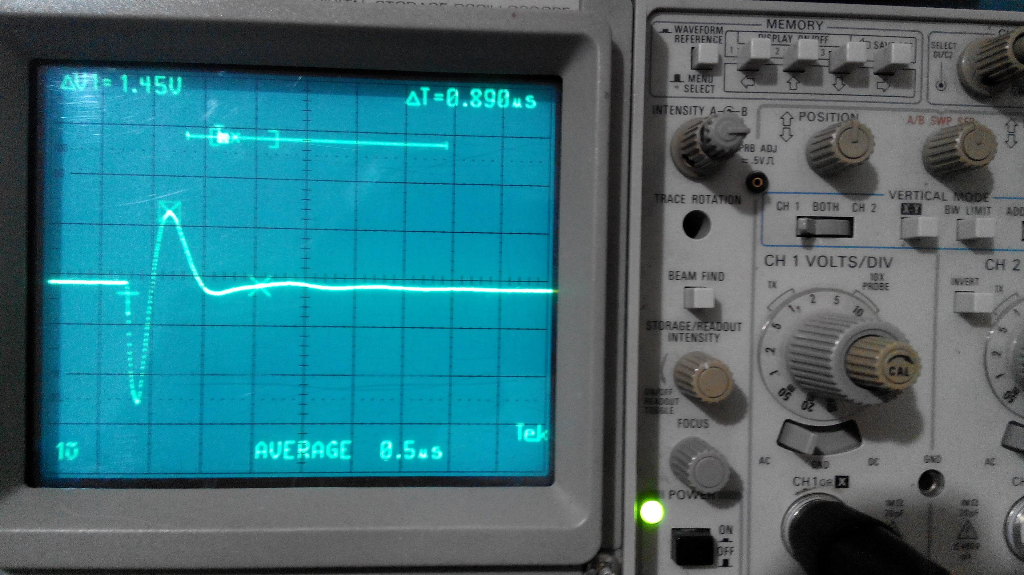

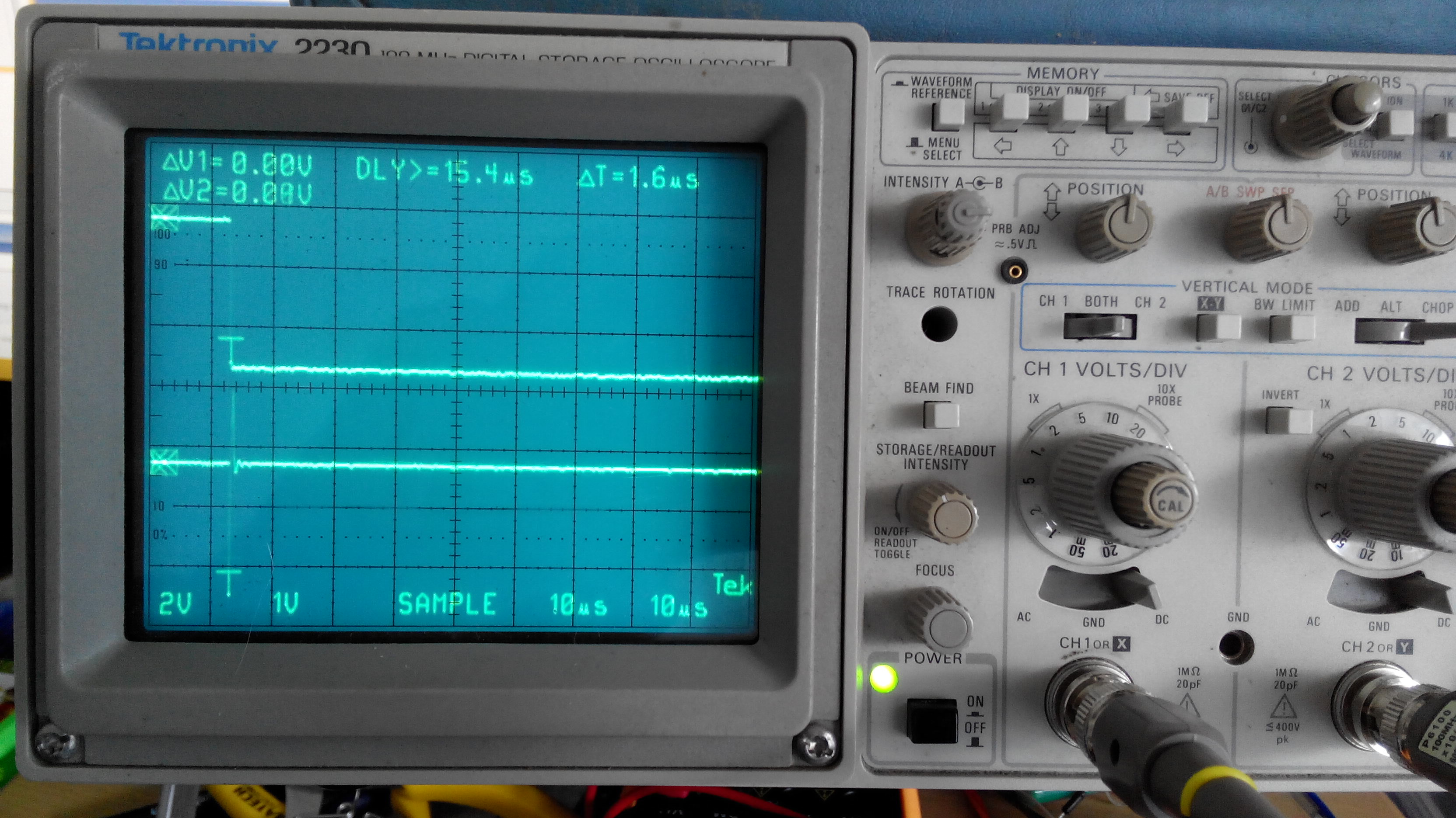

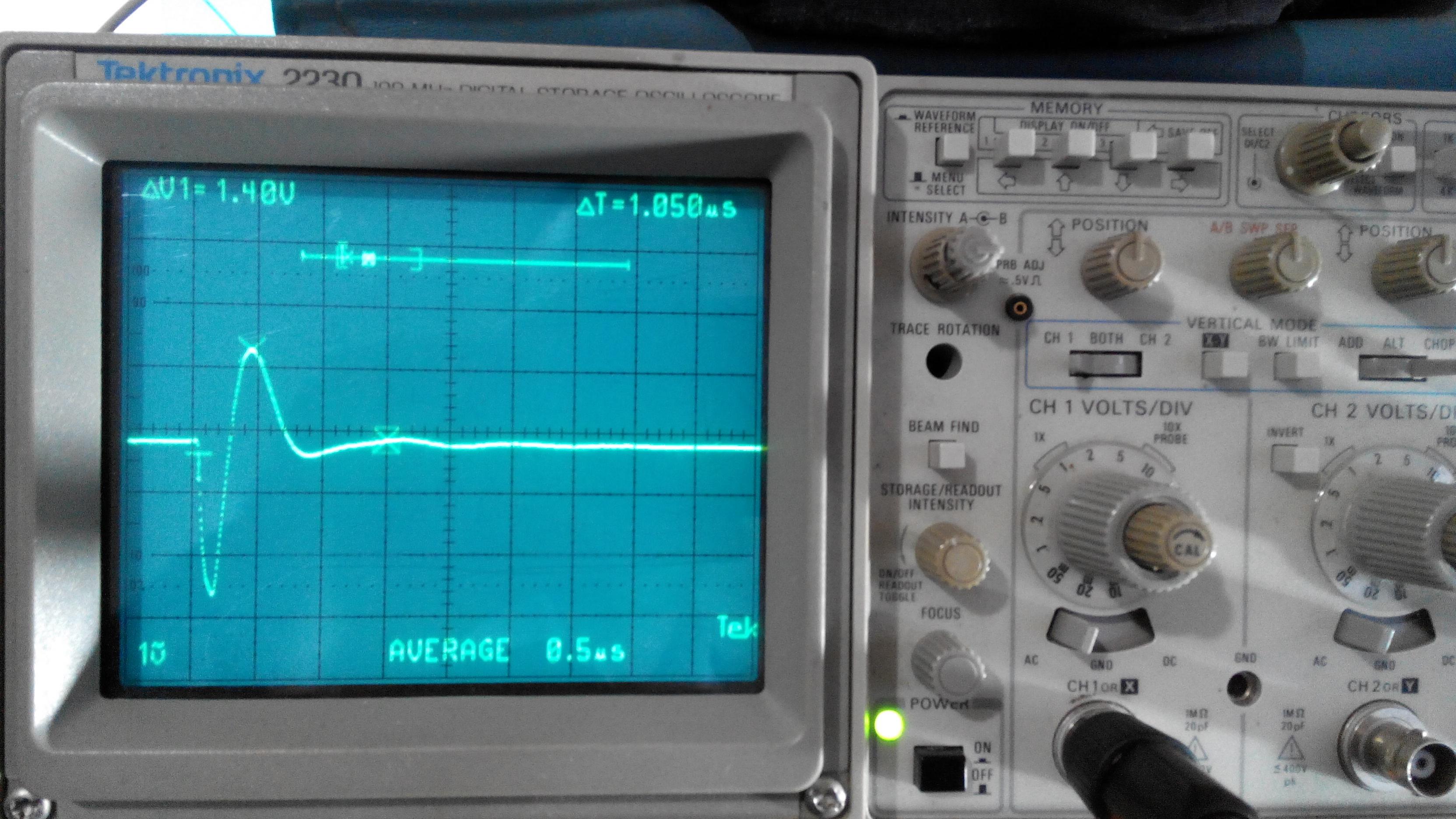

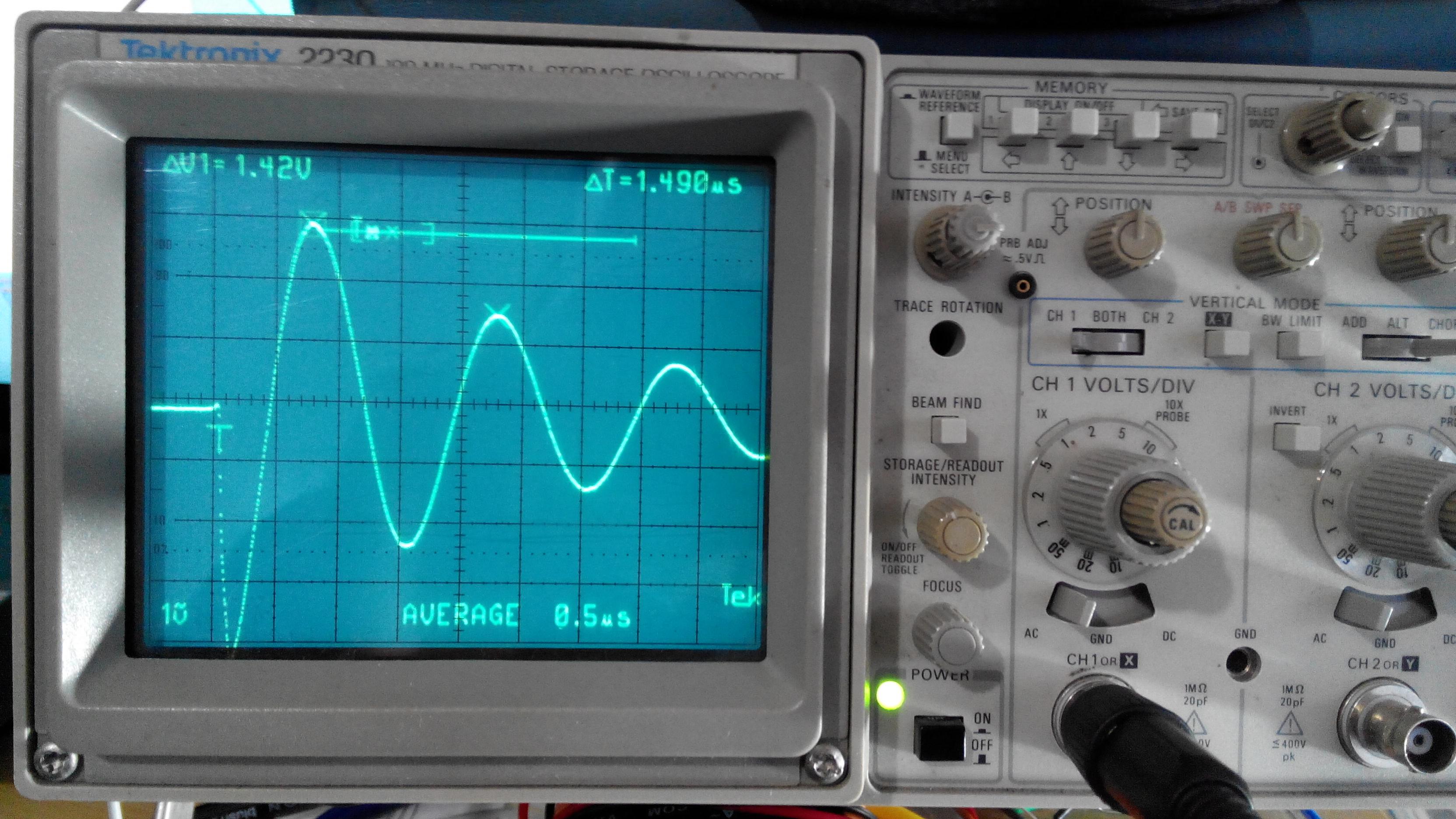

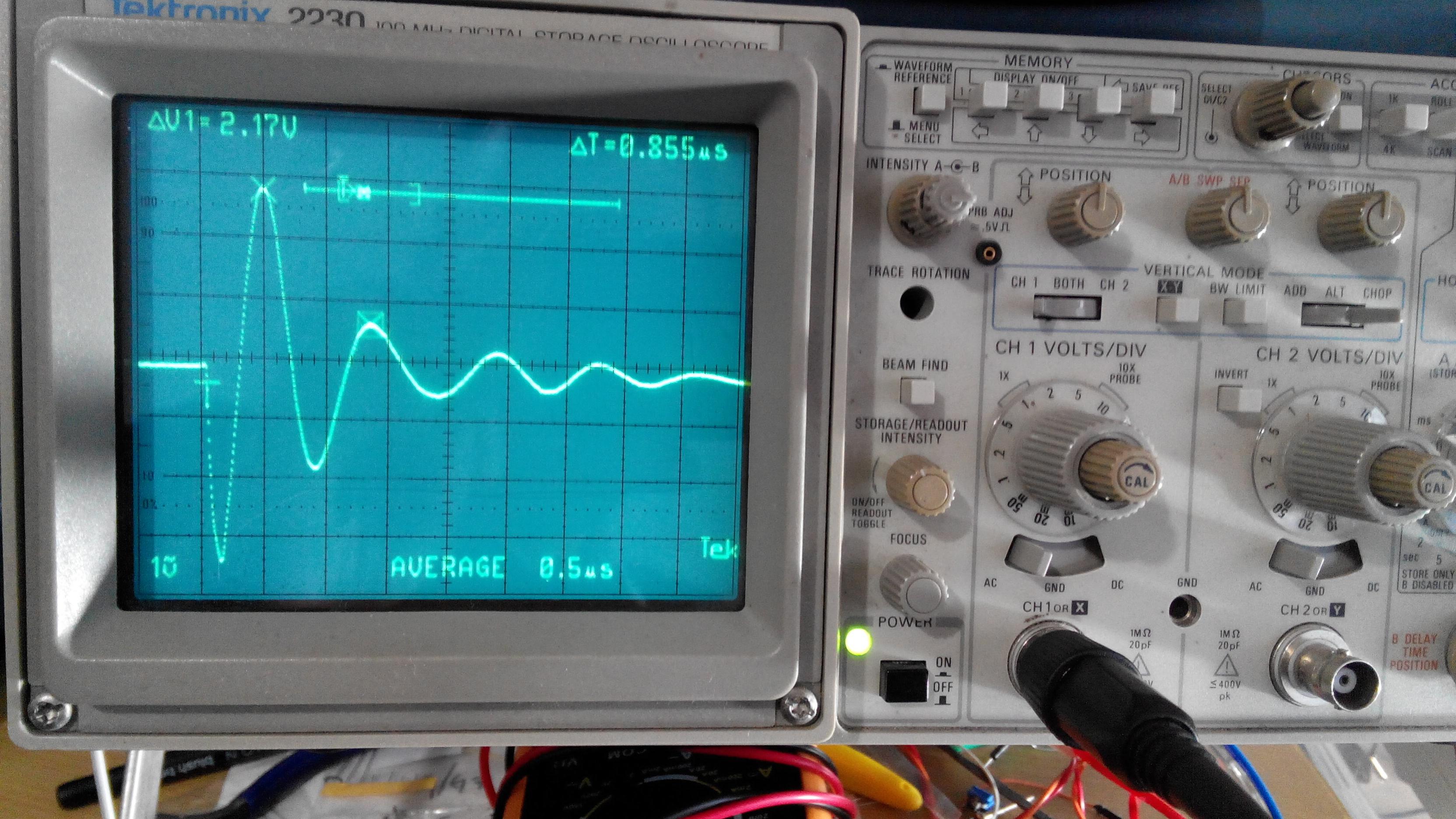

Test results from my setup
So I tried various configurations of the transformer and came to two conclusions:
a) There is almost no difference between testing with the primary winding shorted, open or terminated with 50ohms. It had a slightly slower resonance with it open. 1.17MHz compared with 1.2MHz
b) Shorting the other secondary winding cut the resonant frequency almost in half creating a much more sluggish system.
The snubber used was configured as:
Cx = 10nF
Rs = 20ohms
Cs = 100nF

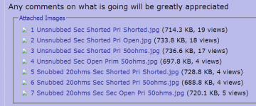

The photos are as follows:
1. Unsnubbed secondary shorted, primary shorted
2. Unsnubbed secondary shorted, primary Open
3. Unsnubbed secondary shorted, primary 50ohms
4. Unsnubbed secondary open, primary 50ohms
5. Snubbed secondary shorted primary shorted
6. Snubbed secondary shorted primary 50ohms
7. Snubbed secondary open primary 50ohms
Any comments on what is going will be greatly appreciated
No, it does not..............The mains ac nominally presents 50 ohm impedance to the primary winding for frequencies where a snubber has its impact -..................
The switching pulse on all these recent plots seem very slow.
Normally we see the switching pulse as an almost vertical line on the screen followed by a return and overshoot, with or without ringing.
The pulse is fast, the return and overshoot are slow by comparison.
That's not what we are seeing here.
For comparison post28 shows a FAST pulse, so fast it is invisible on my PC screen.
The return and the ringing are so much slower we can easily see the plots changing in voltage.

Andrew, the design of LISNs for emc measurement are based on early studies of the effective impedance of domestic and industrial mains supplies. A quick google finds books referencing the early papers - I may be able to dig up the LISN design docs I recall reading that went through the justification. 50 ohm is reached in the 100's of kHz, and certainly by 1MHz. The resonances being snubbered are typically likely to be in the 100's of kHz, or higher.
Oliphant, I notice that changes in a shorted primary configuration, such as Mark's example of 115 and 230V configurations in his excellent write up on the Simple .. 'Quasimodo' test jig, haven't changed the resonant frequency of the measured secondary waveform. That suggests to me no change in effective secondary L or C, and only a slight change in R. The change in Mark's example appears to be a change in effective shorting resistance being experienced.
Your plot 2 shows no noticeable impact of a primary with less damping (50 ohm termination or open-circuit).
Your plot 4 for open other secondary shows a lower resonant frequency and less damped, suggesting a change to the other secondary side's effective L and R.
What is the spec of the transformer being tested? (ie. prim volts, secondary volts, DCR's)
Ciao, Tim

I think you mean that opening the other secondary winding reduced the unsnubbed ringing frequency.b) Shorting the other secondary winding cut the resonant frequency almost in half creating a much more sluggish system.
When I compare picture 3 to picture 4 {numbers and names shown in attached screenshot}, I see that the slower ringing is in picture 4, not picture 3. Leaving the other secondary winding open-circuit has apparently cut the ringing frequency.
However I agree with others who worry that the initial transient (step down) looks waaaaay too leisurely. Maybe your use of a single oscilloscope channel is partly responsible; the recommended setup connects channel 1 to node "DRAIN" and channel 2 to node "SCOPE". Trigger on ch1 and display both. (This post) has a photo showing the probes' connections.
If your scope has a square wave "probe calibrator" feature, fiddle with the risetime trimmers in your probe bodies (at the BNC females); maybe they are accidentally set to schmeer_deluxe. On your 100 MHz (Tek 2230) scope+probes, you want risetime/falltime faster than 5 nsec, and a square wave with a perfectly flat top & no ripple.
Ah yes, that was a typo and a rather large one at that. Apologies to those confused by my mistake. When the other secondary was open the ringing frequency was halved.

In post 28 there's no indication of the Time/Div setting is so it's not an easy thing to make a direct comparison to.
If instead you compare my plots with those produced by Funk1980 in post 15; he has used 10us/Div whereas I used 0.5us/Div.
Compare the difference below (same snubber as in my earlier post #50).
I've connected the probes to the cheapomodo as per Marks post#56.
It could be that my cheapomodo is indeed too slow, but I think a fair comparison is in order before that conclusion is reached.

Oliphant, my eyeball gauges a resonant frequency reduced to 60%. That indicates a doubling of effective L and C due to the influence of not shorting out the other secondary winding.
If the other secondary winding was the same rating, and closely coupled to the tested winding, then that would make sense, as both windings don't have snubbers on them.
I would profer that a test done on a transformer with a dual secondary used for full-wave rectification (as per typical HV B+ power supply in old valve amps), would best be done with the secondary 'not being tested' to be terminated with the target snubber - as that is the configuration being aimed for. There may be little difference between that non-tested secondary being shorted, and being terminated with a snubber, due to the component values in the snubber. In which case the expeditious use of just a shorted secondary on the other secondary should give a valid result.
