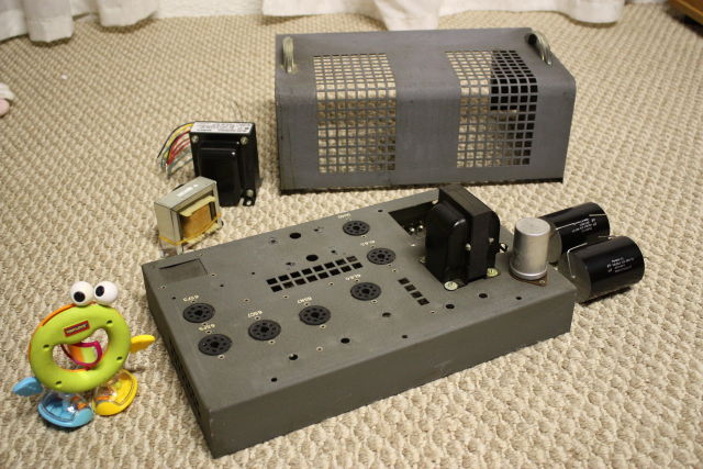

I've been working, very slowly on a project to build a DIY version of the Mr. Millet's Wheatfield HA-2. I'm trying to be cheap as far as the chassis and power transformers are concerned. Cross fingers.
So far I've been cleaning out an old Bogen PA chassis that I'd like to use for this. It's already got octal sockets and a choke so that's less drilling. I've also got a Triad C-14X (6H 120ohm 200ma) choke to use as an alternate, but the ancient choke on the chassis looks pretty beefy and reports as about 80ohms instead, so I'll give it a whirl.
I'm concerned that my power supply may be too small. It's an Allied Electronics 6K56VG (540vct, 120ma) whereas I just discovered to day that the Wheatfield can use a Hammond 270HX which is rated for 200ma. I'm curious how much the 6SN7/6AS7 setup can draw. I figure as long as the current rating is OK I can use a 5AR4 instead of the 5U4GB to get the voltage up, or worst case I can use hexafreds to minimize the voltage drop.

Another thing that has caught me off guard are the Solen 100uF 400v caps I bought for this. They're enormous and won't fit in the chassis, So I figure I'll have to zip-tie the big boys to the top of the chassis and of course insulate the leads appropriately.
I've salvaged some nice terminal strips from a couple of Tektronics oscilloscope modules that will be handy if they fit in the chassis.
So now I just need to figure out a good layout and then do a bit of drilling.
Stay tuned! Pics to follow.
Some candy for everyone. Get a load of those Solens! Turns out they'll fit under the chassis after all. Excellent.
Use SS rectification and a CLC filter. Use as small a cap. as you can in the 1st position, consistent with an appropriate B+ rail voltage. More current can be drawn from the power trafo, when the rectifier conduction angle is large. The smaller the 1st cap., the larger the conduction angle.
I suggest you use a "cockeyed bridge" for rectification. It should cost less than FREDs, while blocking SS diode switching noise from entering the PSU filter. Assemble 2 sets of series connected UF4007 pairs. Snub each diode pair with a HIGH WVDC 10 nF. capacitor. Connect the cathode end of the assemblies to the rectifier winding's ends. Ground the anode end of the assemblies. Connect the anode of a 600 PIV Schottky diode to the rectifier winding's CT. Take the "raw" B+ from the Schottky's cathode. By itself, the Schottky diode's speed keeps PN junction diode switching noise out of the PSU filter. The UF4007 assemblies are snubbed to keep switching noise out of the power trafo, where it could get into the tubed circuitry via the heater supply.

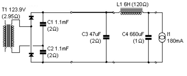

So here's what I think I can do for the PS. I'm going to leave the PS outside of the chassis, where I've got a medical grade twist lock plug and socket that I can use to keep anyone from accidently plugging the amp into mains.
For the voltage doubler I'll use four 2200uF 100v, two wired in seiries to get up the voltage rating which should be good for 1100uF 200v. I was going to use these for something else, but this comes first. If the voltage is too high, I can use 120uF 450v caps instead.
The rest is by the book. If the voltage is too high I can use the smaller 1A isolation transformer.
I'll also need to find a way to cram a power switch and a soft start circuit into the oneac's little chassis.

Using the above config the heater transformer will have it's own connection to the mains. I figure I should also mount a DPST switch, one side for the heater transformer's primay and one side for the B+ secondary, just to be sure I don't accidently turn on the B+ without the heaters running.

IMO, C3 in your PSU schematic is going to buy you very little. Given the tiny conduction angle associated with those huge caps. in the doubler stack, it is inevitable that LOTS of "hash" is going to be present. I suggest you replace C3 with a LC section made up of a 6.8 mH. RF choke (Mouser stock # 542-5900-682-RC) and a 1500 pF. cap. of either mica or NPO ceramic construction.
Kill the worst of the "hash" off before it reaches the main filter choke whose internal capacitance acts as a short circuit to RF energy.
Don't forget to protect both the power trafo and the tubes by adding inrush current limiting to the B+ PSU.

apart from what Eli says I would resim your psu arrangement with more realistic values, like for transformer resistance and the first two caps in the doubler. Will not make a very big difference but depending from what transformer you are going to use your results might be off...
I built a two-toroid psu with a voltage doubler myself for my Aikido headphone amp and I can't comment on conduction angles ('cause I don't have a clue to be honest), but I am using a mains filter right after the IEC socket. 😉 From all the headphone amps I built this one to my ears has the 'blackest background' sonically.
Coming back to the topic of this thread I also am kinda interested in the HA2 for quite some time and actually have gathered most of the parts except for the iron. I also went at the schematic and did some changes that can be seen in the attached schematic. Any comments on this are very welcome though I hope this doesn't qualify as threadjacking 😱
About the current draw of the original HA2.... are those 180mA real?
Sort of reverse simulating the original Wheatfield psu in PSUD2 doesn't give me nowhere near 300V...? So far all the psu's I built were basically spot on to the simulation, so that leaves me puzzled.

In a cap. I/P filtered PSU, current flows in the rectifying diodes only a small portion of the 360o sine wave. That's the conduction angle. As the I/P capacitance increases, the charging pulses get shorter, while increasing in current.
All cap. I/P filters exhibit a "triangular" ripple wave form. As I/P capacitance increases, that wave form becomes more and more "sharp". The Fourier theorem tells us that "sharp" periodic wave forms contain considerable high order overtone components.
The HUGE capacitance Phil intends to use will crush the ripple fundamental, but very considerable overtone energy (well into RF territory) will be present. The LC section of a RF choke and small cap. I suggested "dulls" the ripple waveform down to the point that the main inductor and reservoir cap. can finish the job off. The background will be very black, indeed. 🙂
BTW, ferrite beads on the primary side of the doubler trafo suppress the propagation of "hash" in to or out of the PSU.
