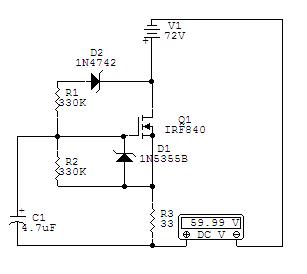

Has anyone here actually tried and built a gyrator? Looks very simple (and is easy to read for me since it's in german) and easy to implement...

I've got all the parts for the Gyrator. A couple translated points. X1-1 is the input or the + side, and the X1-2 is the output, or negative. It would also appear that increasing the value of C1 also increases inductance.
There are some things about the Gyrator schematic that Ist nicht klar.
What voltages can I expect on C1. I got a 4.7uF rated for 450v just to be safe, but I also suspect that the voltage shouldn't go much past 15v there right? I've also got a 10w resistor for the 33 ohm where I figure that's where most of the juice will be flowing. I just happen to have two 5w 330k resistors, which may be overkill so I could possibly mix and match a couple 1/4 w resistors if possible to get 330k. I figure I'll stick with overkill while dealing with the unknown.

Have you built the gyrator yet? I'm going tod do the same but for lower voltages and to drop 72V DC to about 60V for use in a 150W SS amp. I'm interested in your experience - I'll be using the same circuit but possibly putting a zener in there to regulate the V out.
I've got all the parts, for a gyrator, but I haven't gotten around to putting something together yet. I want to be able to prove that it really works, so I've been trying to resurrect my Tek 531 so I have some sort of proof. It turns out that the 53/54C plugin doesn't seem to like the 531 oscilloscope and I parted out the two other plugins that I had that probably would have worked.
