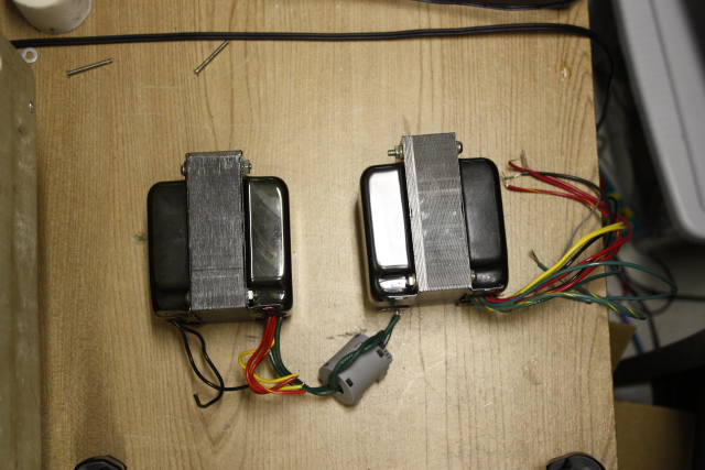

I used to do FCC certification back in the 90's so I've developed the habit of saving all the ferrite blocks off things before they hit the dumpster. I'm set there.
For all practical purposes the isolation transformer approach would be cheapest. Especially since you can often pick them up cheap on the 'bay.

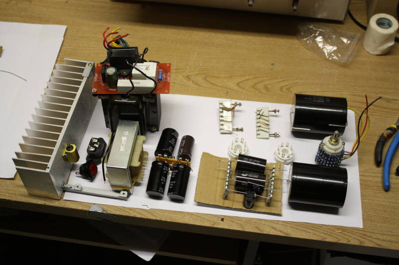

I'm still pondering layout. I've got an enormous 8 X 4 X 2 heat sink that I'd like to use for the 6080 cathode resistors. Way overkill, but it's awesome and I have to use it for something.
I may just kinda wing it. There's not a lot of parts. They're just bulky. I figure I'll just layer my way up. So here's the plan:
Mount the big iron and most hardware.
Mount Heatsink.
Mount terminal strips.
Wire in the heaters, B+, and grounding.
Capacitors.
Resistors.
Finish any remaining bits.

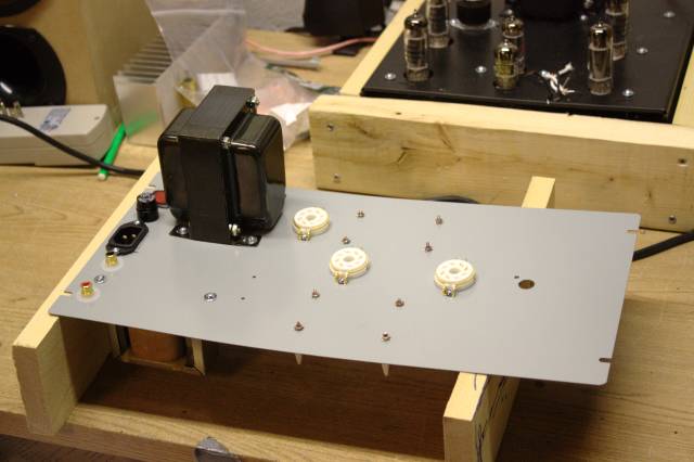

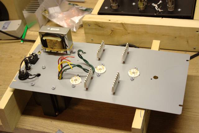

I stared and stared at the old Bogen chassis and came to the conclusion that it wasn't worth trying to shoehorn everything in there. So I'm ordering a cheap 16 x 8 steel plate to mount everything on along with three sockets. I've made a paper template so I have a guide for cutting holes into the plate. I'm much happier with this layout. The sides of the chassis will be pine for now, which will make a nice little cave for all the parts to fit in.
The terminal strips will have most of the circuit on them. One side will be hot and the opposing strip will be grounded.
The circuit board sitting on the power transformer is a Chinese soft start circuit that I bought for another project but never used. The heat sink is large enough to be the back end of the chassis.

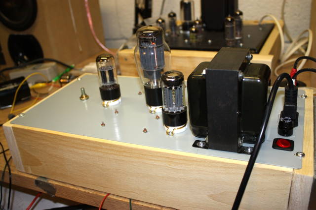

Good news. I was able to steal away enough free time over the holidays, especially today and I was able to do a smoke test.
Holy Shitake Mushrooms! This amp rocks. I was stunned that the amp worked on the first try. And then that it sounds better than anything I've ever heard. The ER4S headphones are normally a bit dry, but after putting on T.I.'s Paper Trail I though I was in one of the souped up Hondas that go bass'n down my street. Charlotte Church's performance of Ding Dong! Merrily We Go. gave me goose pimples.
I tried both the ASC and Solen output coupling caps. I don't know if I can tell the difference. I'll have to try again later. I'll probably use the Solens either way. The $5 ASC's are worth a look though, vs the $35 Solens.
The heatsink is undoubtedly overkill. It gets warm, but not hot.

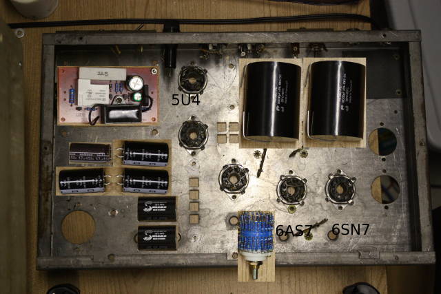

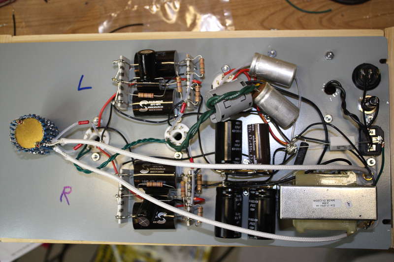

Here's a shot of the almost completed undersides. I'm not gonna win any awards for my point-to-point work.
I should also mention that I've decided to use a 5AR4 rectifier instead of the 5U4GB. With the 5AR4 the B+ sits at about 296v which is just about on target.
I was going to use a single 47uF cap before the choke, but I began to get nervous about that. It was either that or a 33uF. Turns out I had some unused Mallory 20uF 450v cap laying about so I paralleled them for 40uF. So the 47uF just ended up doing work on the other side of the choke.
I do have a bit of heater hum. I may have some tweaks to help that some. What I don't understand is why have the heater primaries grounded with 10 ohm resistors? I sent those to the star ground, but it just doesn't make sense to me.
