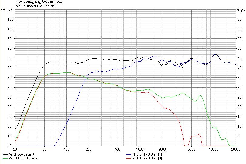

In response to the curve, I might be missing something but shouldn't the lines for the two W130S drivers match up i.e overlay on top of each other so you only have one curve as it were for both drivers?
Ewan
It's ok - I wired them in series. The inductance of the extra voice coil means the XO frequency/rolloff is changed a little, but it doesn't look too bad from where I'm standing.
Chris
Ok, I must not be doing something right with my simulation then as when I put my W130S in series the plots lined up. But then this is my first stab at trying to simulate a speaker so my understanding/theory is probably not all there, maths/calculations have never been my strongest skills 😱

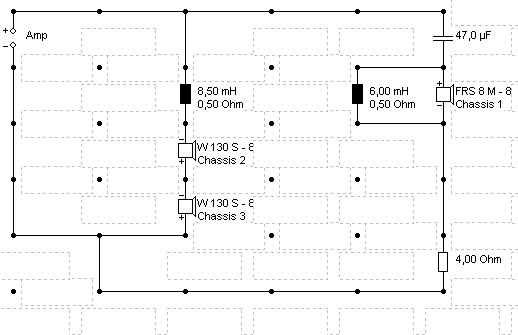

Would you be able to post a schematic of your crossover so I can take a look?

At the moment, no - I'm still trying different speakers etc, and I don't have the correct XO stuff. However, it will be a 8mH inductor (calculated) in series with the two woofers, then a 2nd order HP filter at the same XO frequency.

The 4 0hm resistor is to reduce the rising top end a little - seems to do the job, as I got a lot smoother output with it than without. Still experimenting with the resistor in series, will do the same in reality aswell.
Chris
PS - around 6 ohm resistor is looking good.

Thanks for the schematic. After my post yesterday I went away and did some more reading on crossovers and came up with a basic 2nd order Linkwitz-Riley arrangement that worked better than my previous attempts.
I wonder if the resistor approach can be improved upon to help tame that rising top end on the FRS8M, might have a play and see what happens.

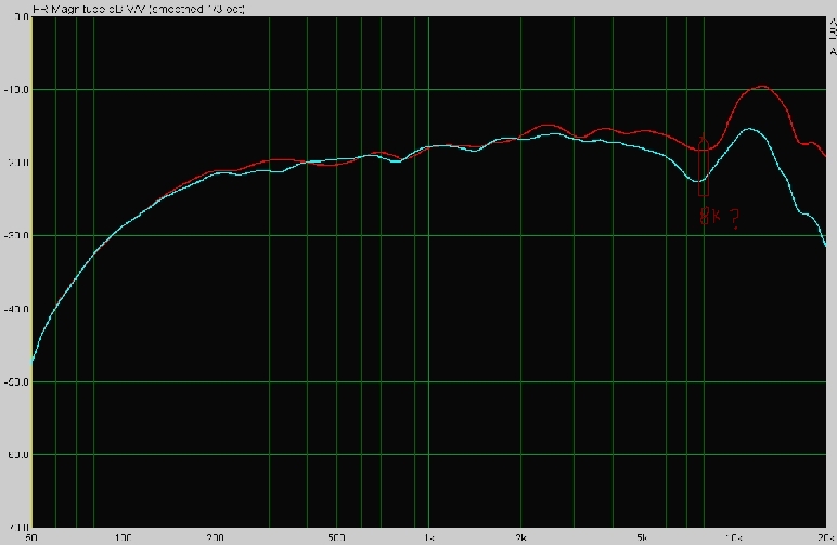

I find it's trying to get rid of the 10kHz peak that's difficult - I've tried inductors at various frequencies, but nothing seems to tame it too well, also, 6dB/octave is too steep. What I need is some kind of 3dB/octave thingy. I'm considering the purchase of a graphic EQ, but at £100 for something half decent, it's not cheap.

so the 10k FRS8M peak is bothersome then.
a well known 'notch' here -> Parallel Notch Fliter Designer / Calculator
(might require tweeking), or maybe use a very cheap tweeter from 8kHz Ist order?
just trying to help, Grant .. I'm keen to buy 2 of those.
After playing music for a while longer, it has settled down.
Looking at the response charts, it's pretty similar to the FRS8, with with more sensitivity. Using the FRS8, I didn't notice the peak, and, now they have bed in properly, I don't notice it now.

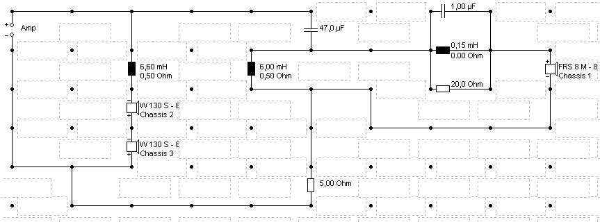

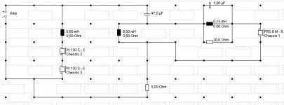

The calculator in the link didn't seem to go down too well with BoxSIM, so I messed with my own values, and got this in the end.
I don't think this is necessary, but it might still be worth a look.

Nice work on the notch filter, I had tried implementing one using the calculator posted earlier but like you discovered that it didn't seem to perform properly in boxsim.

Your diagram is correct - the peak begins at ~8kHz, and finishes around 12kHz, with around 8dB peak centred at 10kHz.
If you do a sweep, this is audible. Listening to music, however, and you can't tell it's there.
