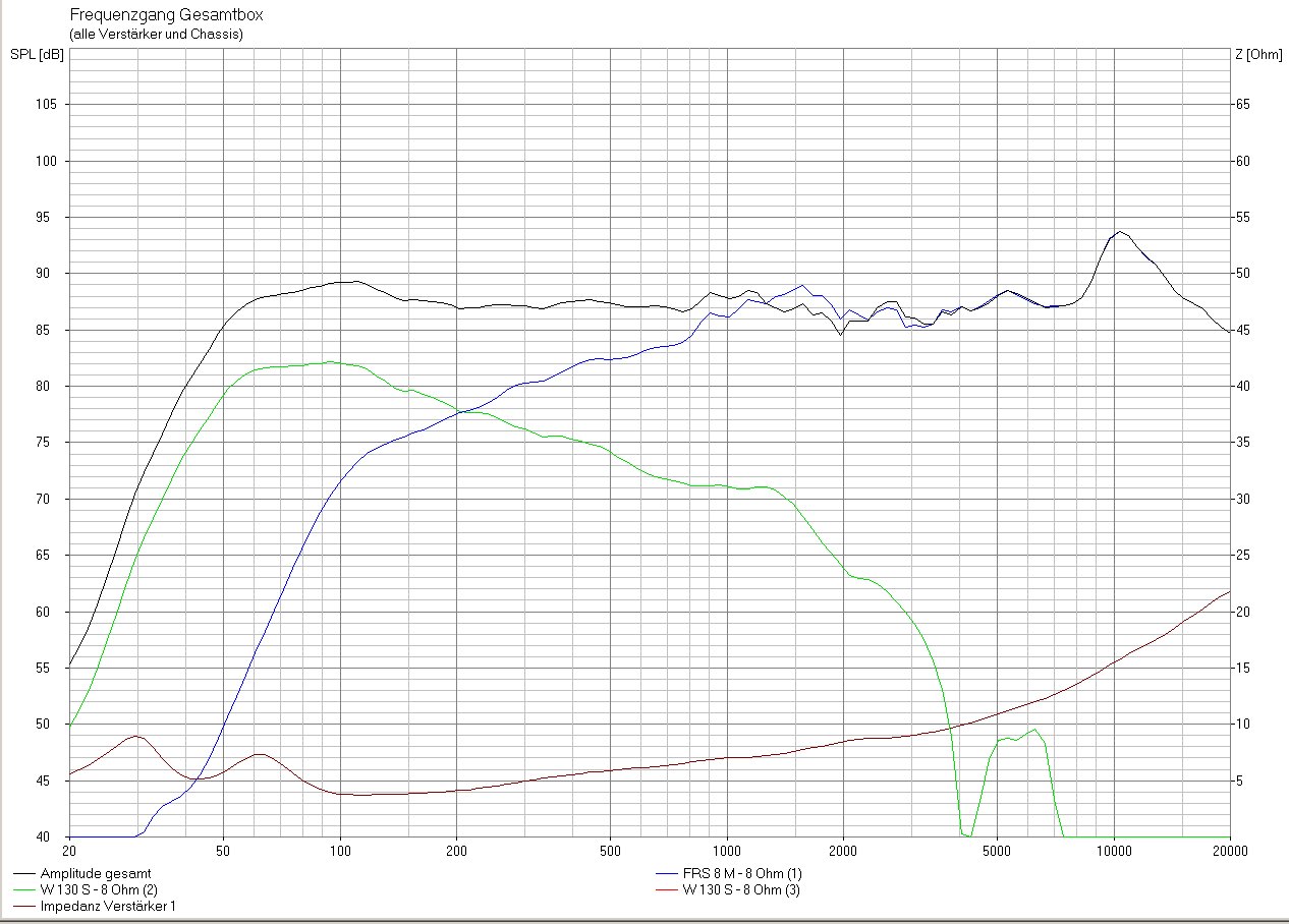

Slight confession here - I've been listening to the prototypes with one crossover wired up (a bit) wrong. I've ended up with a 150% error in the inductors...
Will sort that now.
Chris
Pretty graph of what I currently have is attached.

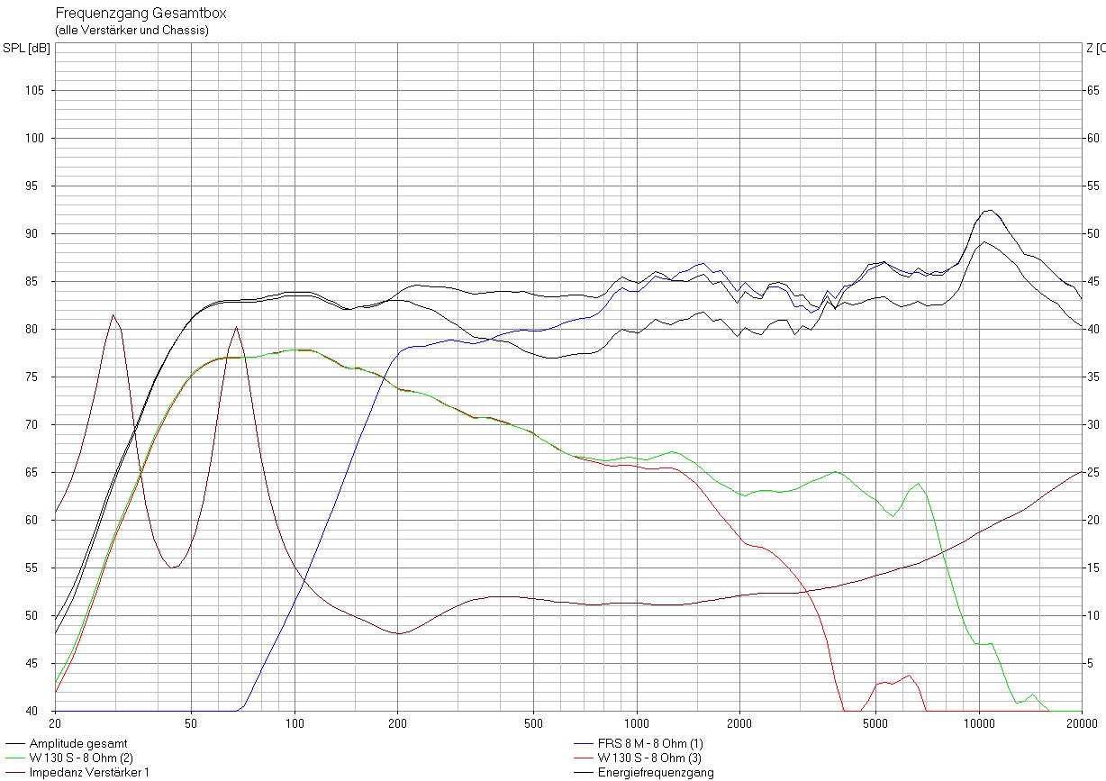

Just messed around a little more and discovered the following:
This is a really neat bit of software
Reversing the phase of the woofer gives a much nicer response curve
Chris

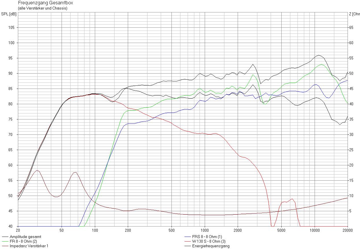

Been playing around with Boxsim and your idea of 2x W130S per cabinet combined with an FRS8M and the plot attached is what I've bodged together so far. The W130S are in a 21L BR tuned to ~43Hz and the FRS8M in a 1.5L sealed enclosure. The plot looks ok to me but I'm no expert in speaker design and I'm sure there are flaws with it.

I find it a little strange that winISD gives an f3 of 42Hz using a box size 17L, tuned to 46Hz, but, when I attempt to recreate that, I get an f3 in the mid-50s.
Seems to me like a 4ohm resistor in series with the speaker will help to tame the rising response a little. The speakers have arrived at the depot, Dad's picking them up tomorrow.
Chris
PS - just seen the phase plots, and it's no wonder there's a drop in frequency around 50Hz - the ports are (for some reason) completely out of phase with the woofers.

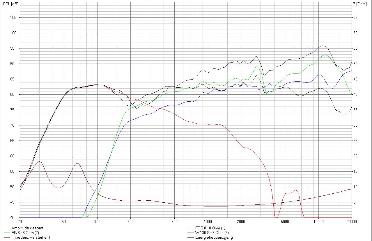

Ah-Ha! - the bass response is affected by the stuffing in the sim. Use the sliders when you select bass-reflex to change the amount of stuffing.
Chris

But back to the speakers, there are lots of interesting little things in Boxsim that I've only started to discover by playing with it. One I found today seems to optimise/tweak the crossover based on a series of parameters such as whether or not you want strong bass response, more treble etc. It's the Weichenoptimiser option under the Extras menu if your interested.

Back on topic - what do we think of the response curve? good enough or could be better?
