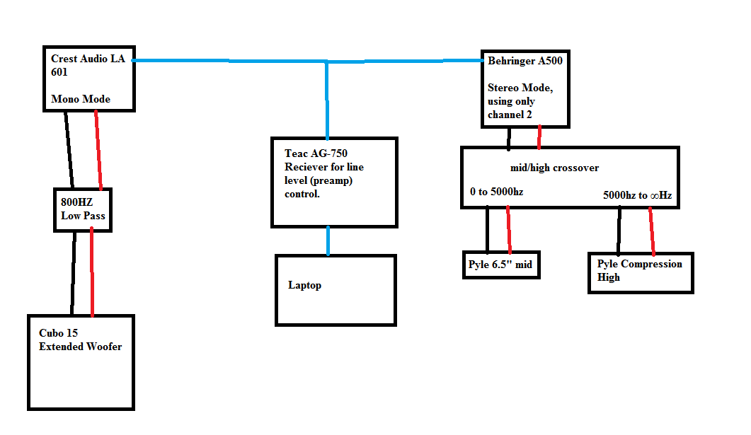

i hope it wasn't your x-over configuration turning into a bad/weird reactive load that hurt the la601
do you have a way of uploading a pic or diagram of how you had this all wired up?
I can give you a diagram of how it was all wired. Gimme a sec.
I'm not really sure how the crossovers could've hurt the amp.
And really I think the cap was bad the whole time, considering the behavior of its power lights, but the diagram (hopefully it tells you something) is in my above post.
Oh and if you want you can take a look at my thread I made just for the amp repair: http://www.diyaudio.com/forums/solid-state/250442-crest-audio-la601-repair-help.html#post3803526
well looking at your diagram raises more questions for me than it clears up.
first what prevents frequencies below 200 hz getting to your closed back midrange?
the next is without more details on the 800 hz low pass how can you be sure it's not looking like a big reactive mess to the amp?
Nothing prevents frequencies less than 200hz but I can't say I care. Unless it will cause some huge stability issue, I think I'll just continue to not care considering it sounded great until the amp blew.
I don't know what exactly you mean with this reactive mess stuff. I buy a pre-built crossover from a good supplier that is made to be on an 8 ohm woofer, and I connect it to an 8 ohm woofer and I expect it to just plug and play. Are you saying it is not so?
You can look at the parts-express page for it if you want: 800 Hz Low Pass 8 Ohm Crossover | 266-450
One thing I should mention, it is possible that I was going over the 250watt RMS on that crossover. I have no way of knowing considering the Crest Audio LA 601 does 550W RMS in bridge mode, however I strongly think I didn't go over 200watts (thought I really couldn't tell you).

an iron core on an inductor meant for audio?sorry that just spells bad to me!
and as far as your mid's go hav' at 'er they're cheap!
Why is an iron inductor a bad thing?
Correct me if I'm wrong but your concerned that sub 200hz frequencies will damage the mid? If that is your concern than if you could, suggest me a rock bottom cheap solution to it. If it only costs me $2 to add a cap or coil to the existing crossover to filter out 200hz, then I'm open to suggestions.
You know, for years I didn't have a single sound system that could compete with a simple pair of less than decent sony headphones. Nothing I had matched the clarity of headphones in general. This system does. No matter how cheap, it is clean and clear sound, nothing is distorted, nothing is drown out, nothing is muffled, everything is bright and clear.
Switch off the woofer, play the midrange full-range, and hear exactly what its doing. The driver isn't meant to see LF signal, so it has very little linear travel (so you'll get distortion from the mid when the bass hits). You'll also wipe out its thermal ratings by applying a lot of out-of-band power.
A series cap on the input of the amplifier (cheap) or in series with the mid driver (expensive) will help, but I'd recommend 2nd order as a minimum.
