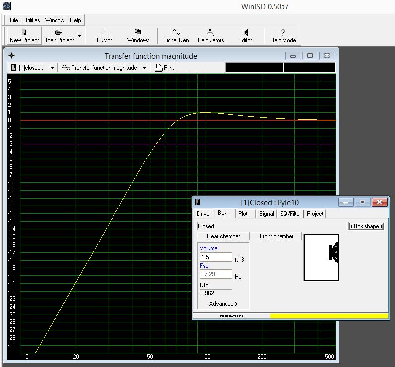

Funny you mention a 10"
I decided to build a box for my mids and highs about 2 hours before I saw this post. I built a 20" tall, 13" deep, 14" wide. I made it big enough so that I'll be able to throw in a 10" mid to replace my current 6.5" mid in the near future.
So what do you think of that idea, if I just drop in that 10" you suggested to replace my 6.5" (I don't want to build a whole new box now to keep the 6.5" and keep the 10")?

Nice! I did a calculation in WinISD for you, attached is the projected response of the 10" Pyle driver in the sealed box you created assuming all enclosure walls are 3/4" thick material. It will work fine, a 1db rise is not a big deal. I will, however, highly advise to use a high pass filter on that driver at 100hz and cross the cubo 15 over at 100hz as well. You don't want to have that 10" muddying up the sound of your cubo 15.
As far as how high it can go; The 10" should play fine to the tweet with that pre-built crossover you bought. I don't see any real issues there, anyone else have any comments on that?
Note: The box worked out to be 1.53899 cubic feet. In WinISD I rounded to 1.5

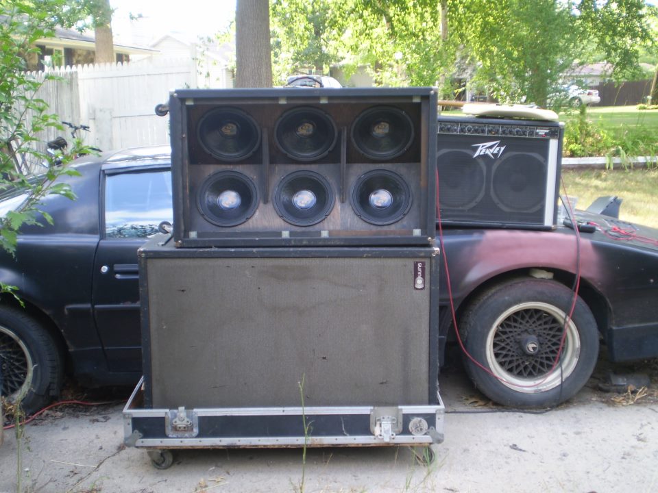

Hi There!!
I have the PPA10's and I had done some measurements on them that you may be interested in seeing.
I case you haven't seen them they can be found here,
http://www.diyaudio.com/forums/pa-systems/205114-cheap-diy-pa-system.html#post2926850
http://www.diyaudio.com/forums/pa-systems/205114-cheap-diy-pa-system.html#post2928128
I think that they would make for some great Bass Mids but that is about it.
They drop of sharply after 1000hz and they sound like it as well as it shows in my FR measurements.
My old Altec lansing 15's have way more upper mid's than the Pyles have to offer.
However for Bass mids they are very powerful and give a lot of punch.
I have 6 of them in a Sunn 610 cabinet and I have not yet tried them with an amp bigger than 200watts on them yet.
But they do play very loudly and clean using just my guitar (85' Strat) set on clean mode.
My only gripe about them as mentioned is the lack of the high mids above 1-2khz.
I mainly plan on using them with my bass guitar anyhow.
The THD of these drivers is approximately -35db to -40db throughout their passband as shown using HOLMimpulse or 1.77% THD to 1% THD.
Not quite Hi-Fi Quality but will knock your socks off with enough power!!
