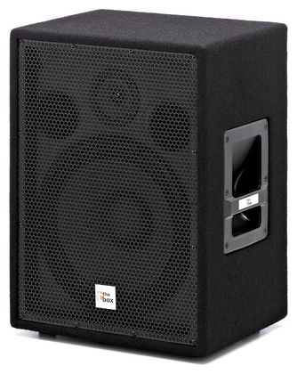

that money could almost buy you this speaker
its a 12" woofer with 3" 'tweeter cone'
I think it looks quite clever

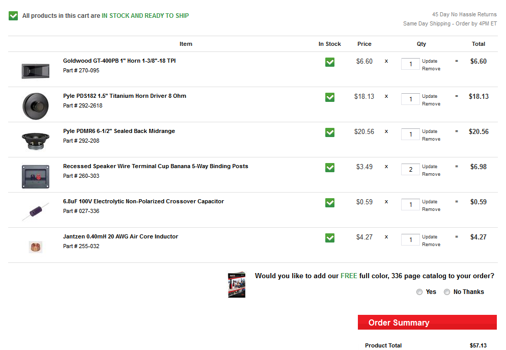

Also, I need to know what box I'm building so I can order this stuff already.
The picture attached to this post is currently what I'm thinking of buying.
I decided to go with those pyle mids for a few reasons, same frequency response as the daytons you suggested, good reviews, same sensitivity, $10 cheaper. The cap and coil is for a 3000hz crossover on the mid and high that I saw on some website.
Let me know what you guys think.
I'd still say you're throwing away money by not trying just your driver with a compression driver on a horn. No woodworking required. All you'd need is some kind of active crossover and a 2-channel amplifier. The active crossover itself (assuming you've a Windows computer) could be done via Foobar2000 with a cheapie USB 5.1 soundcard. That'd cost tuppence (actually about the same as that inductor), and you'd be able to use that to test out any other crossovers you're thinking of trying.
You haven't included anything to cross between the woofer and the midrange, either.
FWIW, a closed-back midrange doesn't need more than a baffle anyway: there's no need for a cabinet as there's no rear-wave to process.
Chris
